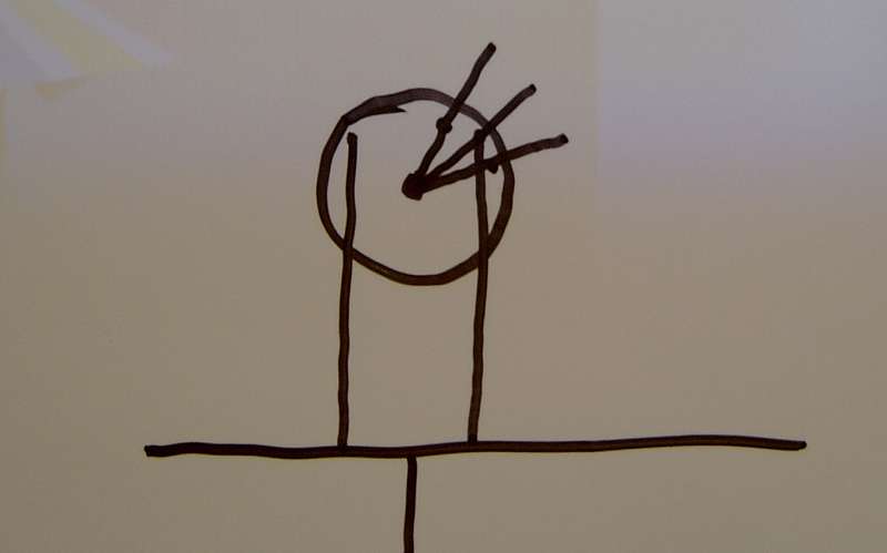

Sounds like adverse yaw, caused by the outside aileron dropping too low creating too much drag. The cure is what they call differential ailerons; set up the ailerons so they go up more than they go down, probably about a 2:1 ratio. When using one aileron servo, use a wheel or six-arm output arm on the servo and move both pushrod attachment points forward so they are no longer straight across from each other...JIM

You said, "When using one aileron servo, use a wheel or six-arm output arm on the servo and move both pushrod attachment points forward so they are no longer straight across from each other...JIM" I'm not sure I completely understand what you mean here. If the attachment points are not the same, would it not then give me different turn characteristics in left vs right turns?

rik756-When the pushrod attach points are both forward, the up aileron will go further up than the down aileron will go down, regardless of which way you are turning. Differential is most often used to advantage on flat bottom wings...JIM
