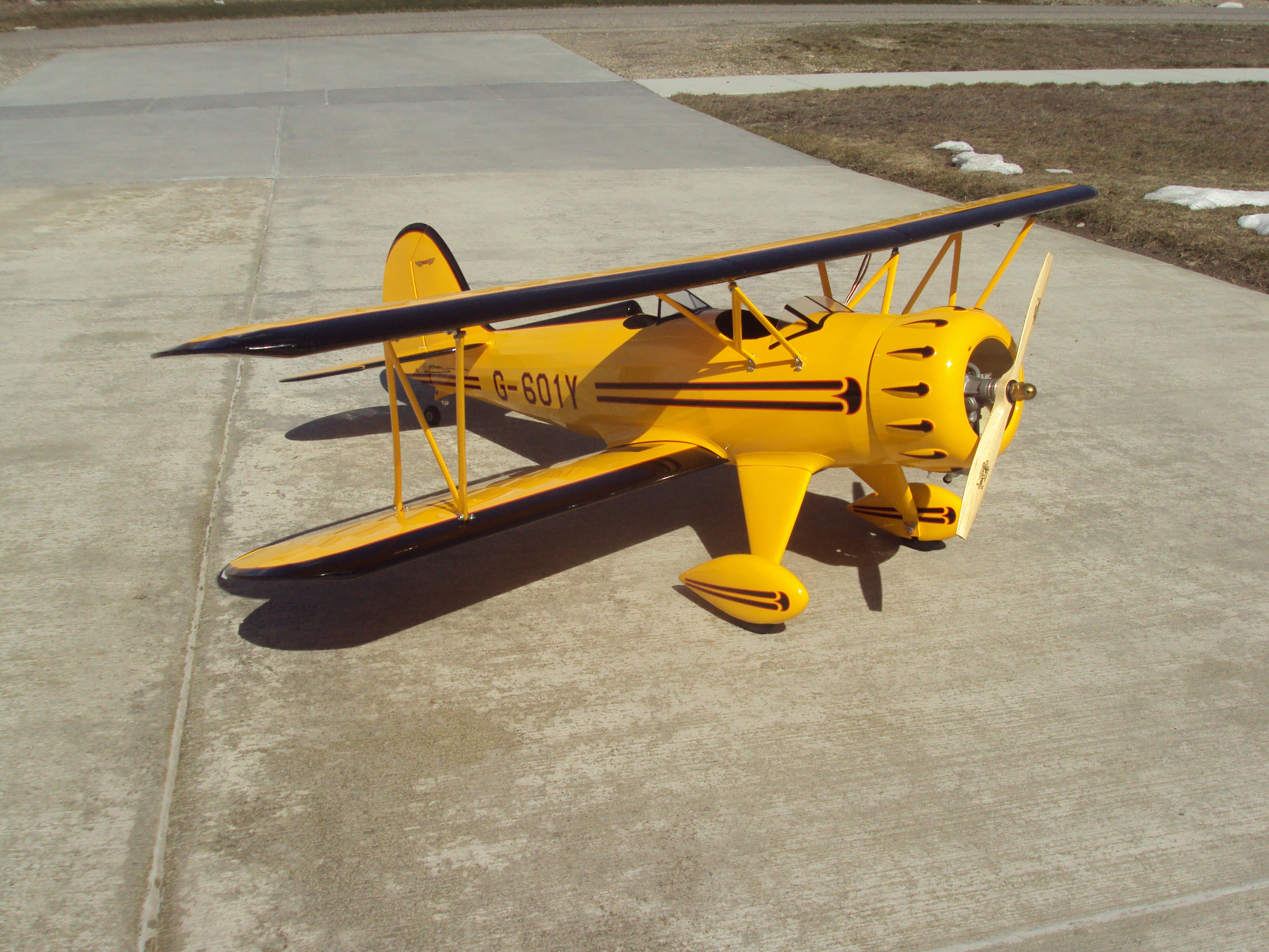

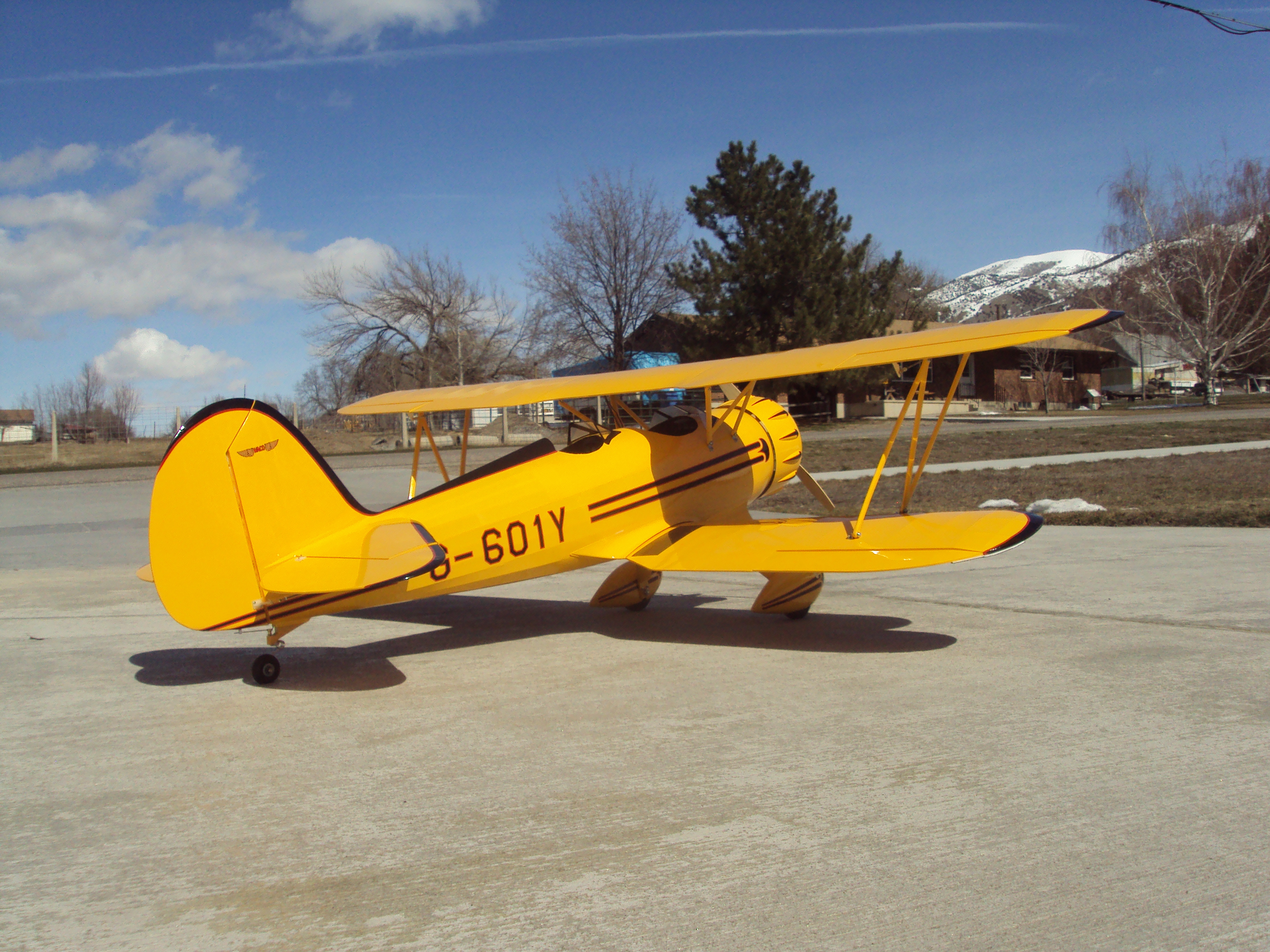

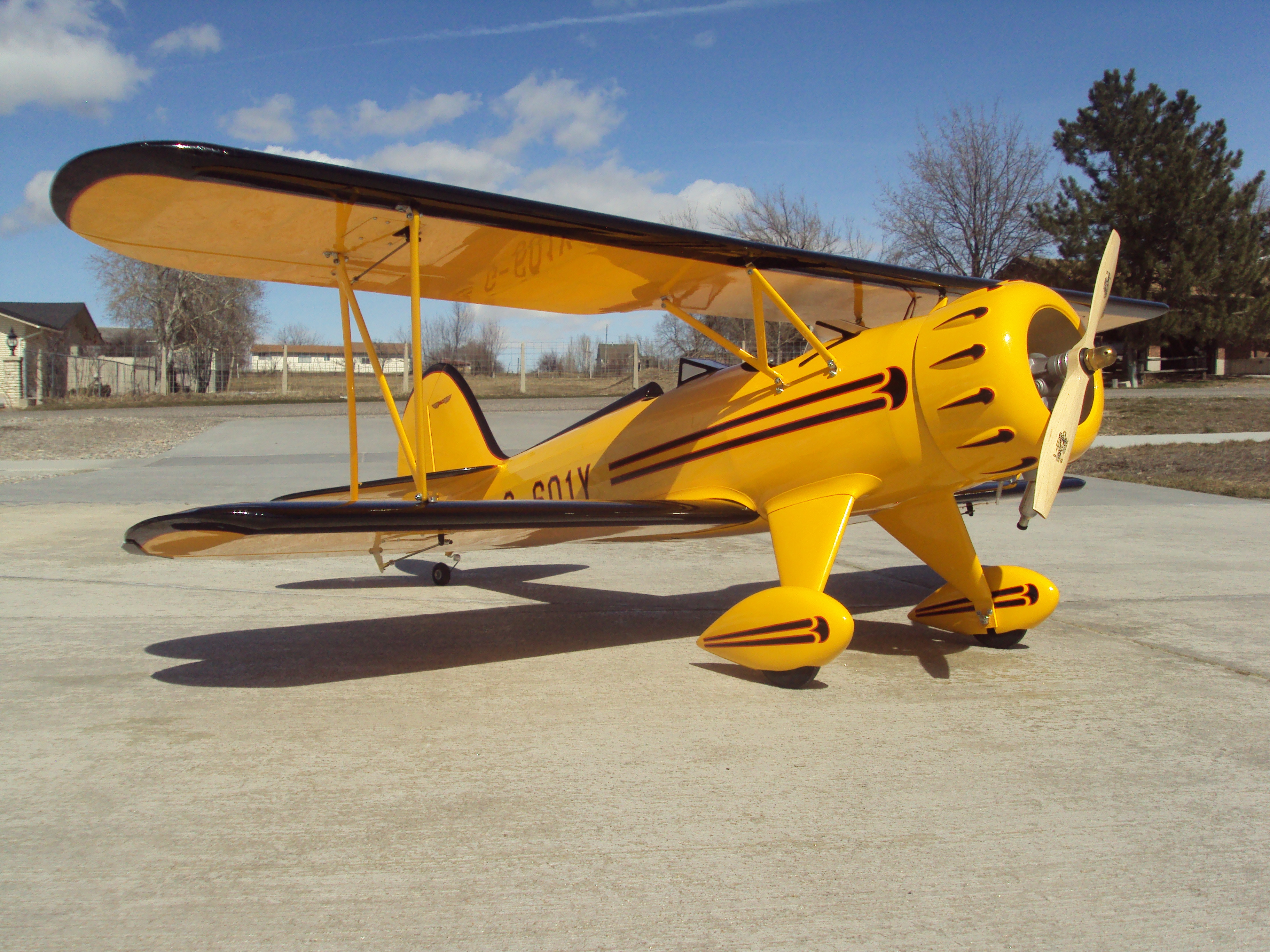

Posts: 1,434
From: millville, UT
Default RE: GP Waco?
OK, Here it is. Having trouble with internet lock. I'll post pics here for now cause my link can go any time. I'll explain below. MM

First, Yes, the dummy engine is out until the first flight, check for any engine or mount problems then I'll install it. Upper cabane screws are a pain to install, just like the GP Super Stearman. There is quite a bit of bend stress pushing wing down to the rear top cabane mounts. With 0 degree incidence on horizontal tail and bottom wing, the meter shows 1 degree neg incidence on top wing. That should get the bottom wing flying before the top wing. Your comments on this please. Use 24" or better 30" extension for left top wing. 12 inch barely makes it to the access slot. Last, just no way to hide the top wing servo wires going down into the fuse. Comments on that one too please. Just too difficult to make a scale tail wheel that would work. What do you guys think of my alternate install Gotta go, MM

Wife says out of all 40 active planes, this is her favorite. Guess the Stinson 108-2 and 108-3 are now going to the "back-seat". Full weight is 13.3 pounds using the OS 1.20. Not sure what size tank is provided, wonder if its about a 24 oz'er. Plenty of flying time with it though. Well, what do you guys think ? Whos putting slave rods on for the upper wing ailerons ? Oh, for the fellow that asked about the hook-up for the aileron servos, I chose to use individual RX plugs, AIL and AUX 1. It eliminates one extra "Y" connect. MM
