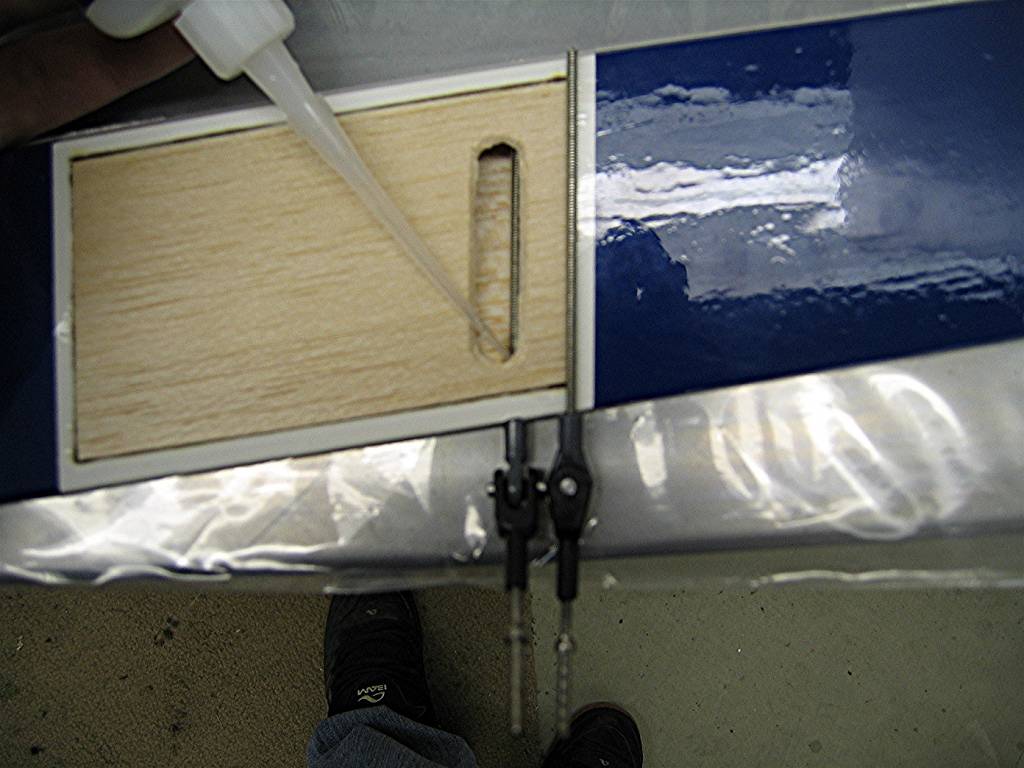

When you are setting up the slave rods, you want the top slave rod to be right at the trailing edge. You want the bottom about 1/4" from the trailing edge

ORIGINAL: skillet92
stick I guess I don't understand, but would you not want the same distance so they would move the same.
The geometry is just far enough out of kilter to make the top aileron move further than the bottom aileron, given the exact same placement. The Stagger is what causes this. The top wing is ahead of the bottom which gives you positive stagger. It messes with the throw enough to require a little offset in the connection. Here is a photo of Dan's Waco which shows the angle. Like I said, the upper goes at the trailing edge, and the lower goes 1/4 inch from the trailing edge. Trust me on this, or set them up equally, and then go back and do it like I said. You will see what I mean if you do it equally. Then you will have an extra hole in your aileron to explain to those who ask.

skillet92,
It partially has to do with the upper wing being offset forward (positive stagger) in relation to the lower wing and the fore - aft taper in the ailerons at the point of attachment. If the wings were at O° stagger and the ailerons were flat plates then you could mount the connecting rod at the same point top and bottom and they would move equally. As you move the stagger foreword the geometry changes enough that the attachment points need to be adjusted to get equal movement of the ailerons. The pictures show the points and brackets used by Waco. For the model, get a couple of toggle bolts of the correct size, take them apart and you have the brackets ready to mount.

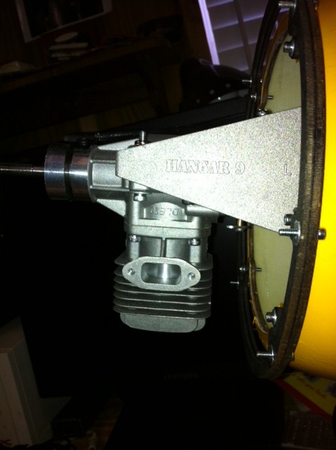

My Feedback: (36)
Good Job Joe with the 26 on the GP Waco!!!!! I'll bet that will work good....
I'm using the DLE 20 on mine. I just ordered a Jtek muffler for it. Kevin @ Jtek makes a special muffler for the AeroWorks Cessna 195 for a DLE 30 engine. He said he could do that muffler for me to fit the DLE 20. I ordered it while ago.
The pipes exit straight down for the look I wanted. The muffler is 3/4 in thick @ the back side. I have 1 1/8 in between the rear of engine and the fiberglass firewall surrounding. The muffler is a little pricey but I'll just have to do without food for a few days. I could stand to lose a few #'s anyway.
Here are a couple of pic's to explain.
