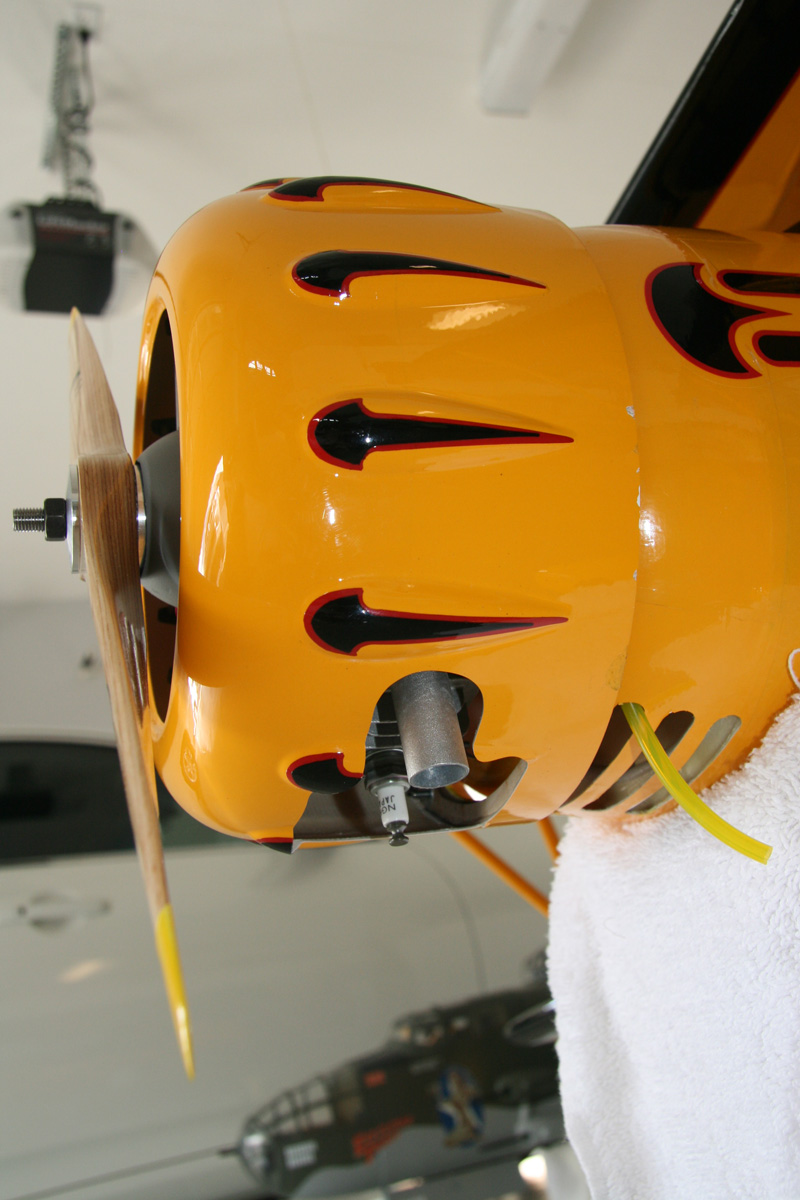

On page 18 look at post 437 and 438. I put a dle 30 in mine and a jtech muffler and did not have to cut the cowl to bad.

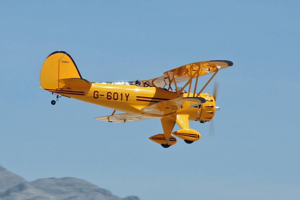

The DLE 20 has great power for this plane. I highly recommend it. Fly's mine really well at half throttle. Big loops are no problem. Flying elevation is 2200 feet.

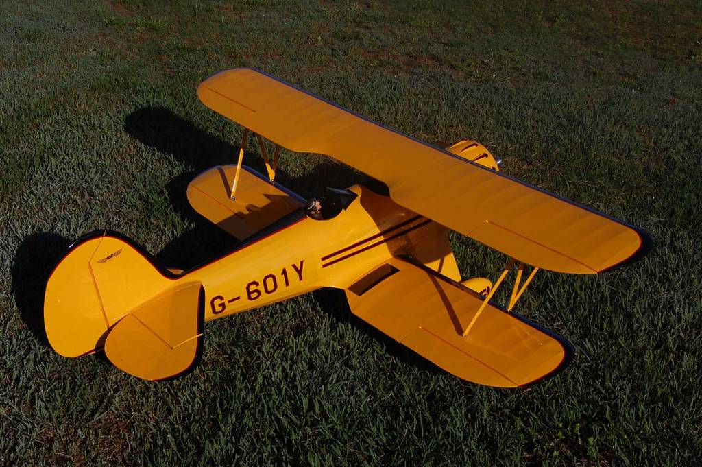

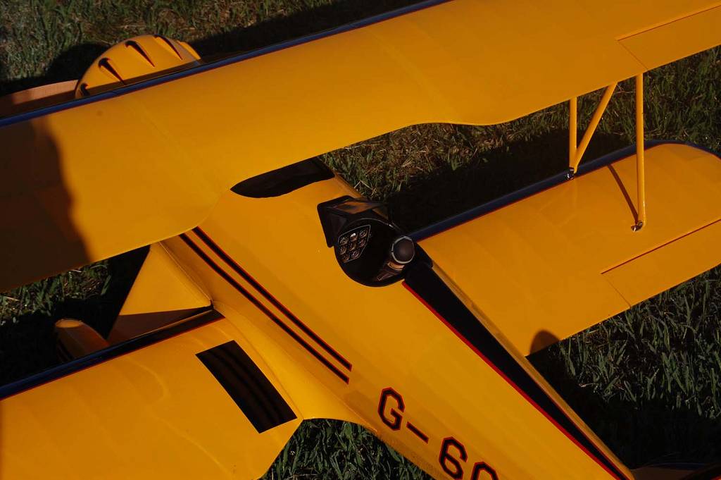

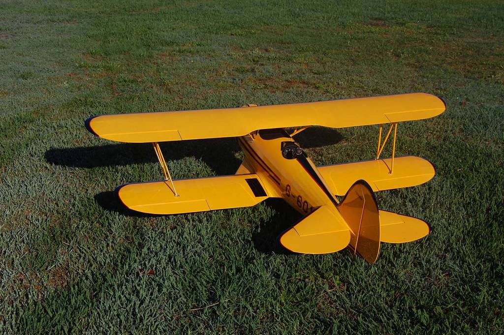

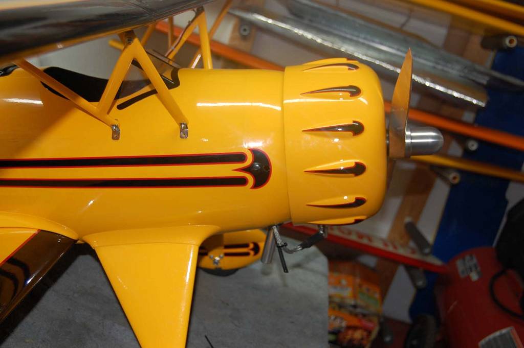

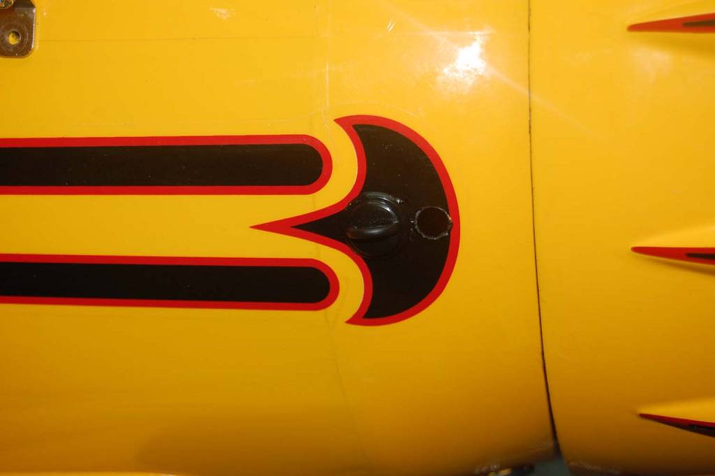

Well, if the weather holds I plan on doing the maiden on Sat am. Forcast looks good. Mine balanced right on the spot and came in 12.75 lbs. I've added a few exra touches in the final finishing. Had some extra "Cub Yellow" & Black covering sitting around so I coverd the upper wing joints. They were very tight to begin with but I thought it really made it look like single wing. Also placed my fuel dot and access hole for adjusting the carb on the right side of the fuse in the black scallop. Hard to spot unless you're up close. Also added some cockpit coaming to the aft cockpit. Will do the same for the forward cockpit later. I just want to get this sweety in the air.

Xoar 17x6. Turns about 8200 RPM.

Is it just me or is anyone else having a tough time setting up the waco with a dle30 rear mount carb and throttle servo

ORIGINAL: gt-fo-fa-sho
Check post # 388 All problems solved

i tried a similar set up except i mount to the servo right in front of the reciever plate sideways...i may try that servo arm thing though. mine came with a composite throttle arm extender rather that the metal one that i though it woulda had. All the dle 30 i saw are rear carbs. Do i need to run a tube from the pin hole on the carb diaphram cover to the fuse for pressure equalization in flight
Old 04-30-2011 | 10:03 AM
  #571
Joined: Feb 2006
Posts: 1,133
From: camden, SC
Default RE: GP Waco?
GT no you should not need to run a pipe out. You should be able to tune any issues out of it. I did on mine.

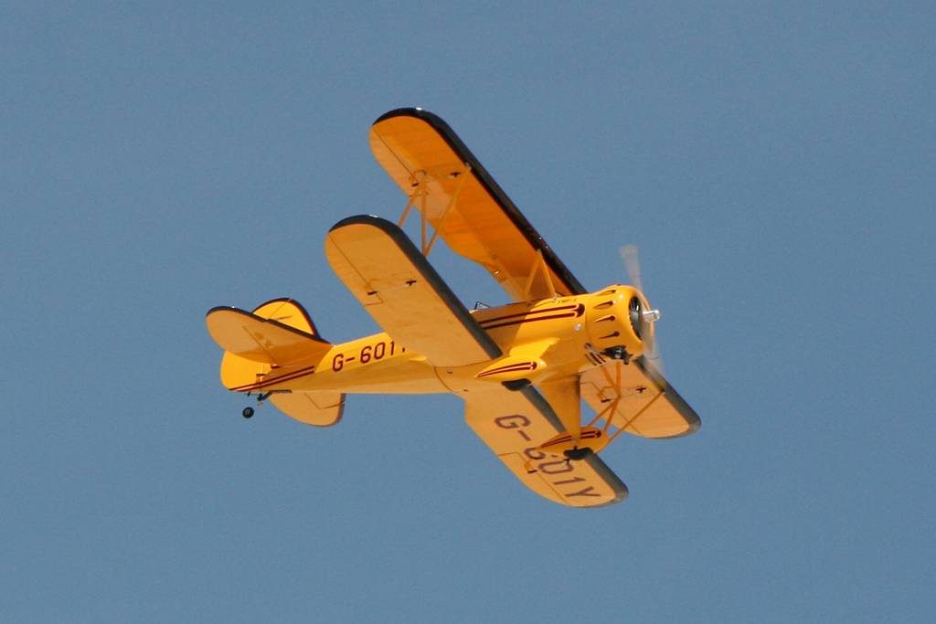

Well, I maidened mine today.............Weather was perfect....5 mph down the runway, 72 degrees and a perfectly clear sky. WOW what a bipe. Rolled power on slowley to about 3/4 throttle and she lifted off nice and gently. Added about 3 clicks up elevator and that was all it took to fly hands free. Flying with the DL-30 at half throttle most of the time and it still did any aerobatic manouver I could throw at it. Got 6 10-15 min flights today. By meas. the fuel consumption I figure I can easly get in 20 min flights with some reserve left. It also drew a lot of attention at our field. This is now my favorite bipe. Mike (ACF)
AND da wings not be fallen off.!!!
