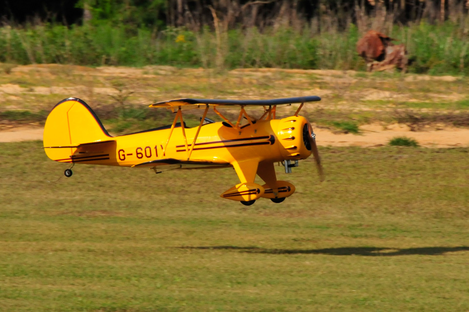

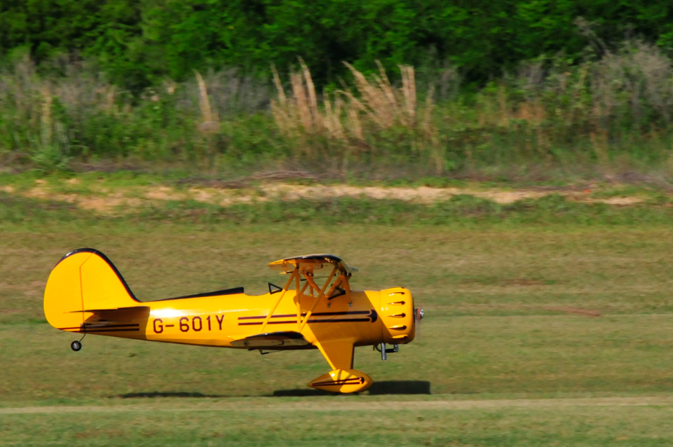

I did the maiden this morning... It went great. I love this airplane!!! The DLE 20 is awesome. It will fly the Waco scale at 1/3 throttle and at full throttle will climb almost vertical to where ever you want to go.... No need for any bigger engine on this 14 1/2 # plane... It balanced right on the 5 1/4 # back mark upper wing without fuel.. It lands awesome with wheel landings.
ID:	1639333   Click image for larger version

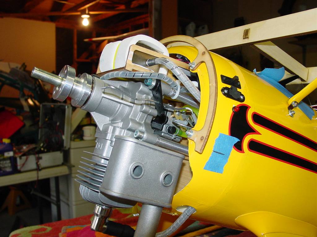

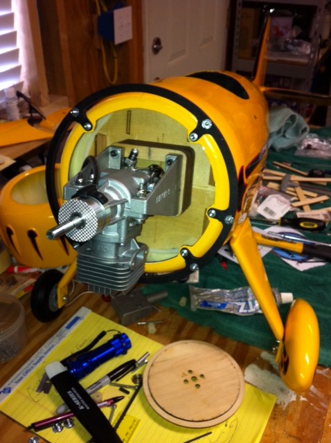

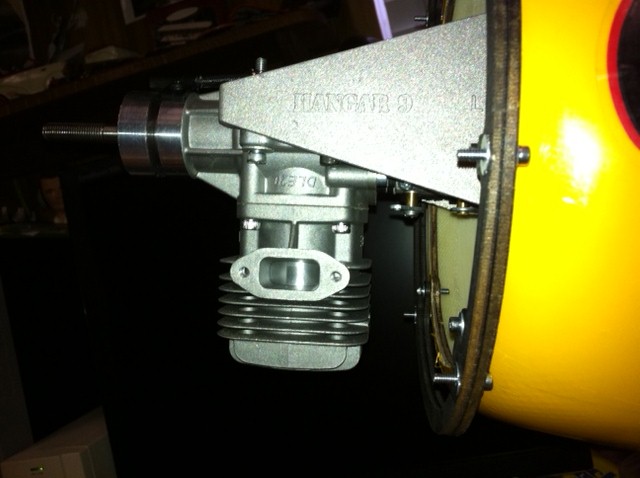

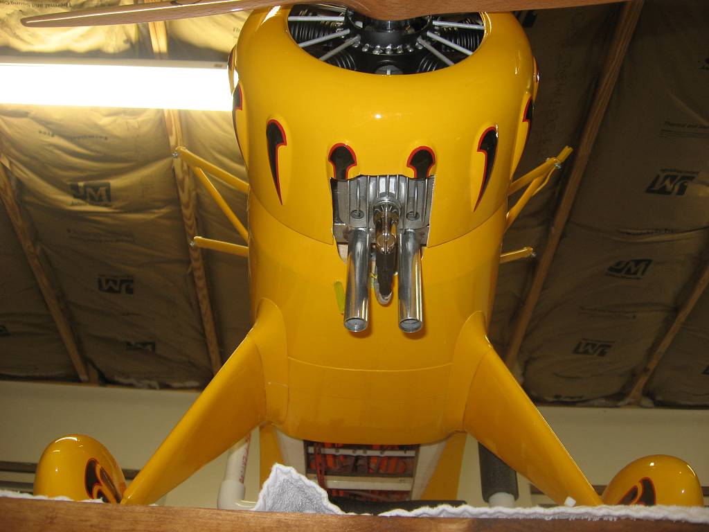

Hill202;
If you can do it, get you a DLE 20 and put it on your Waco. It is a perfect fit if you use a Hanger 9 alluminum mount. I ordered a special muffler from JTEC that cost $119. which was kinda pricey but it is a perfect fit for the Waco. They actually made them for the DLE 30 to fit on Aeroworks Cessna 195. I called him (JTECH) and he made some for the DLE 20. Gasoline is a lot cheaper than glow fuel too. I'm going to like the DLE 20/ Waco combo just fine.
A 120 4 stroke will fly it too though???
ID:	1639623   Click image for larger version
ID:	1639624   Click image for larger version
ID:	1639625   Click image for larger version

Thanks for the pics Cannonball. That wrap around muffler looks good. I guess that saved some cutting on the cowl right?

Hill202,
Not much cutting at all... I may have to make a couple more exit holes if the engine seems to heat up.... The cowl is open all around for air exit too.

I see you drilled access holes in the fairings for removing the gear also. I'll probably do that also before I glue them.

Yes, don't forget to make those access holes or you cannot get to the screws to take the gear off. I enlarged the center one also. I had to remove the gear because I forgot to epoxie on to the gear the center plate and it would not go in place without taking the gear loose and sliding it in under the farings. That is when I decided to do the access holes so I could get it off.......da.....

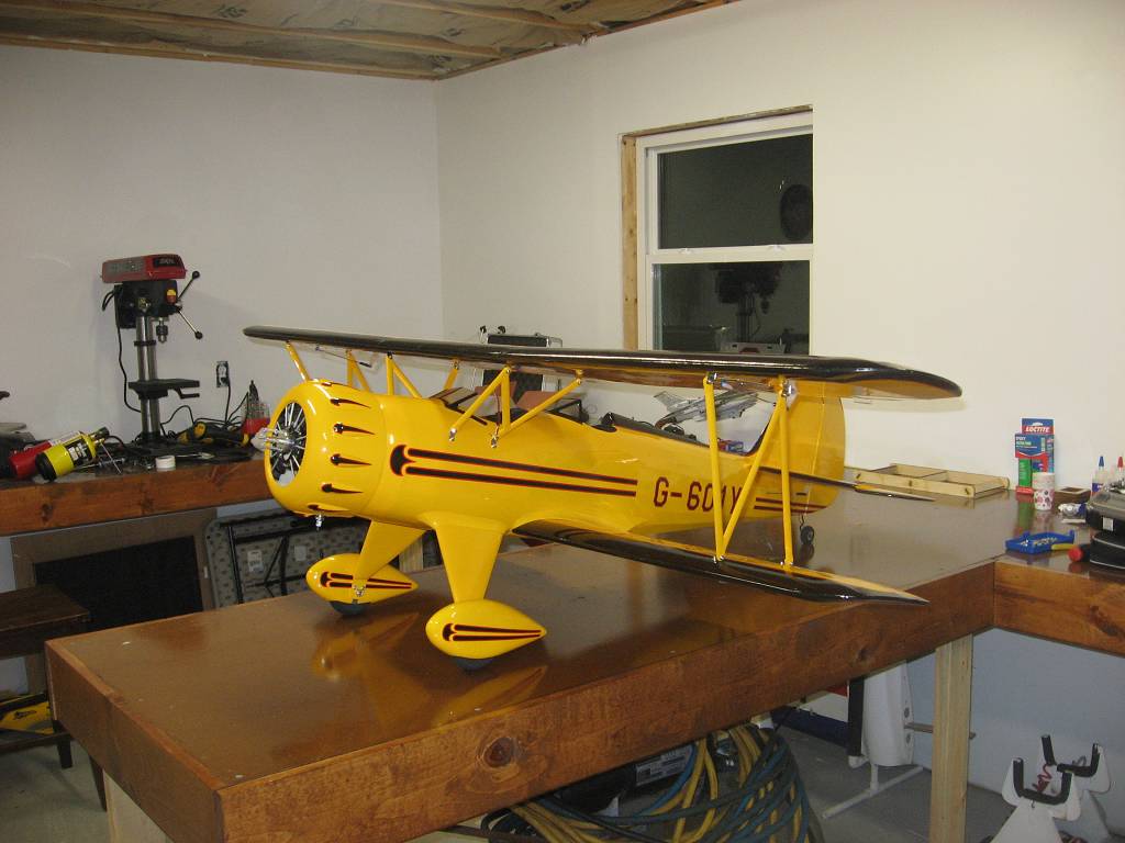

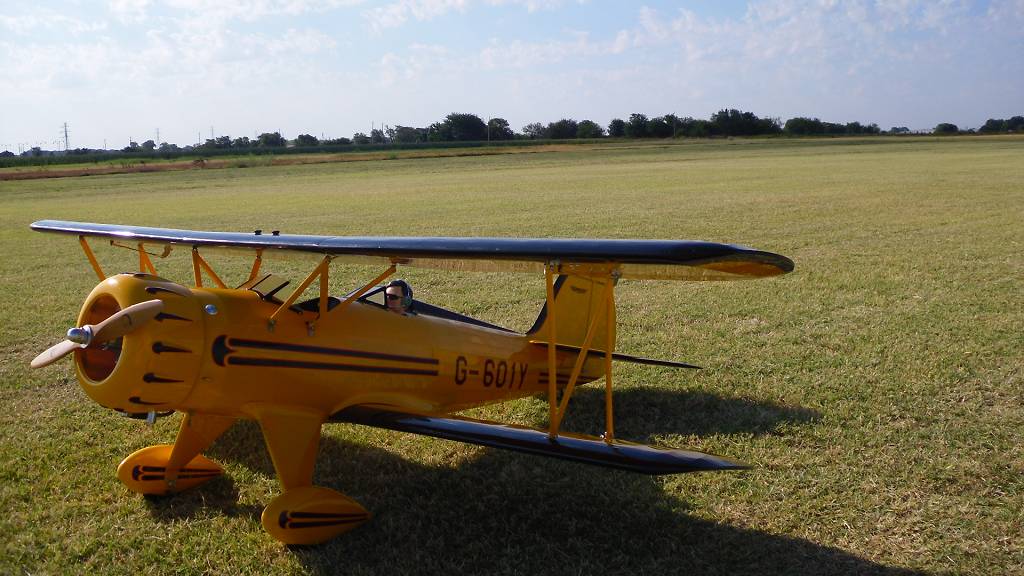

Well I used the 30 and have no regrets! That is why they gave us a left stick. I have really enjoyed mine and love the looks of it in the air! Mine came in at 14 and a half pounds and balanced perfect. The landings are a none event and other than the fact that it does not seem to like wind to much it has been a joy to fly. I am turning a 19x7 xoar at the moment but have a 20x6 waiting on the engine to finish breaking in.
And PS I have since added cockpit combing and a pilot to finish her off. I am also thinking of putting some combing around where I cut out for the engine.
ID:	1639776   Click image for larger version
ID:	1639777   Click image for larger version
ID:	1639778   Click image for larger version
