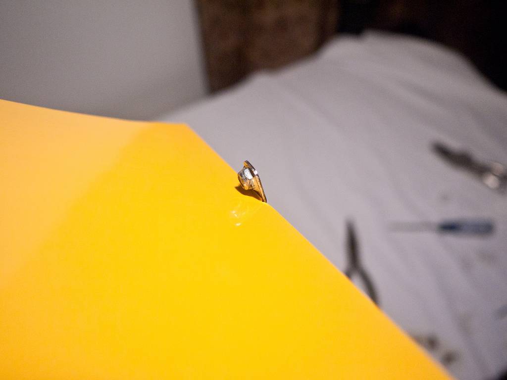

The tip for soldering the nuts to the angle tabs was a good one. I was able to solder locknuts and not melt the nylon insert. Like somebody said, it is much easier to do before you glue the wings together.

I agree, soldering the nut on was a great idea. One more tip, you need to have a good hot iron to do this. If the iron is too small it will heat slow or not at all and that is what distroys the nylon insert. I have a Weller WES51 Analog Soldering Station and set it to 3/4 power to do the job and it worked great.

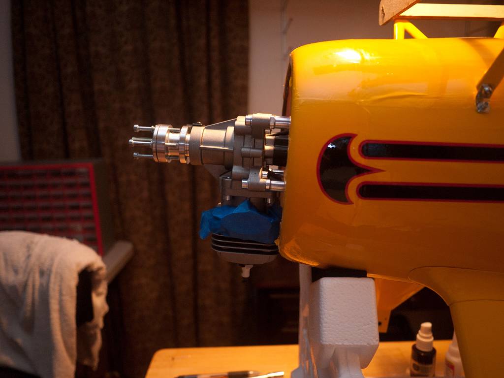

With the DLE 30 mounted as per the manual, I've noticed that there is some slight up-thrust. Has anyone else noticed this? I searched the thread and can not find a pic at the right angle to see it.
Old 08-06-2011 | 10:54 AM
  #837
mmn
Joined: Apr 2009
Posts: 146
From: Fort Lauderdale, FL
Default RE: GP Waco?
ORIGINAL: Hill202
There is and it's been mentioned in this forum (by me...). Since no one else was seeing a problem, I decided to fly it before trying to do anything about it. Flies fine. Didn't do anything.
Regards
Michael
