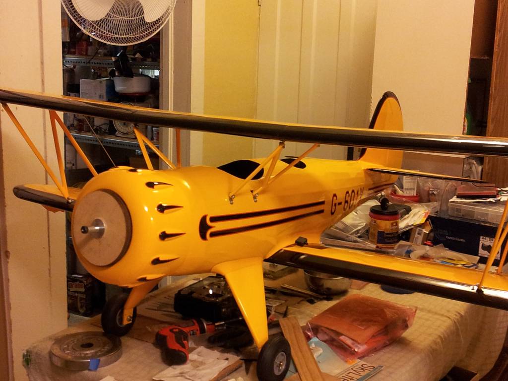

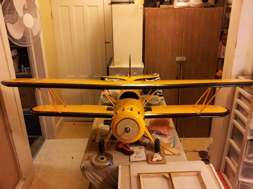

Well so far I am about 70% complete. No big hurry to finish since there is snow on the ground and a little bit to cold to fly.
ID:	1842015   Click image for larger version
