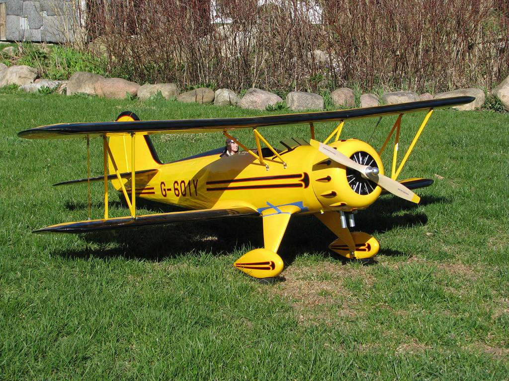

My Waco with the DLE 20 installed. I agree the Saito 4 strokes sound awesome, but I just love flying my Waco with the DLE 20 in it. It has plenty of power and fits perfectly in the cowl and uses gas instead of the $20 gallon glo fuel. It sounds plenty good to me. I don't think it sounds like a weed eater at all. I fly it at 1/2 throttle or less and sounds good.
I still have a Saito 180 in my Skylane 182 and Saito 125 in my Funtana 100.

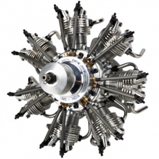

7 Cyl 35cc Glow Radial Engine $1199. Now that would be awesome! One of you guys that have plenty of cash need to buy this senior citizen one of those. I can email you my address if needed.
Eddie of OKC
•Cylinder head and crank cases produced from aircraft grade alloys
•Heavy duty double bearing crankshaft
•Billet aluminum pistons and hardened steel rings
•Hard chromed and lapped cylinder bores
•Hardened steel cams
•Carburetor jet valve incorporating of latest design with a split opening for smooth acceleration
•Zero percent or low nitro (5-10%) fuel with low oil content (5-7% oil/fuel ratio)
A stunning engine with solid performance and reliability – the 7 Cylinder 35cc 4-stroke glow radial engine is designed for larger models, specifically scale applications where the use of a radial engine in a round cowl will provide the ultimate scale look for the modeler’s plane. While providing great looks and sound, it also delivers the dependability and performance of Evolution.
Displacement Weight Bore/Stroke Muffler Recommended Propeller Sizes
34.9cc (2.1 cu. in.) 3.1 lbs., (1.4kg) 18mm/20mm Yes 16 x 8, 17 x 8, 18 x 6, 18 x 8
Crankshaft RPM Range Mounting Type Fuel
8 x 1mm 1300-6500 7.3 in dia.
6.0 in.length Ringed 0% nitro, 9% oil for break-in, 7% oil for normal
Eddie of OKC

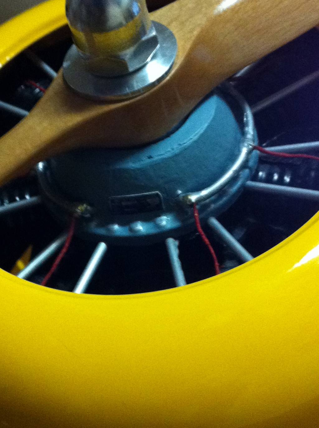

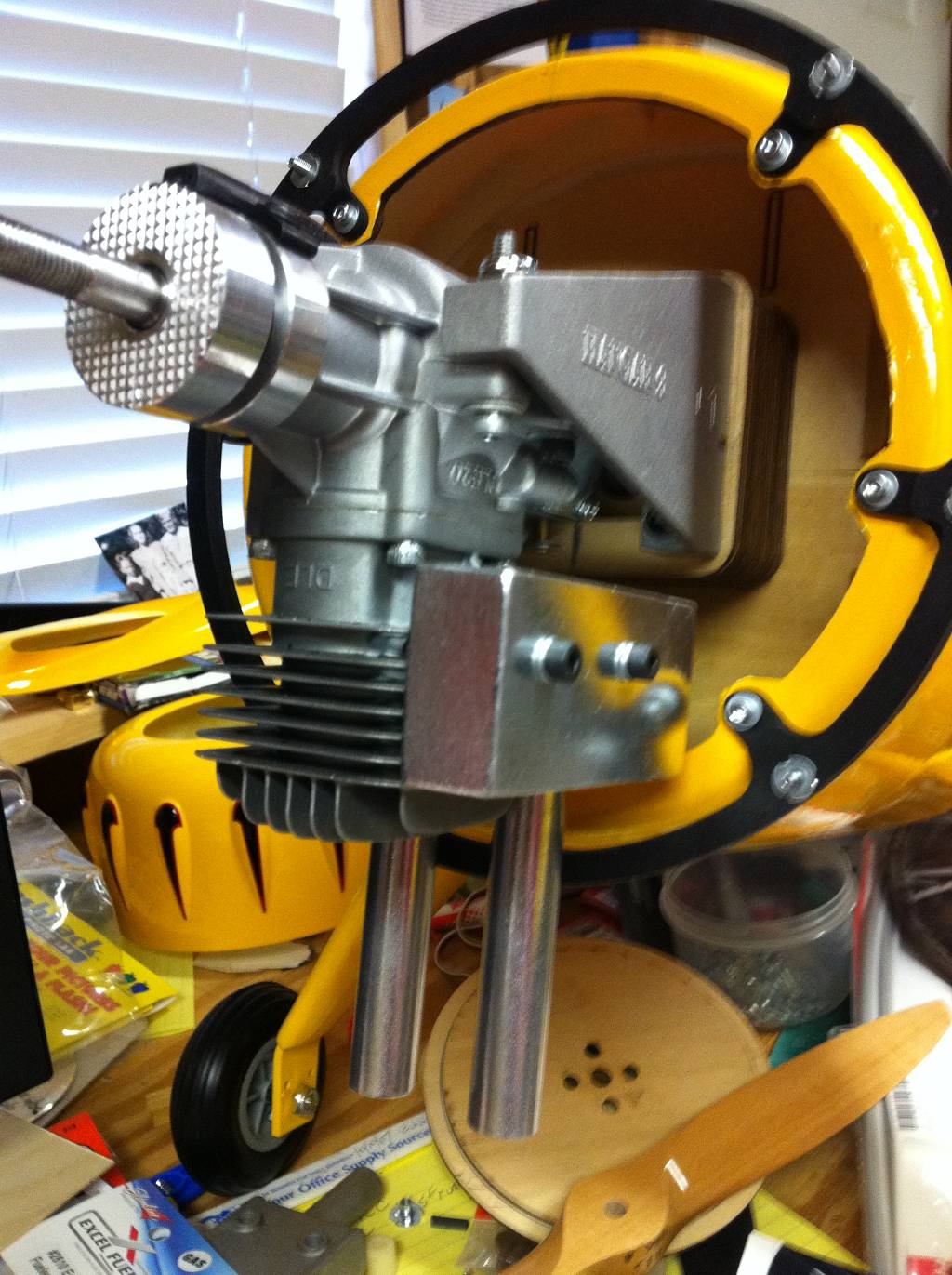

Just a few more minor details and she'll be ready for maiden flite after an engine break in period of course. As you can see in the pics the blue tape shows what one of the issues are.
