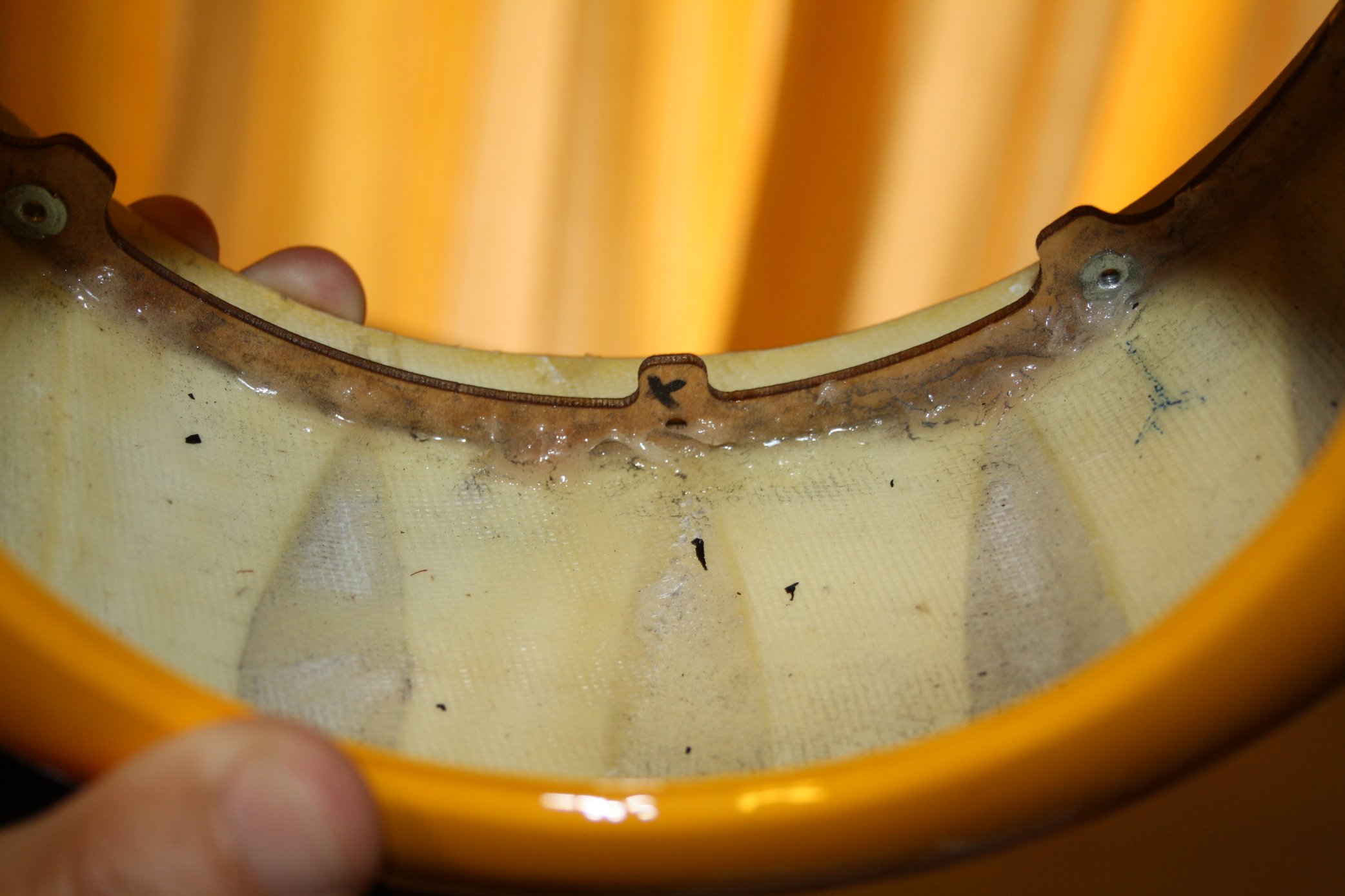

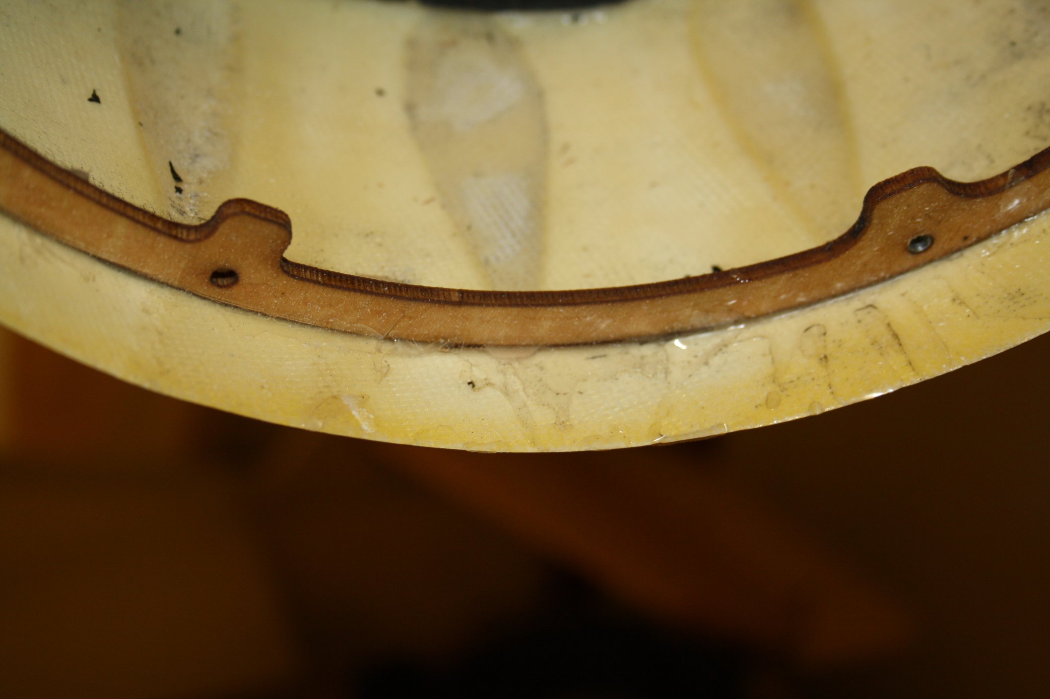

Second attempt at putting the cowl on I used milled fiberglass with 30 min epoxy. Cowl came right off of the ring. Sanded, cleaned and still no good. Any suggestion?? Thanks for any help!
Gene
Old 01-28-2014 | 03:45 PM
  #1222
Joined: Jun 2008
Posts: 1,362
Received 17 Likes on 17 Posts
From: Perth WA, AUSTRALIA
chopper man - I must admit that I cannot see why you have these issues.
I had to glue two of these cowls (I changed engine and needed different cut-out) without issue following the instructions.
I just remembered that I didn't used "milled" fibreglass (as I didn't have any at the time), but instead I chopped light fibreglass cloth to small pieces and had them mixed with the Epoxy.
The photo show my first cowl two sides of the "ring". The side that had the bag is clean from glue, and the other side is "lumpy" with the epoxy mixed with cloth.
Eran

I finally got it. Think I just wasn't using enough epoxy. Used a lot more and it finally worked out. Thanks or the reply and pictures. Hope to maiden it this weekend.
