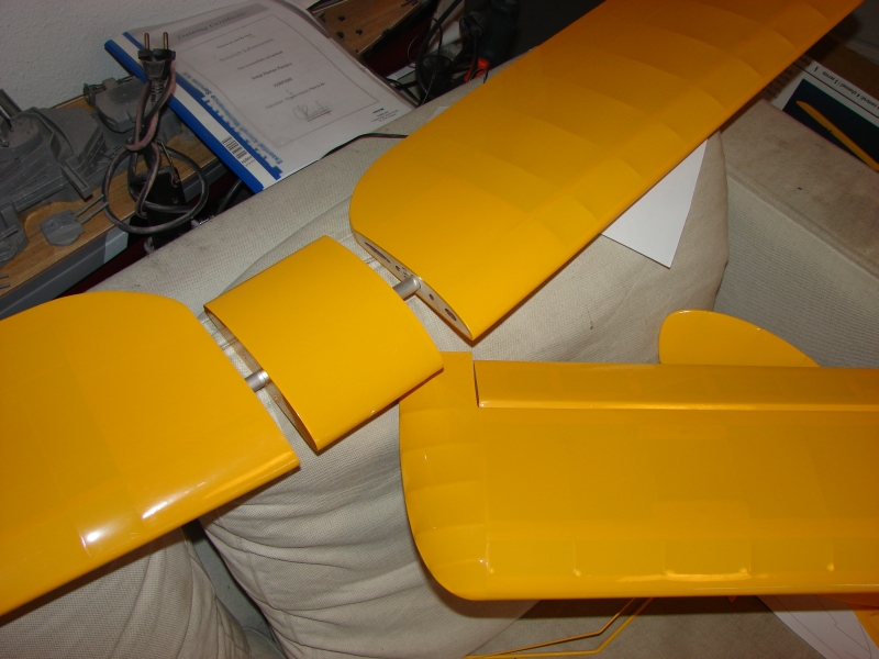

Hi
Anyone out there with theis nice "little" Tiger moth ?
It looks like Phoenix has revised the kit, and have now made a removable hatch for easy acces of the electric version.
But it also makes it easier to install the tank and servos in the glow version.
Wings are removable, and have alu wing spars, and are held on with plastic screws.
The hardware pack is very nice and complete, and the instructions are better than the usual chinese manuals.
All of the control surfaces expet the rudder have nice traditional hinges installed, and pinned.
The rudder uses CA hinges, and you have to install the tail wheel before glueing it together
I bught this model because I have a saito 72 without a job.
It will fly great with throttle management.

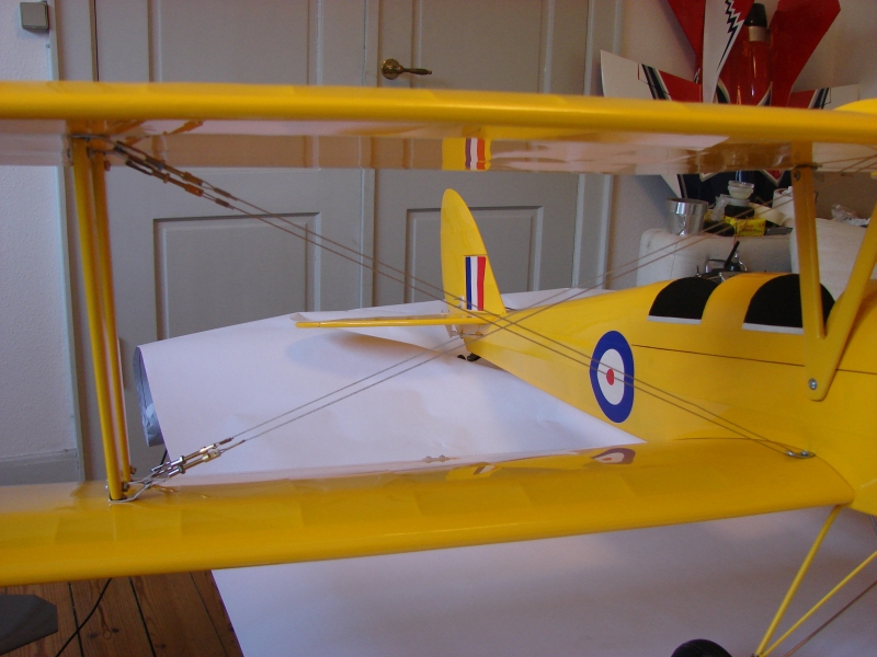

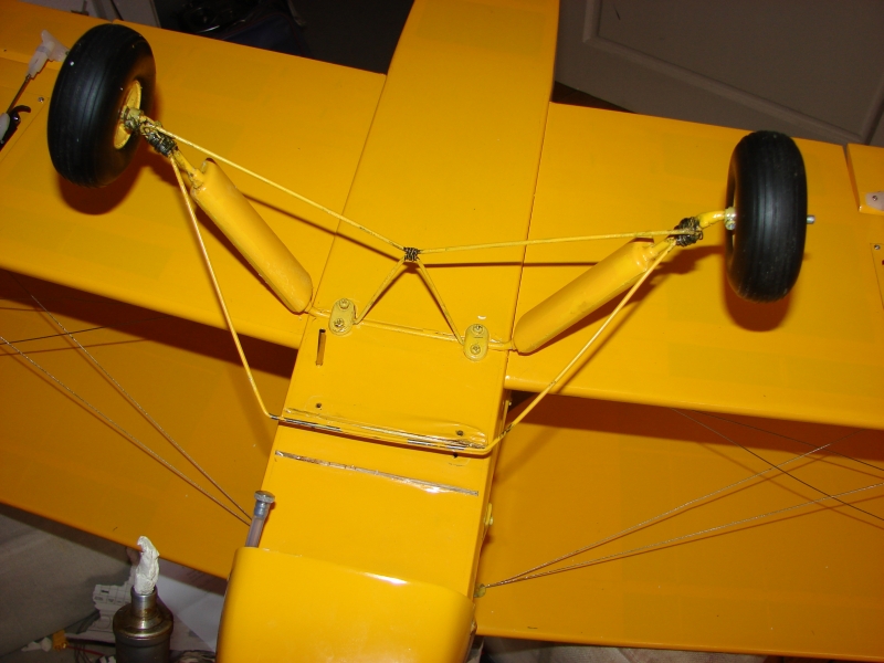

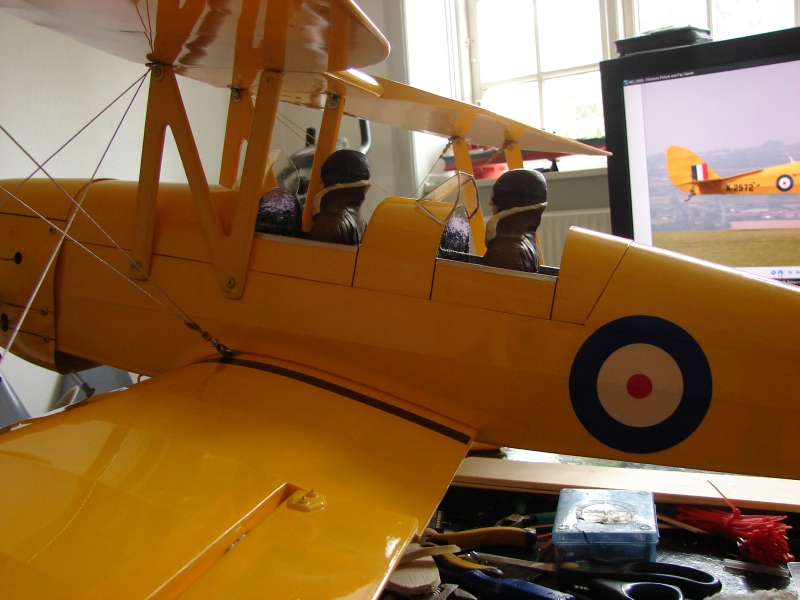

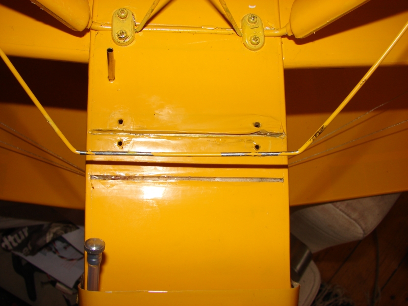

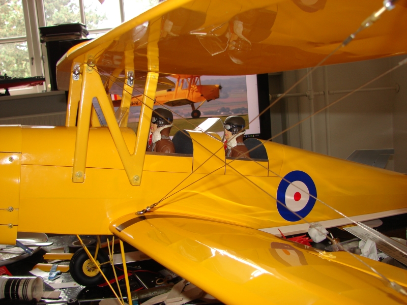

Got a little more done.
Im painting the black cabane struts to yellow, but its not an easy job. My rattle can spray pait has reacted with the original paint, so it will require some work....
The Saito fits well under the cowl.
I think the pilots sit too low in the cockpits, so I will remove them, and shim them up, so the sit taller....and paint them another color.
I bent the landing gear to a little more scale position, and i plan to add more braces as the real tiger moth has.

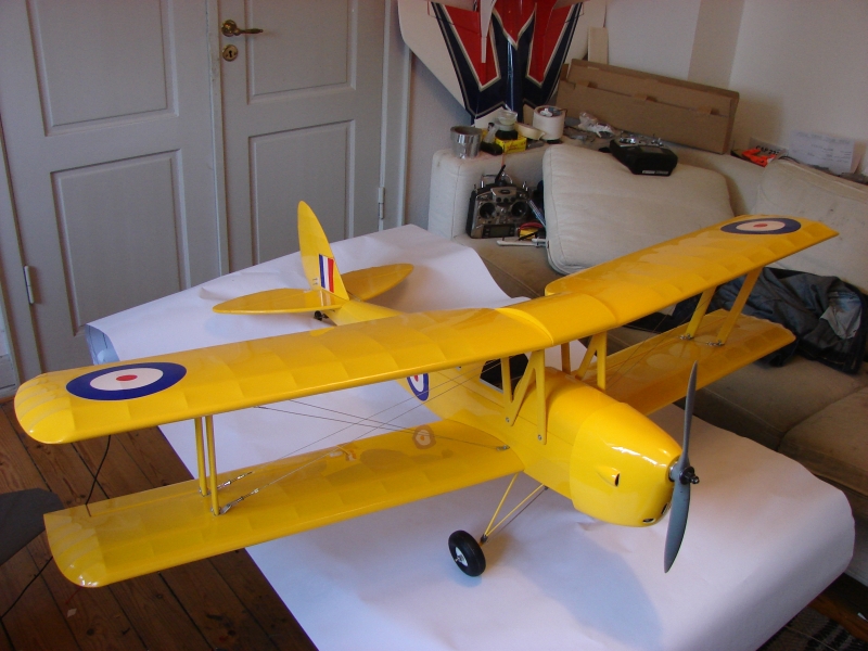

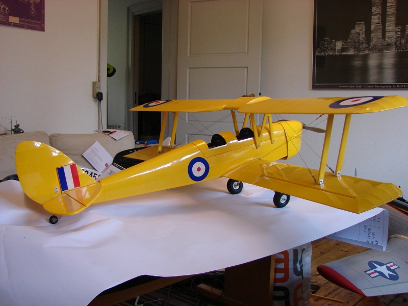

pictures taken at night, dont do it justice...it looks quite nice in real life
Installed some 75mm wheels, looks a little better than the ugly ones included.
All the servos installed, and pushrods connected.
Time for decals, and a few details to make it more scale

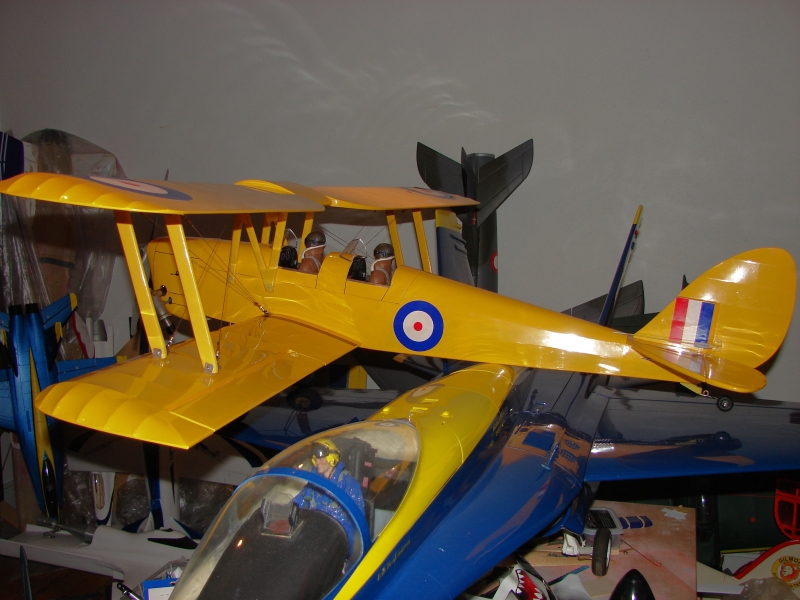

Default RE: Phoenix Tiger Moth .40

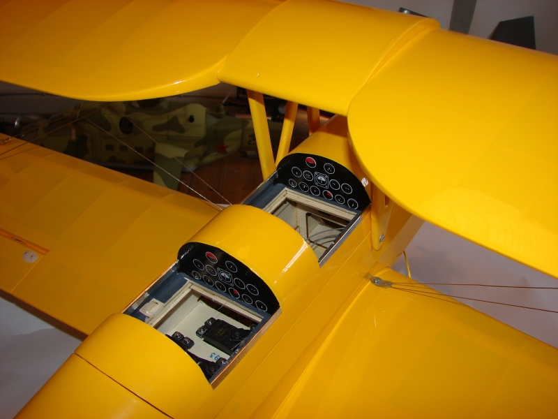

Hope to test fly it tomorrow if the weather behaves.
Here are some daylight pic of it.
Got the cabane support wires on, stickers applied, and made some extra scale bracing on the landing gear. Im going to make som covers for the wires on the lainding gear, so it looks more scale.
Cut the pilots out of the cockpit, to make minor mods there.
Still quite a few thing to do....

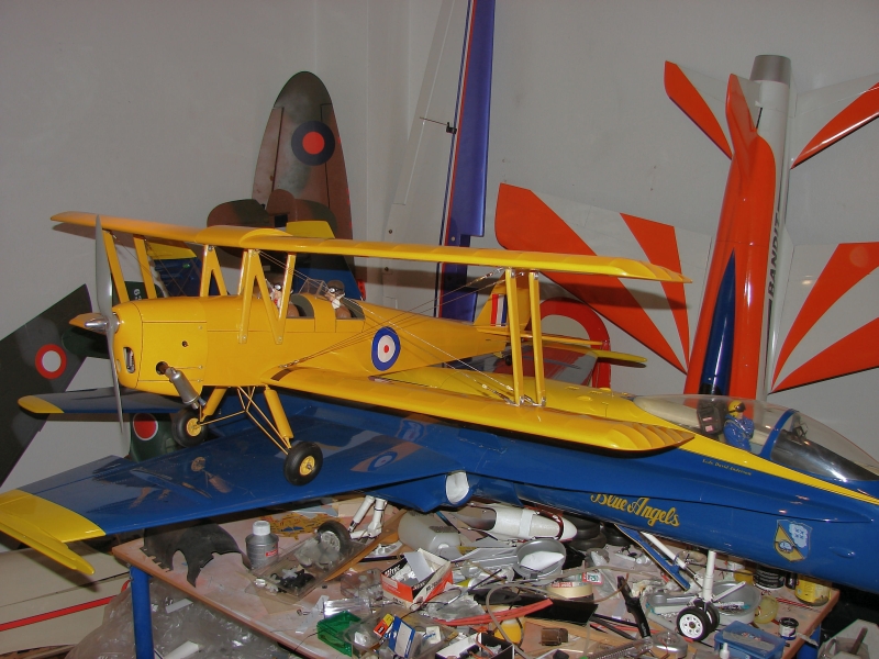

What are the other planes you got in that room?
Old 09-10-2011 | 01:58 PM
SJN
Posts: 6,326
Received 7 Likes on 7 Posts
From: Copenhagen, DENMARK
heh....a Jetlegend F-16, Cmpro P-51 Mustang, and a MI-24 Hind.
Repaing my damaged F-16
Installed a new engine in he mustang, and changing the paint job.
Installing a raptor 50 in the Hind fuselage

Old 09-12-2011 | 03:37 AM
SJN
Posts: 6,326
The 45mm CG is just at the LE of the aft cabane, with an empty fuel tank.
Im probably a little nose heavy at the moment.
Installing the 2 pilots will move CG slightly aft, and ill se how it flys there.
Just gave them a little makeover.
I added 7mm under them, as they sit too low in the cockpit, as you can see in the last 2 pics of the stock moth.
You can also see it is the old version which does not have the remoavable upper hatch on the fuselage as I have.
I also trimmed the windows down in size.

Old 09-25-2011 | 07:27 AM
SJN
Posts: 6,326
Awesome plane, realy happy with it.
I have moved the CG back, and it has improved the flight behavior a lot. When it was nose heavy, its too directional, and wont bring the tail around in turns unless ou give alot of rudder.
Moving the CG aft, makes it fly much smoother, and no need for rudder to make it look nice.
I also moved the front wire of the landing gear further forward......this pulled the wheels further forward, so it does not nose any more.
I glued in a ply plate to support the wire.
I installed a brass tube at the landing gear, and hooked it yp to the oil vent line from the saito.
There is a massive flow of oil out of this vent line, and moving it away from the plane realy keeps the plane clean.
Awesome plane, flys very docile with no bad habbits.
