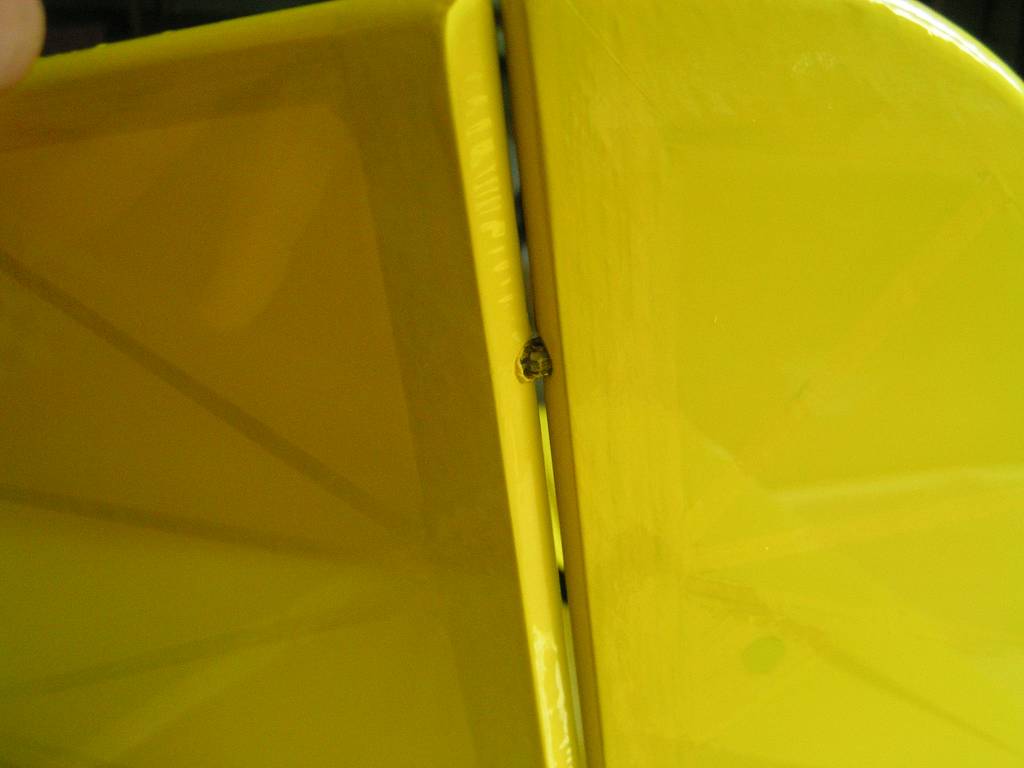

The next problem is the fit of the top wing panels to the center, not to good at all.. The screw goes through the metal strut and into a blind nut that is installed on the wing panel. I will have to rework this or make it a one piece wing, we will see how it goes...

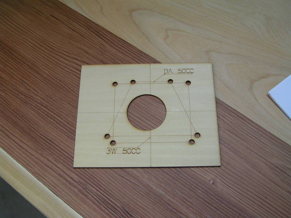

Here you can see I have the motor mounted, the guide that came with the plane was for a DA or a 3W so I just made my own.. Pretty straight forward, but I do think I will get some shorter standoffs (about a 5/8" shorter) to get the motor further back.. I have no idea where they want it as there is no parts on mounting the motor in the manual...
Jimbo

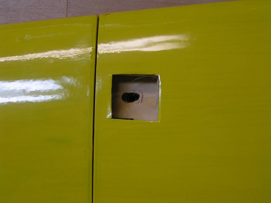

I see the problem on the upper wing and how they meet to the center section...
The blind nut is in the wing as you can see in the pic, and the screw goes through the bracket and center section and into the blind nut.. The problem is that they did a crap job drilling it out, should be an easy fix.. Worst case is I put a piece of CF over the key slot and drill a new hole in the right spot...
Jimbo

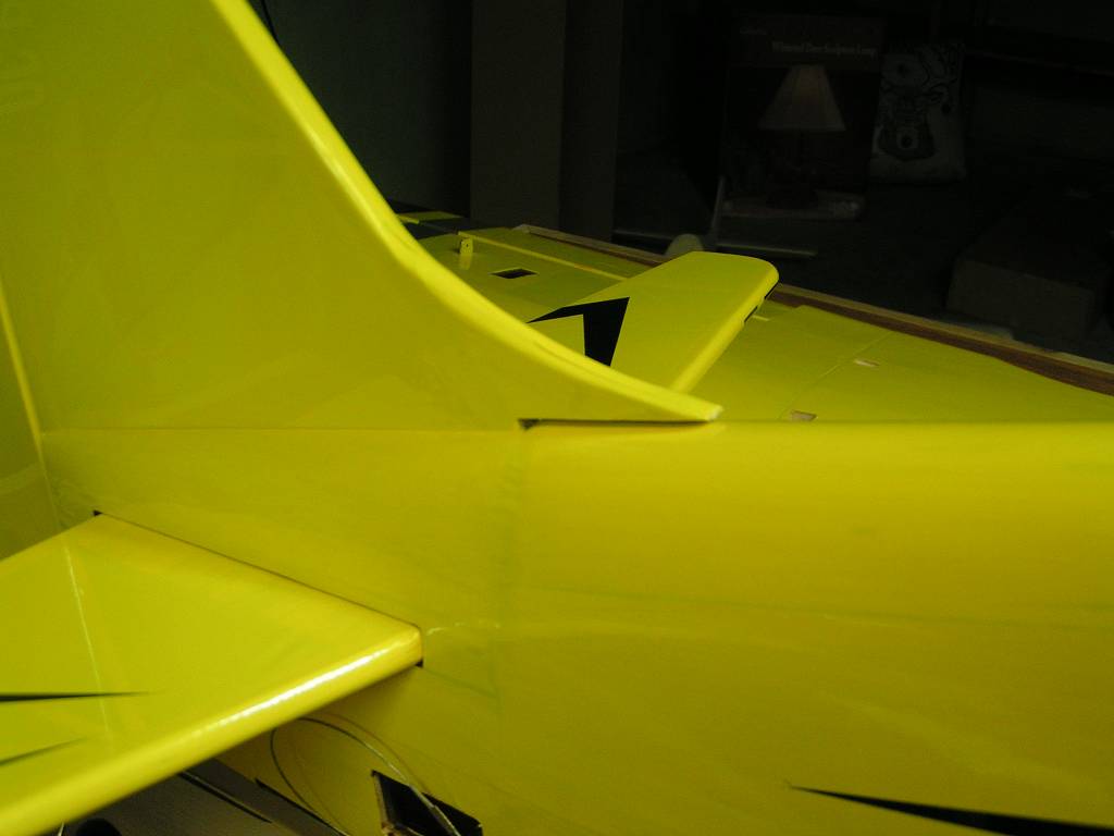

Another QC issue, this is the fit of the rudder to the fuse...I'm really not one to complain about things, but I'm sure you find that hard tobelieve with all the post I put up on thebad things..
<span style="color: #ff0000">Is this normal for GoldWing planes, or did I get a lemon?
</span>
Their site also said the fuse was 80", well I am 70 1/2" with out spinner.. They also said removable stabs on a CF tube, well my one piece stab is flat, maybe there is a CF tube onthe inside...lol

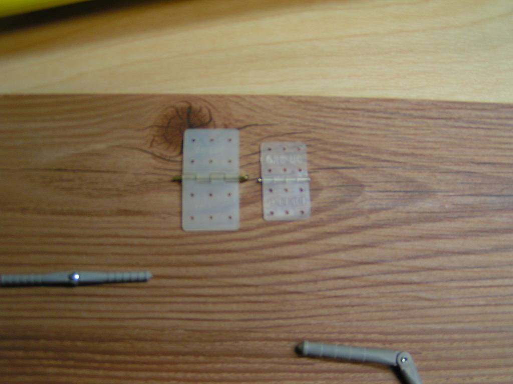

The hinges are glued in at the factory on everything except the stabilizer, since you have to slide thestab. into the fuse and glue in place...
Here is a pick of the hinges that they are using and the quality sucks on them, if you grab it and pull out wards from the joint, it moves almost 1/32" and what ever glue they used on them at the factory has bound them up but good.. Some of them are moving when you work the control surface, really piss poor if you ask me... The Hinge gap is also unacceptable to me, almost an 1/8" in places then add in the movement of the hinge and you see where I am coming from on this.. This gets better!

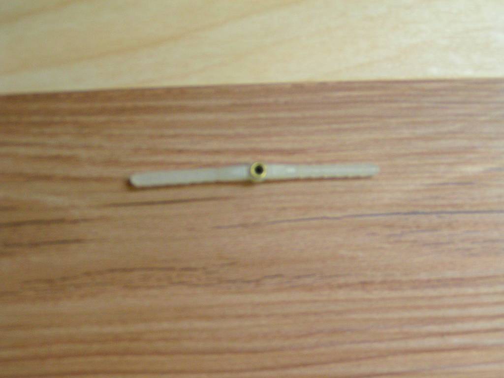

I think for the tail the sulution will be a flat hinge, I will use the bigger ones on the ail. and the smaller ones on the tail...
<span style="color: #ff0000">This is sure turning out to be a lot of extra work, but It must be done.. If I just slapped this thing together and something let loose that I could have fixed and it hurt someone, I would hate myself...
