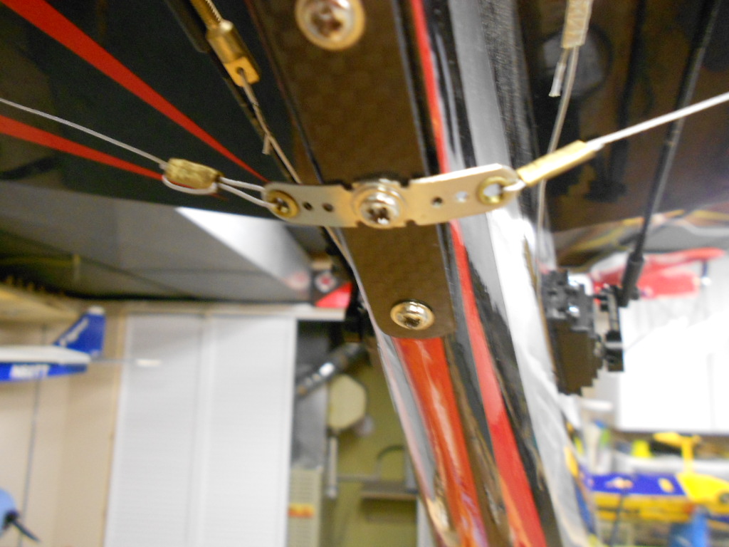

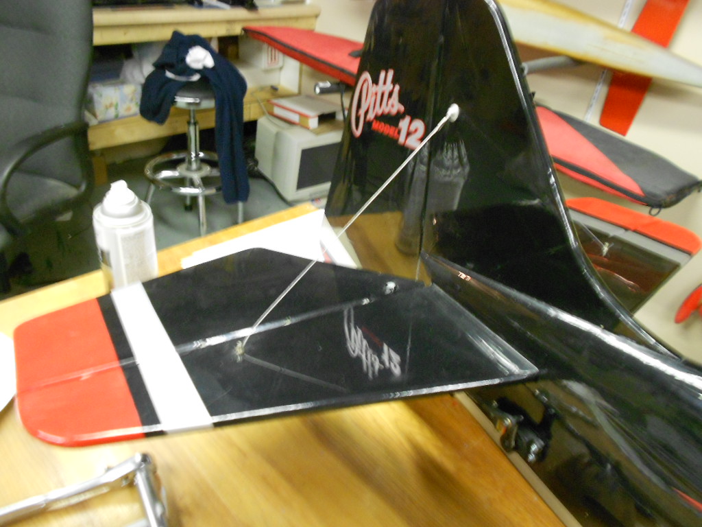

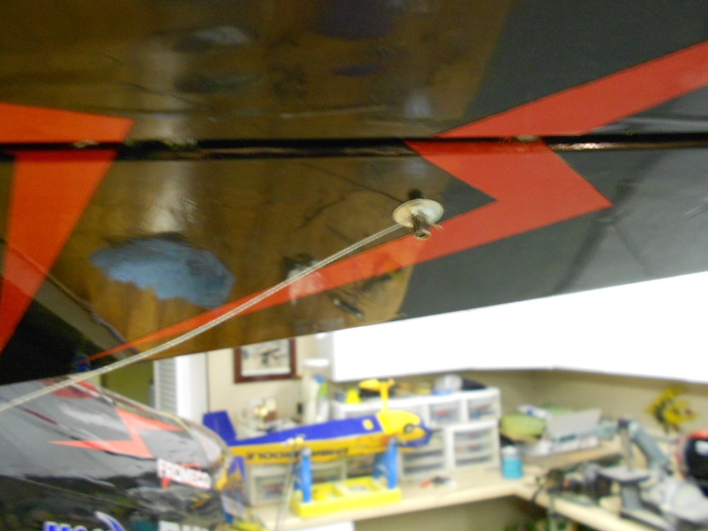

Maybe the just shorted you the hardware,, here's a picture or two of mine. Uses pull-pull cable, etc.

I just talked with my buddy who I bought the Pitts from,, he tells me it didn't come with anything but the top post for the wire,, his instructions showed just the fin supported by the wire on top of the Stab., but nothing supporting the bottom of the stab,, he got parts via Tower and fabricated the wire set up himself,, this is what he used
http://www3.towerhobbies.com/cgi-bin...?&I=LXLGP3&P=7
http://www3.towerhobbies.com/cgi-bin...&I=LXCLZ1&P=SM
Personally I'd probably use a different system or heavier gauge wire at least,, I already have had to replace one wire because the set screw pinches the wire enough to make it break
Old 04-11-2012 | 04:14 PM

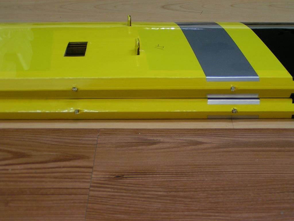

The fly wires are what bought me to this thread mine has some nice fittings for the stab but no instructions on how to fit them. I wanted to see where they are being placed to be most effective..

ORIGINAL: STATUS TUNING
<br type="_moz" />
ST,
mine is the yellow one and the covering is semi transparent, you can see the mounting blocks in the stab and finon mine.. I will try and get a pic or two for you this eve to help show where they are...
Jimbo

Default RE: Goldwing 50cc Pitts Python V3.
Anyone that has this plane, be very scared of the pre hinged surfaces.. Here is a pic of one that took very little force to pull apart, total junk IMHO... I decided to use the robart hinge points, large size on the wings and the smaller ones on the tail...
The first pic shows how bad the hinge gap is, almost an 1/8" in spots...
Pic two shows good hinges next to the crap they used, 3rd pic is how weak they really are....
ID:	1777637   Click image for larger version
ID:	1777638   Click image for larger version
Old 07-01-2012 | 04:58 PM
  #75
Joined: Dec 2010
Posts: 1,433
From: Mt Morris, IL
I am so glad mine were glued in crooked, forcing me to change them. After seeing how easy I was able to score them with and blade and pull the surface right off, there is no doubt that mine would have failed sooner or later.. I would really check yours out guys, hate to see you lose a plane over them...
To get them apart I just scored the top of the joint on all of them and work the surface to it's max and they all just broke apart.. Pics show how crooked they were installed, thus the major binding I had. Being they were not put in straight, they were stretching the little loops that go over the brass ringthat holds them together...
The fix won't be to bad, but work non the less... Using the larger Robart hinge points calls for a 3/16" hole, using a piece of 3/16" brass tubing on a drillto core them out is working great.. The tubing fits right over the old hinge and pulls out the old hinge like it was never there. If you end up doing this, make sure you take off the brass eyelet and as much of the hinge sticking out as possible and it will fit fight in the brass tubing..
Jimbo
