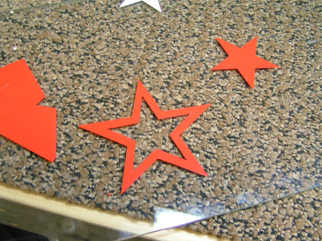

Starting the dolling up work...
I came up with a few things that will add some color to the pitts and make it different from the stock "Bulldog" scheme... Here is just a start on the ugly baby puke yellow control horns. I will also be adding some color to the covering as well, just to spice it up some..
pics
The stock control horns were an ugly yellow, so i scuffed them up with some sand paper, cleaned them with some thinner, taped them offwhere they will get epoxy and sprayed them... I also did the control rods as well..
Anyone have a source for clear water bottle type gas tanks, that are ready to go.. The ones I found don't come in the 20oz size that I want... I have enough to do on this plane and really don't want to make one myself...

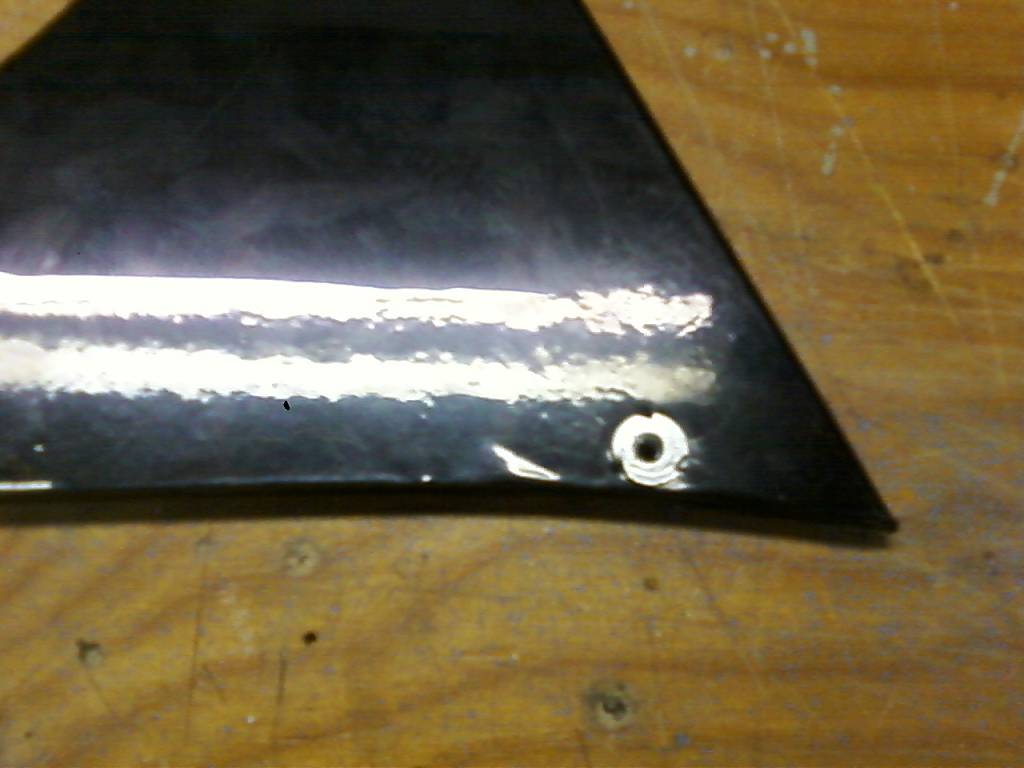

I got the top wing hinges all taken out and the new Robarts installed,I'm pretty happy howthey came out. Silky smooth action and a nice tight hinge gap with more then enough throw.. On to the bottom wing and rudder and the hinge problem is behind me..

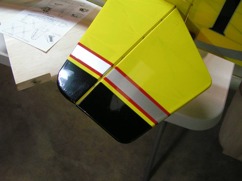

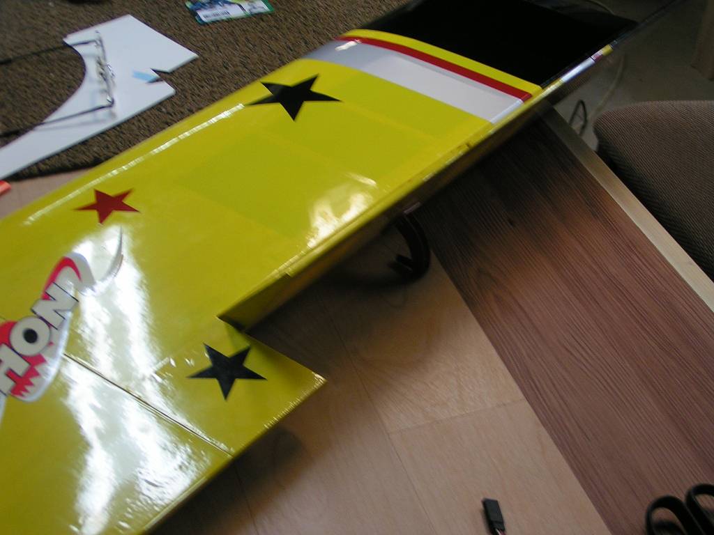

I added some red to the top wing and will do the same to the bottom wing, fuse and tail.. I think it will add a little something to the overall look of the plane.. I am also going to order a DLE decal with the same colors..

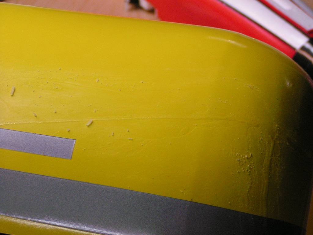

I'm so mad at myself right now, I did a very stupid thing... I was drilling the cowl for the mounting screws and when the bit went trough the glass it popped the wood support piece off the inside of thecowl, no big deal, I will just glue it back on... I remembered that all my epoxy is screwed up, so I grabbed the CA to do a temp fix of the problem so I could finish mounting the cowl.. Using the CA it didn't dawn on me that there was already a hole in the glass and the CA just ran down theoutside of thecowl...
Anyone have any ideas on how to get the CA off without hurting the paint?

Here are some pics since I added the red into the colorscheme... I'm very happy with the looks of the plane now, it's amazing what some red stripes, stars and a lightning bolt will do to the over all look of the plane... All the black and silver is stock, I just added the red..

Here's something that will remove CA. I use a small piece of paper towl soaked in Kwik Debonder from Hobby People, then let it soften the CA a little, then wipe with the paper towl untill it is removed. I have used it on cowls, with no damage to the paiint, but to test to see it does not harm the paint.

Well the cowl is toast! The De-bonder I used took of the clear coat, kind of.. More like turned it into a sticky mess, but didn't hurt the paint.. If I can figure out how to get the clear coat off without hurting the paint, I can just shoot it with clear once all the CA is off.. Any tips if this can be done?
My other option is to fix the cowl which was very ugly to begin with, you can see every seam in it and some of them are bulged up from lack of sanding before finish...  If I end up going this route, I doubt that I will be able to match the yellow that was used on it as well as the canopy. So I will have to figure out a new color scheme for the nose and that will be a PITA, being the silver stripes on the fuse went along the cowl.. I have to do some thinking on this one!

If it's just the clear and the paint under is good, just get some Crystal Clear,, I think krylon makes it. Worth a try.

Do you know of anything that will take the clear coat off and not hurt the paint, that is stronger then De-bonder? The De-bonder has turned it into a sticky mess, you can see where it is missing around the CA I was trying to remove and any that got on the rest of the cowl has turned it tacky... I tried a very small amount of thinner, but that didn't cut it...

Most likely it will (out gas) dry hard after a few days, if not try hitting it with lacquer thinner, some times even just spraying the lacquer thinner on and letting it evaporate will restore the shine. You 'll be able to see right away if the thinner will work, it will either uncloud or not.

I am going to head over to the hardware store and see what I can find to try and fix the cowl issue. I think this whole problem is telling me to fix the chipped canopy and sand and fill the cowl like it should have been at the factory. I can also get the canopy to fit right at the turtle deck.. The juices are starting to flow on a sharp checker board paint idea for thenose that flows onto the canopy as well.. I can then try and match the silver add some red and have the stripes dive towards the bottom of the cowl.. This GW ARF is turning into a total bash all because I tried to save a few dollars on the air frame...lol Just have to take it in stride I guess, one thing is for sure, it will be the only Bulldog Pitts Python that looks like this in the whole world...
