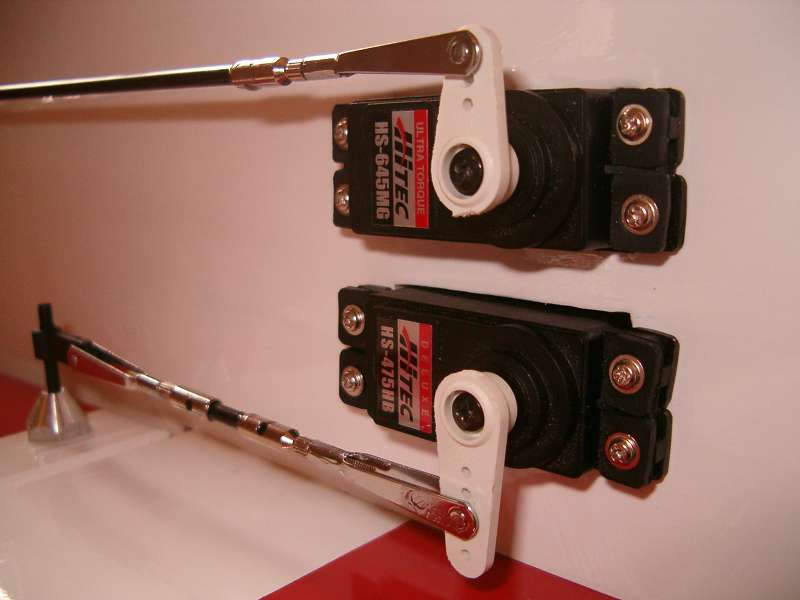

Oldstoney, Joe and everybody...
Fairly whizzing along with the UCD now..the Irvine carbon rods and chrome plated ends are superb ..so sleek.. Glued and bolted the horz stab in situ....all controll surface hinged and mounted, " small " # 117 Du-Bro pinned hinges & Du-Bro heavy duty horns ...all servos & ext'n leads routed ...Belly pan mounted and affixed with....silicone adhesive / sealant, have a look...[:-]..... wheel pants sorted as per recomendations, ie DONT cut the end of the axel shaft ,route it through the other side of the pant ....GP balance machine out later for gear placement... Pukka O.S. remote glow to fit, along with fueling valve.... couple of other twiddly bits then thats about it....Oh ...canopy...!

Joe , Stoney et all...
Had some more Du- Bro horns and stuff arrive from Tower this morning ..stock # for horns is DUBQ1885 or LXEMF9..$5.69 for two..see photo.. sexy stuff ..!

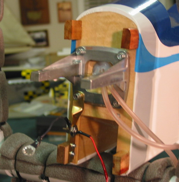

Joe..Yeah..
when you posted that photo up of that engine/engine mount set-up..basically you were going to be the thicknes of your eng mount lugs shy of your centre line...
Whichever way up you mount that GP eng mount , the bearer face of the mount ,ie the one with the webs attatched to it will allways be on the centre line....
I was led to believe that all (generally speaking) engines had the centre of thier crankshaft in line with the bottom face of thier eng lugs, so...Hell, ! You know the rest..!

On the balance m/c ...no major probs...except you need to lay some sheeting of some description accros the wing for the pads to sit on..
Got the tank mounted with a nice Du-Bro filter ...photo...
Semi fitted the remote glow....jury is still out on fueling valve requirements...got a GP valve but not sure if its the way to go

olstoney - I know there has been much negative press regarding fuel valves. I have been using for years with never a problem. The guy who passed this along to me has been using them for as long as they have been available and likewise, never a problem. if you let an airplane sit up for a long while the rubber seals can dry out which can allow air to create a problem. Likewise, a crash into the dirt can cause dirt to create problems. One thing for sure, the valve sure keeps the fuel from flooding the carb and makes refilling a very easy. Now I know Joe hates the added weight, which you may also want to consider [8D]. For those guys with flooding problems this may be the cure.
I also put a remote glow on mine. I took a piece of brass and twisted it to mount to one of the engine mounting bolts and then used socket head wood screws to mount to the cowling hard point. For the fuel valve I used a thin piece of ply and made the mount and then notched out a slot for the mount to fit near the firewall. Both have held strong and worked justed fine. I did have the remote glow wire come loose yesterday due to a bad soldering connection on the wire going into the remote glow. The wire came already attached form the mfg. I guess it just wasn't strong enough to handle the vibration or maybe I caught a wrench on it when installing the muffler. See the pictures below for both. The remote glow sure makes engine starting much easier in that you don't have to reach below the engine when mounted inverted. I just stick the glow driver on the side and fire the engine.
