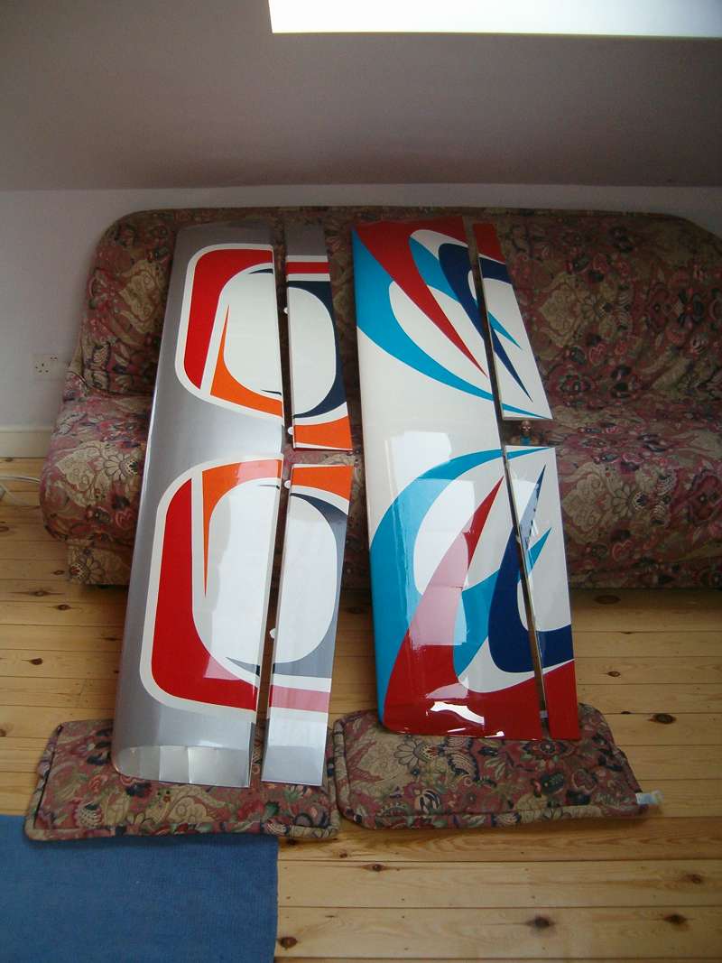

Roger & anyone Else..!
Hope everyones around !...might ..( NO..WILL..! ) need some help here... thought it best to open a new thread .." Cyclone " same ARTF & RTF location....thought the UCD had some wings on it...! [:-]
Bit of a taster... ( photo's ).....Divorce ...LARGE..

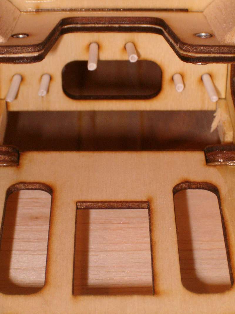

Mat..
Just opened the box really.. simular to UCD...bit thinner section to airfoil, all laser cut frame....comes ready to go either way with internall pull/pull setup...or servos rearwards..helps no end on your balance requirements...which,in turn, is dictated by the hardware you put up front.
All pull/pull fixtures and fittings are supplied,as well as rods should you go aft with your servos,much more ' open ' construction than UCD, much high grade, thin ply.
Vert & horz stab are constructed with brace point strengthening already in place,should you wish to brace them with the steel cable & fittings ,supplied..!
The more i go into this the more superb it seems..!
The prop driving face is to be 135mm from the firewall, same figure for c of g from LE
Slight taper to wing chord at tip,huge controll surfaces
Ali Mashinchy, ( of " Al's Hobbies "...London, fame ) one of europe's top display pilots has his photo on th box and was involved with " YT International " to create this and a couple of other freestyle/3d kits..dazzling stuff..
You guys should be able to get one of these for $249.00... unbelieveable..!
More later,Dave.
Just a couple more pic's of the internals this time ..looking back to the pull/pull provision...

Dave, you are pushing your wifey's limits. Tell me about the location of the hor. stab in relation to the wing elevation. Are they in line or is one higher than the other useing the thrust line as a guide. Thanks, Joe

Lord Lucan, you have my attention. Looks very nice. I agree with Matt that it looks like a larger UCD with different covering. Do you have the website for more details?

Joe ,
The centre of the horizontal stab looks to be 15mm above the thrust line, while the centre of the wing is 15mm below the thrust line + or_ 0,25mm...it's 4 in the morning here..!.. going to take some bits into the weighing room today ..it seems an incredibly rigid airfame..Dave
