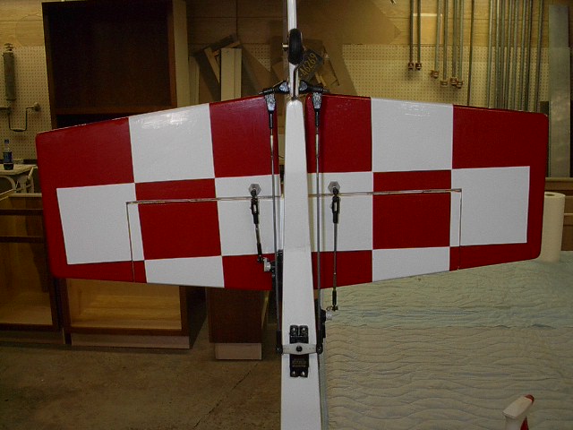

..Oh..! ment to ask this one a while ago too..any hot hints for pull/pull setups...the only thing i have been told is keep the distance from the centre of the servo, to the centre of the holes in the servo arm, the same as from the hinge line on say, your rudder, to the holes where the clevis pins go in the horns .... shall i type that again
...sounds complicated..
...how taught are the cables supposed to be...?..

Dave, Yes the connection you speak of is considered 1 to 1. It is equall. Now if you are useing the HD setup with the rod that goes through the rudder with the conical standoffs and lock nuts then you must bend the rod equally on both sides towards the servo or front of plane about 10 degrees on either side. If left straight when useing cables you will find that while the pulling cable stays taught as it pulls to turn the rudder, the opposeing cable develops some slop. When the rod is bent for some reason both cables remain taught. If useing control horns then I do not know how it would be compensated. As with any connection you want it to be slop free. The cables should be tight enough to be slop free yet not to a point where it is putting excess strain on the rudder hinges, rudder or servo. When connected, at half span, by applying pressure with your finger, like on a guitar string, it should flex about a half inch in both directions. Also the cable cross over each other in the shape of an X in this setup. Here is a pic of how the rod should be bent.

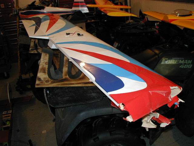

Well to start off ...me and a new found friend were at the field doing some formation flying then we started getting a little crazy we were doing the ( how close can we get to each other head on) and... Bam...mid-air....I was flying my GP big stick 60 and he was flying his seagull zero....on impact my stick cut one wing and the tail off his zero....the zero went down in flames ...the stick suffered damage to the left wing and landing gear but was able to keep flying ...I got it back to the runway and landed it with no problem....in the frontal pic of the big stick I had straightened the gear ..it was bent up 30+ degrees from the pic ...Then 2 guys crashed do to radio problems the heli,do to gyro failure...Now the 3d...I was flying inverted at about 6' over the runway then when I banked left a friend (coming from the other direction at a higher altitude ) pasted over me I tried to roll right and my wing tip clipped the ground causing the plane to cartwheel nose to tail ...I was very happy that the damage minimal ..the damage consists of wing , landing gear ,cowl, spinner & prop canopy,horizontal stab....I haven't had the time to look it over so it my have more hidden damage.....pics of the GP big stick and the 3d.....JW

J Dubya, aside from obvious problems, your engine ran cool enough with that little air inlet cut in the cowl? Now is the time to cut off the wing tips. Guys are reporting good results with them off regarding knife edge and harriers. Thats not too too bad, its work though. Now here is a wreck.

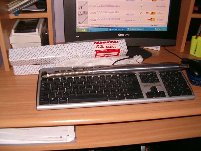

Stoney..
Sounds like your weather is much better than here...bad wekend looming.. arghhhh ...she'l have another huge list for me..[:-] ...UCD finished ..Cyclone 90% done... stalled.. waiting for a header pipe ( inside ) for the 1.20FS...to mate up with the 502 pipe system..bound to be some pipework mods to do...Tower have for some reason "Discontiniued" this item...Buggers..
i feel a visit to the coppersmiths at work coming on
...had to wiz out and buy a little "something for the weekend.."...nothing major...a Ripmax low wing trainer.. " Skymax 40 " Peter had been yapping on about..i'll send some photo's...quite a nice little kit really...for £60 quid odd...same price as a tank of Gas[:-] ..catch ya later..

The part # for the header ...72140400 ..thats an O.S Mnfr's no .. it fits into the bit above the ''caps'' lock key.. catch ya later

Joe would call my crash .....Hanger rash.....LOL....actually my wreck was a good thing ...this morning after looking it over carefully I removed the cowl and to my suprise two of the motor mount screws on the right were gone but the blind nuts were still in place.... I was wondering why it would track to the left in a hover...and now I know....and with that being said ...............................................
I would like to REMIND everyone about the Dangers of RC planes and the power of your motor .....PLEASE NEVER EVER tack your engine from the front or allow anyone to get in front or on the side of the prop with it running. I know we all become complacent and kid ourselves (thinking It wont happen to me)....believe me I'm as guilty as the next guy I was tacking my YS110 from the front the day before.... knowing the Dangers involved.......Tonight at the field a friend was starting his Funtana while it was on the ground unrestrained.... I think he has a Saito 72 or 100 with a plastic spinner on the front ....Well guess what happened.....the spinner shattered ....stunned he reached for his radio and the prop struck his left knee cutting through his pants ripping three very deep cuts in the side of his knee on the inside ...the cuts were about 2-3" in length and 1/2" deep...his nice white Funtana had chunks of flesh and blood spattered all over it......I'm being graphic hoping to make everyone take note ..... be careful and Please respect the power of your motor it's not a toy ....and DON'T use plastic spinners on the high powered motors it is a disaster waiting to happen......If by writing this I can stop just one person from getting hurt then I think my friend would be happy...SAFETY FIRST...oya one last thing ...a first aid kit would have been a handy thing to have at the field tonight....I'll have one from now on...... JW
