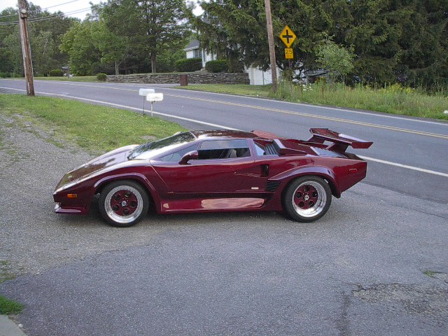

I will stray off topic and back again here.
Joe the Ferrari is a beut, I believe it based on a the 512 BBi Boxer in race form, I was at Summit Point with the Ferrari club in a 328 GTS when we got passed by one at about 140pmh, fun n games.
the Ducati is nice, my pal has a 748 SuperLight, insane and Italian, good combo.
The Countach is a fake, nice kit though, looks decent.
I run with some well-to-do'ers, unfortunate I am not one myself. Pics of my best friends Lotus Esprit here: [link=http://www.hideinmy.com/trip/]Matts gallery[/link]

Default RE: u-can-do 60
Matt, good eye, the countach is an ARD. Almost ready to drive with a small block chevy pushing about 700 hp. Meticulate job however. Made quite a few magazine covers, one with a babe in a very tiny bikini, which I didn't really notice at the photo shoot. Joe

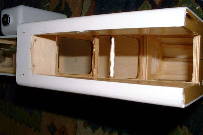

Last nights surgery was successfull. To balance @ my preferred 5-1/2" CG required the 5 cell to be placed mid way down the fuse. As the only option, I had to cut a hatch, I hate hatches. The battery was too wide to just lay flat, so there was some engineering involved. Came out well, Joe

lord lucan's Avatar
Joined: Jan 2004
Posts: 716
From: England, UNITED KINGDOM
...Necessity is the mother nature of invention... [8D] ..or something like that ...Have you contacted the Great Planes patents office Joe...Nice going..

oh wow Joe! Nice job on that mod, good work!

cumn thru,
Welcome to UCD Hatch Cutters. I've been flying my UCD 60 with the CG at 5 1/2 inches and it took a hatch cutting to get it there. It surprising how little effect moving the battery around in the radio compartment had on CG. I thought I was going to run out of fuselage before I got the CG right. My hatch in the bottom of the fuselage is centered 29 1/2 inches back from the wing leading edge.
I moved the CG to 5 1/2" and made engine thrust angle changes with hopes of making the UCD 60 do 3d as well as my UCD 46. It helped a lot.

Rocketman, up untill this point the UCD, with a comfortable 5-1/2" CG, was attained by the 5 cell nestled in the rear of the main compartment. With the departure of the Saito 100 and the newly installed YS110, I found extra oz. to be dealt with, therefor the hatch at mid fuse. I'm happy with it. We will see how the ballast in the tail helps in hanging it.
