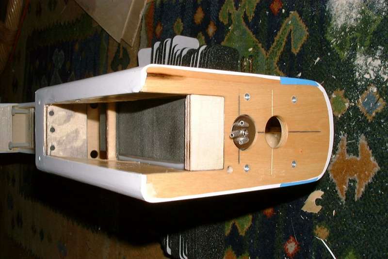

Had to wait 2 days for 4 mm carbon rod to get to me
Under-cart now has a3/8 doubler on the front half former, with three 4 mm carbon dowels,
Passing all the way through from the wing locating former.
Reinforced the front fire-well with carbon tows and epoxy.
New tank position is right on center line of carb, and level all the way back, room for a smoke tank now on top.
see pic

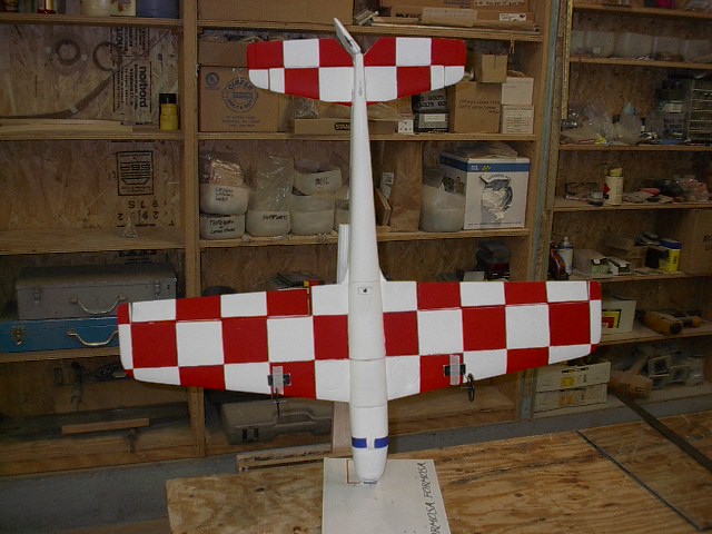

Dave, now I'm jealous. You don,t know how many times I've sat on the beach wishing I had an electric. I do have a GWS 'Formosa' that is 98% complete. Just may have to finish it. Its sporting familiar colors as well. Joe

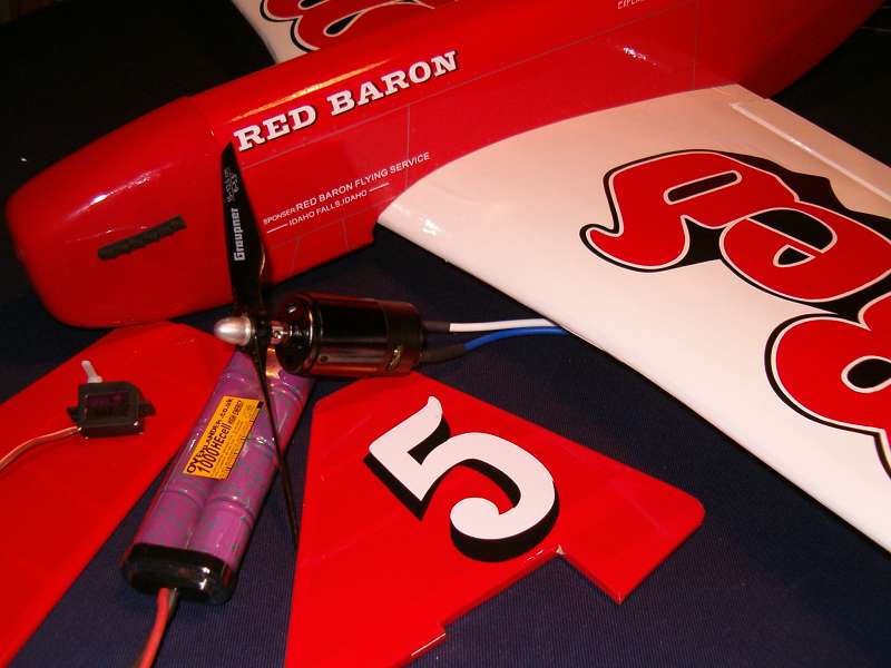

...will this red chapie line up O.K. with the Pre-installed blind nuts on the bulkhead.. i seem to remember going round the same issiues...
Joe ..less than 24 hours into Project X ...and into the never ending quest for more power &...Speed i've wizzed out and bought a better.. "Hot " motor...this is all your fault...i'm YS'in the " Red Barron " allready...

Dave, on the lower pic, those servos, they make a SD250 with metal gears well wicked servo,
on 6 volt the speed is .10, very, very fast, and torque is 4kg, and weigh only 24 grams, very good setup for
Planes that need twin servo setup on dual elevators.
