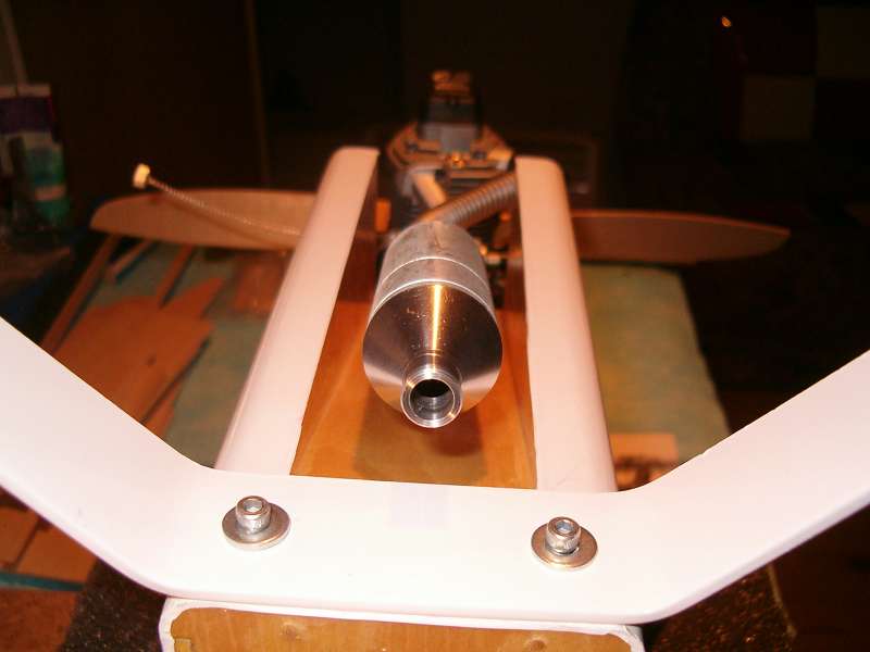

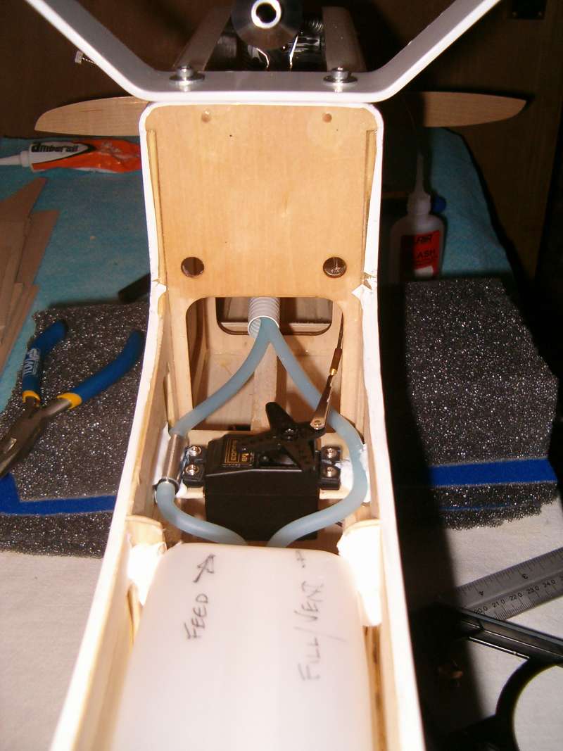

Got the 110 mounted. 5-1/2" from back of spinner to firewall. Nice and tight to aid in balance, No chance of the blue stripe lining up now. A new cowl is in order, with the existing access holes and the new ones required, it will look like swiss cheese. Got some plumbing to do and relocation of the throttle linkage. Then its balance time. Work is interfering with pleasure, as usuall. Joe

Xup, right now I'm adding another 5 oz. to this already 8 lb+ plane. I built a few before and they were all pretty close to spec. The only way it would be a 7.5 pounder is with the use of all the cheap hwde. supplied. The concensus shows all 4/40 rods, ball links, HD control horns and 5 cell-6 volt battery, it helps with the balance. I chose a pull/pull on the rudder. It adds up. Joe

Joe, I know how you can cut down on some weight there pal. The hardware you are using on that skinny little rudder is just massive. The wood in the rudder, hinges or both would give way long before that hardware would. I know you are upgrading to the YS, but even then it still seem like wasted poundage my friend.
Have to admit I did the same thing on my Pitts with the gasser, and then realized it afterward. Just wasn't necessary at all, but it looks good.
Also, if you are self employed you are the boss and can do as you please. Congratulation on living the dream my friend. I'm going to get back to work here one day when I get bored. This is the first time I have taken any time from my career in 28 years. It's been nice so far, but can tell that I will need to have something to keep the juices going until I am really ready to go into full time retirement. Not there just yet, but getting a taste and have to admit that I like it.

Roger, it is substantial, but with this notoriously nose heavy plane it was better than lead or the battery swinging from the rudder. One good side to all the late hours and no weekends, when the weather gods smile, its out the door and skyward. Joe

Ah! very good point and I agree, especially when you consider the weight of the new engine. I wold also leave as is. BTW, I painted my canopy for the Soiucy and it worked out perfectly. Thanks for the suggestions. Now this really does look hot!
