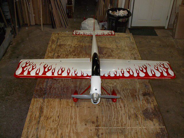

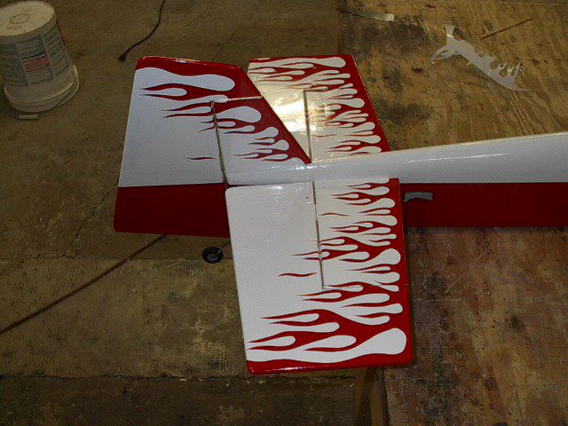

From out of the ashes............I just might have to christen this one the 'Pheonix'. Made a little progress in about 40 intensive hours. Just a little more detail to the covering and time to install the gear. Picked up a 'Hatori' header to route the pipe down the heat vent. Not sure on a muffler yet, but for Sundays fly in I'll be running the open header......oh yeahhhhh !! Joe
Check out the new colors, or should I say the lack of them.

..Looks Ace Joe
...Better than the origonal.

...Joe that's lookin well smart now..

Joe, your new bird looks great, nice flame job!! I would guess that she will be set up similar to the last one?? Are you still contemplating the Yak??

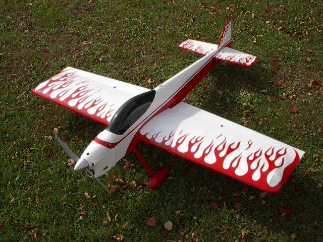

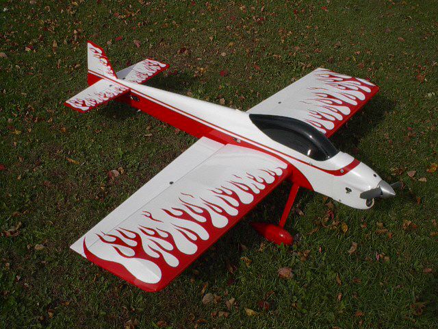

I t s b a c k !!!! After about 40 intense hours its ready to re maiden. I feel as though all I've been doing is 'first flighting' UCDs for the past two years. Sporting new colors and a 'Hatori' header for that YS110FZ. Don't know what I will do for a muffler, but I like it not coming through the cowl. For now I'll run it with the open header......ohh yeahhh !!!!!! Finalized the rudder mod as well. Added a couple more inches to the top at an upward angle towards the back. Comes out to about 64 sq. in. compared to the stock 80 sq. in. Right now it seems to lack something, perhaps that stripe that runs over the cowl and down the sides. Got some YS decals comeing, that will help. Check it out. From this........ to this !! Joe

Magnificent Joe, whats on the underside ?...one question though...was that "Flameing" trim precut or did you do it by hand ?

Dave, the underside is the stock scheme. Red and white checks. Only difference is the bottom of the fuse is red as well. Yes, the flames were hand cut. Tedious to say the least. If I pop this one in it won't be as easy as just buying new components. What have I got myself into? Never had retracts, marvelous little devices. Good luck with the bear, I'm sure it will sparkle as the rest of your fleet does. I need a fleet.
Brian, yes, same plane, same setup. Just new skin, and I hope this skin is thicker, if you know what I mean. Can't complain though, flew this one all season with at least 75 flights. As far as the 'Yak' goes, it is very appealing, yet I think my next project will be a gasser. Mmmmmmm, Wild Hare !!

I forgot, it weighed in at.............gulp...... EIGHT POUNDS, ELEVEN OUNCES !!! what a fatty. Wait till Roger hears this. Joe
Good god [X(] Far and away the heaviest UCD of all time. Thank god you have the big YS in that puppy. Joe you have an uncanny knack for picking heavy planes. My UCD with the Saito 100 is 7 pounds 4 ounces.

Coo, you got me on that one. Previous builds were all around 7-1/2 lbs. until this one. Now keeping in mind that the current one is a compilation of the first three, yet no deviation in the building process. Along with that, there is now what I believe to be, 'a small amount' of re in forcing and the glue involved for the re build. Also, this is now covered with 'UltrCoat' as opposed to 'MonoKote', which I believe is heavier. I guess it all adds up. I just read of another that weighed in @ 7lbs 1 oz. I'm jealous. One thing that I have noticed is how the additional weight has really smoothed out the flight characteristics, dosen't seem as twitchy, but most likely has lost the advantages of a lighter model. At this point, I will fly it for what its worth. I still enjoy this model. Joe

Great job Joe...contact Don Anderson ASAP.....
Colour Scheme for the "U-Sure-Can-Do-3D" ..
...is it me or does it look ' Plumper ' round the middle..
...Nice.
...Nice.

Plumper? I'd say this heavy weight is down right FAT!!!! Got out tonight and the UCD is bigger and badder than ever. Couldn't notice the additional 5 oz. Spent most of the evening shakeing it down, tweak here, adjustment there to the control surfaces. Gotta have those trim tabs centered, all mechanical. SWEET!!!! Little too loud though, 102 DB. Going to have to come up with a muffler or figure a way to attach the stock one if I want to fly at the field. The rocker clearance setting adjustment was very noticeable, lots of power. Okay, I'm happy now. later, Joe
