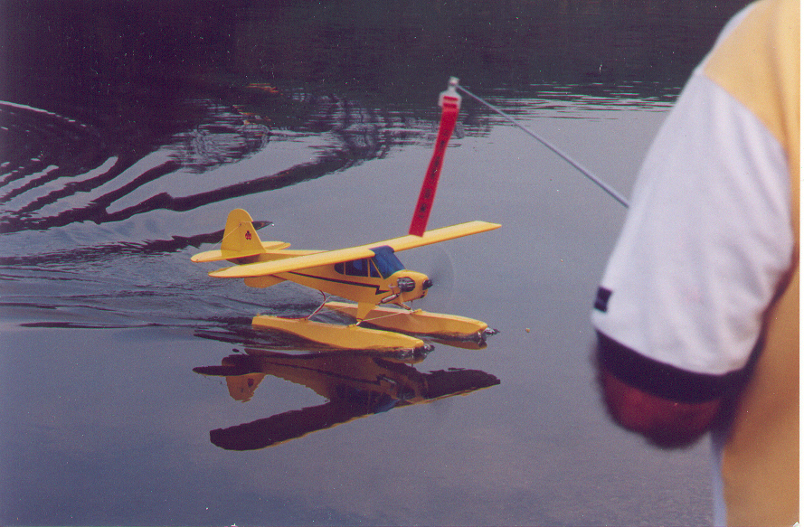

Our friend JLK had it right, Testor has several transparent colors and some will gag a maggot.
I should have mentioned that; and also, that you can apply it light or darker with several coats.
Here is one of my float planes, a Piper Cub of course, with a medium coat. Above it is a Dave Patrick 1.20 bipe.

The Cub is a Goldberg kit and the floats are also Goldberg floats. I built them up from a balsa and lite ply kit. I put metal from a couple of tin cans at the high contact points and I can taxi it on to the stony beach at the lake with no concern. I have an O.S. .91 4cycle up front.
I have to travel to Blue Marsh lake near Reading, PA 90 minutes each way so I fly mostly on snow and on the wheels. I built the clipped wing version and it still floats a lot so I use spoilerons to spot land it.

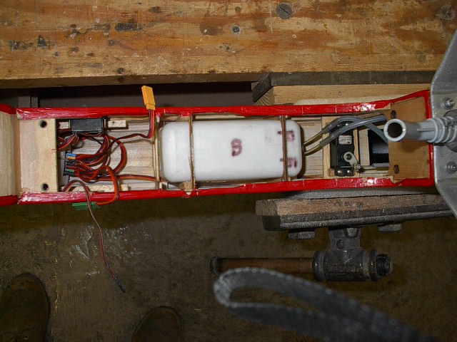

Wind with this bird is no biggy, unless...........................its a cross wind. The size of the rudder is obvious, combined with that one nasty habit of pitching to the wheels on rudder application makes for a very interesting cross wind landing. A light wind is not a problem, a good cross wind is challenging.
Yes, one of the benefits of a pressurized system is the option of tank location and the mod is simple with the UCD. Thought I had the pic cataloged. Well, its in this thread somewhere. Joe

Joe, thanks for the picture. There is a lot on info on this thread, and I am a Y-S and O.S. man mostly. I haven't been too lucky with the Saitos but I know some guys have proposed marriage to them.
I plan to use two Sullivan fillers for the Y-S and fabricated an aluminum bracket bolted to the motor mount of the inverted engine. How did you mount your fillers?

Went to the harware store and picked up some P clips. They are used for mounting the 1/4 inch plastic lines like the ones that run to a refridgerator water supply. Hold well, no chafing or bad reaction with the fuel line. You can see the filters and the one way valve in the pic. Joe

I see from your picture that you use a filter in your Y-S exhaust line. I do also, but most folks don't.
I have been reading some of your posts and you certainly are informative and a good mechanic.
With my Y-S engines I always have two fillers. One is to fill the tank and the other is to exhaust the tank pressure after a motor run and also as an overflow. I know the U-Can .60 isn't a pattern plane but this way I can cowl everything inside and don't have to pull off hoses. I prefer the Sullivan fillers even though they take up more room.
