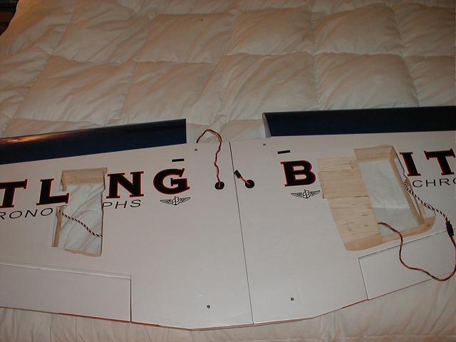

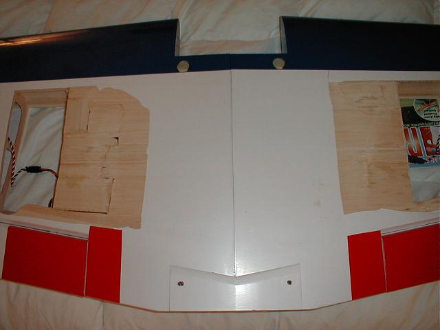

Well, I decided to fix the broken wings, they are not too bad. Probably could get by with them, but I'll get the new set going also as a spare (does it sound like I am prepping myself for another tragedy? You betcha! you never know!!!)
Here are the pics. Planes Plus is sending me 6 feet of covering with my new wings, so I should be able to fix this and the holes in the back of the fuse where the servos were..

If you cut out the original letters and they still have the Chinacote layer on the back side of them, you should be able to simply iron them back onto the new surface, if the heat does not adversely affect the vinyl and it's adhesive. Generally nothing sticks better to film covering than it does to itself. You may need to carefully clean the back side with a cloth dampened in acetone.
Also, any noteworthy items in the wing construction? Balsa or Hardwood spars? Plywood or Balsa Shear webs? Adequately Glued?
