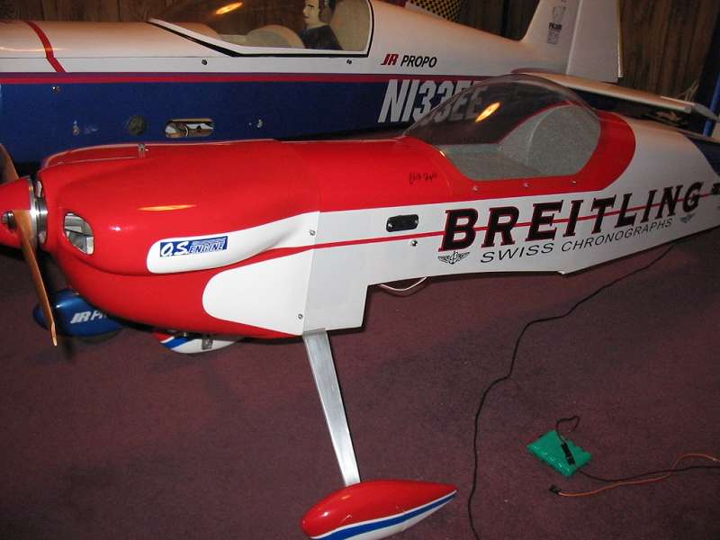

We never got the Cap into the air - the wind was blowing 15-20mph. I weighted mine and it came in at 12.5# w/ the moki 1.8.
I could not get the motor to run right w/ the Perry VP30. I was reading the manual and it says the tank should be vented naturally - ie no muffler pressure. Is that right? For those of you running the VP30 - are you attaching the muffler tap back into the tank or is the tank vented to the open?
Drew
Drew

The tank is vented to the atmosphere on mine per the instructions.
What kind of problems were you having with your pumped Moki? Is it brand new? What kind of breakin time does it have on it?
Richard
Richard

I too would like info on perry pump install.Like how many lines and were to.
Flew my cap x this weekend four flights all went bad.Went dead stick and all I can say is wow.
All dead sticks were from my muffler coming off,any help would be nice.I have loctited the bolt
let set 24 hours and they still fell out.
Anyway back to the plane,Man what an amazing aircraft.On my first flight I was doing rolling circles.And I have only done this on a simulator. Muffler fell off and "oh ####" I was down
wind.I thought here comes the tip stall,But no that was not to be it just glided in and set right in to a three point landing.And this was all four times.
This plane is way over powered with the moki 1.80 on it.Totally unlimited vertical,beautiful
knife edge,a little belly pitch but it can be mixed out. Tracks like it is on rails.
I will have one for a back up. Chip has got a winner here with this plane.
Anyway here is what i have in mine
Futaba
3305 on rudder and wings
3010 on elevators
1200 mah battery
moki 1.80
bisson pitts muffler
balanced perfect no weight
Will install perry pump and 20 oz. tank no other mods.

throttlestick,
You have a line from the tank to the pump (clunk line), pump to the carb, a vent line from the tank to the atmosphere, and a fill/drain line from the tank to a convenient spot. There is also a line from the crankcase pressure tap to the pump.
While this will definately keep the motor running when the muffler falls off, this will not help keep your muffler from falling off. Mine has fallen off three times since I've had the Moki. I think I was undertightening the bolts. Luckily, it doesn't fall out of the cowl easily. Last time, I really got them good and tight and it has not loosened/fallen off in 15 or so flights. Loctite does no good, the temp is too high.
I personally don't think large fuel tubing, etc... is necessary with a pump or regualtor system. I have the large tubing going from the pump to the carb, because that'e what I had on hand...
Richard

I am installing my Moki and I was wondering what is the best way to cut a hole in the cowl? The photos that Rlewis sent in look pretty good. What did you use to cut the holes?
Also I am getting ready to order a tail wheel. Why did you use a higher weight tail wheel? Was this because it was all you had or is there some other reason?

For the bottom of the cowl, I taped over the area I would be cutting with masking tape, drew lines on the tape to follow, then used a cutting tool on my dremel tool to cut just outside the lines. The used a small sanding drum to carefully finish out to the lines. The tape is used to give you a temporary surface to draw on and if you mess up you can peel it off and start over. It also will protect the finish somewhat if the tool should slip. For the glow plug hole, I just used the cutter very carefully (too small for the drum to go through).
The cutting tool I use is a 1/8 inch drill bit that cuts sideways, sort of like those roto-zip cutters, but with burrs on the side like a tile cutter. The Dremel Tile cutter is #562 and is similar to what I have. I also use Dremel #115 and Dremel #199 alot for this type of cutting....
I used the 25# tailwheel because it was in stock at the vendor I ordered from. I found out later that the 15# on was in stock at Graphtech and could be ordered directly from them. I would think the 15# would be more than sufficient fo this plane...

I've had problems w/ mufflers falling off - Try Permatex - Ultra Copper on the threads and the connection between the muffler & engine. Ultra Copper is a high temp RTV - works great!
Drew

I've found that by running the engine till it's normal operating temperature, then tightening the muffler bolts usually "sets" it pretty tight when it cools down and haven't had much problems. Before that I had problems a lot even with loctite.
