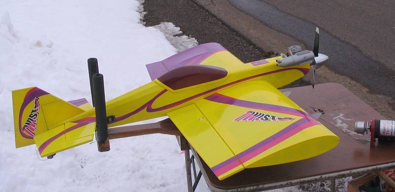

Did a bunch of work on the slightly used twist I picked up. This guy did a really nice job of putting the thing togethor. I moved the battery and receiver all the way back, and was able to take an ounce of lead off of the tail from the original owner. My CG is at 4 3/8 with out fuel. I figure if I want it any farther back, I will move the engine back 3/4 of an inch. I would hope the motor mount would be fine with 2 sets if holes 3/4" apart. If anyone has any experience to the contrary let me know!
The way the guy has it set up, my flaperon dial make the ailerons go up and down, with center being the correct neutral position. I suppose this way I have flaperons and spoilerons. I will have to put a mark on my transmitter to tell me where neutral is on the dial. What do you guys think, this flaperon/spoileron set up OK, or should I switch to just spoilerons? Any advise would help.
I am cycling the reciever battery now and it appears to have all of its compacity. My all up wieght is now down to 5lbs, 3 ounces. I hope to get it in the air soon. Been reading throught this thread starting at the beginning. There is a lot of good info.

Adam, it sounds like you're ready. My radio is set up like yours. The middle of the dial is neutral on the ailerons. I never mess with it though. I found I like the way it flies with just a little spoiler effect. Your all up weight is 3 ounces less than what I ended up with. I bet it flies great. Good luck.
#3654
Adam, I never cared for the idea of using that little dial for moving the flaps (ailerons, flaperons) up and down. Even if you put a mark on the dial, it's just to iffy. You might set it up so that all the way on the dial is normal, and going the other way will make them droop a bit for landings. Actually your Twist will land so slow it is laughable anyway.
A better way (just me) of doing it with my Futaba tx, is to set the flaperons up using the airbrake function. That way with the flip of a switch (very positive, just on or off) the ailerons can both droop a bit for landings AND the elevator will move to correct the trim at the same time. Even with this method, it is another annoying switch that you have to be careful of being in the right position before you make a WOT inverted pass right on the deck, lol.

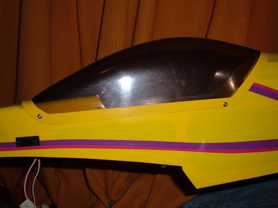

Another quick question guys:
How did you all attach your Twist canopies? Early on in the thread someone recommended Goop glue - is this the best option? I do have some, lovingly borne across the Atlantic from Canada... Or I could use UHU Por, which might be even more flexible.
I would sort of prefer to have the canopy removable though - has anyone screwed their's on?
I really wish I'd thought to buy a pilot. I guess I'll probably end up doing one of those cartoon profiles of Calvin and/or Hobbes or something. Unless of course someone can suggest a way to make a proper pilot in less than half an hour or so, because that's probably about the limit of my patience.
Thanks again, I'm almost there!
Matthew
EDIT: Btw, after consciously deciding to make the lower servo hole the rudder, I then went and put the horn on the wrong side.
Looking at the geometry, either way should be fine, but boy I feel dumb sometimes.

Matthew, I used some extra servo screws I had (4) to attach mine. On my first Twist, the canopy sit tight against the fuse at the front. This one had a gap, so I filled it with silicone.

Matthew, oil blowing back on servos has been discussed here several times. Everyone generally agrees that it is not a problem. Oil getting to the servo connector is a different story. If oil penetrates the connector, the circuit could go open and the servo would lose signal or power.

In reply to TimC. I see that you have used 4 screws to hold the canopy on. I used to use 6. But I have discovered after many crashes that the Twist will often break just behind the canopy. So actually putting a screw hole back there will weaken the frame right where it is the weakest. I still use a few screws to fasten the canopy but I am careful to not use any near the aft end of the canopy. It is an achelies heel back there. I use a few screws forward, and some clear silicone. Seems to work just fine. Jim Tucker
#3661
Jim, I never thought of that. Are my rear screws in the danger zone? I hardened the balsa good with thin CA after running the screw in to establish threads. I hope this hardened the wood enough so the hole is an non-issue.

Pat, Tim, I gave up screws on the canopy--and possible consequent weakening of the frame. I just lay in a fine thread of silicone caulking all round. Looks nice and I believe it actually improves the strength across that weak area. Not a lot, but a bit. Screws won't do that. Before my Twist #6 bit the dust hard the other day, I had an incident which cracked the back behind the canopy (easy fix with CA and baking soda filets); then one that cracked the ply just behind the forward wing firewall. Easy fixes, both. When I REALLY crashed #6, the canopy shattered... BUT EVERYWHERE THERE WAS SILICONE, THE YELLOW EDGES OF THAT CANOPY HELD TOGETHER.

I like Jacks silicone Ideas for sure, but I am a screw the canopy on kind of guy, It all started when every time I glued on the canopy the vapors would fog up the windshield, (now they make a good glue for the canopy I guess, I never tried it) one time I even remembered to put vasoline on the plastic, as not to get the vapor look, glued her on, and then realized I now couldn't get the vasoline wiped off,,, Talk about being a nit wit..
so from that point on, 4 screws hold all my canopies on and will forever.
I have built up the back behind the wing with just extra plywood bracing and much epoxy, as a matter of fact the Twist broke in its usual spot behind the wing in my last crash but not where any of the bracing was, its almost rebuilt right now, and the new needle valve will hopefully be here today or tomorrow, the first time I came in for a rough landing and ripped the landing gear off, (which I didn't really believe was that rough of a landing) I also braced and epoxied that landing gear block in, needless to say my last nose in crash didn't bother that at all, however my firewall was pushed in and I lost the left side of the most forward part of the plane, she will be air born this Saturday though, things are looking good, I was even able to save the pinstriping and had some extra yellow monocote laying around, the Twist almost looks like its Brand new out of the box again..
As far as screws in the danger zone I just run a nice bead of epoxy around the whole inside of the airframe where all the joints meet, I needed the extra weight for the balance on the OS .70 anyway, the screw holes have never been a weak point in any plane I've ever had so far, Maybe I have been lucky,, My canopies have shattered before but the holes have never been an issue or where the breaks have occurred.
