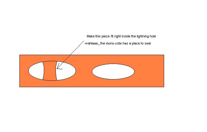

I know you were Razzin me LOL,,,, But I still had to comment,
The best thing to do for a tear in an opening i found, is grab a piece of balsa sheeting and just make a little piece to go in between the lightning hole and just Zap it on the top and bottom of the fuse hole (enough to catch the mono-cote where the slice is) just make it flush with the outside of the fuselage and you'll never even know its there.
If your worried about keeping things balanced, just cut 2 pieces and put the other directly across from the other, but with such a small light piece i wouldn't even worry about that.
Your looking at about a 4 minute fix here that looks perfect. it takes more time to find and measure the piece then it does to fix it.
