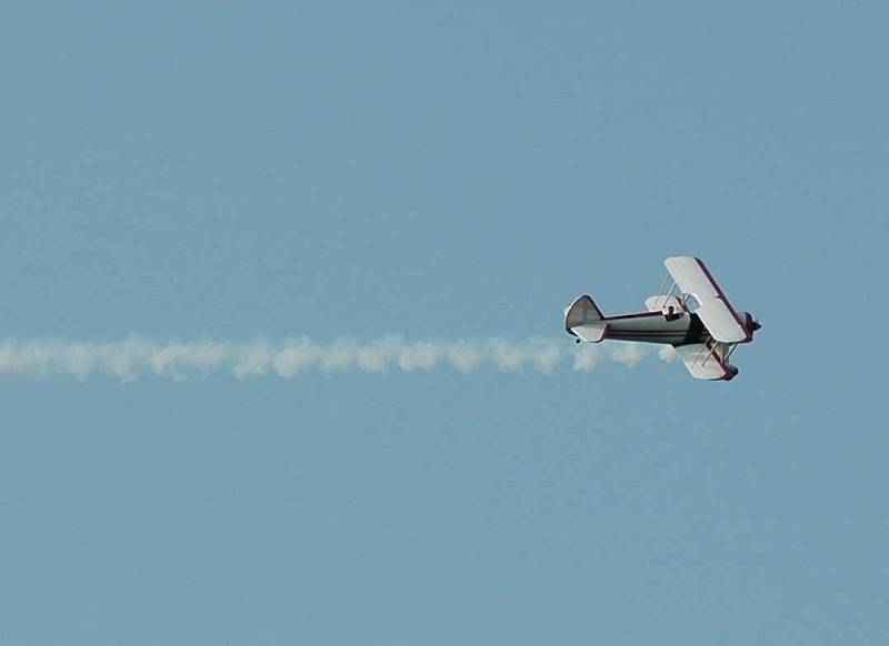

ORIGINAL: bubbagates
I also run the G26 lightened from RCIGN1. I needed nothing extra for weight. I run the Slimline smoke muffler with a smoke system so my weight is a little heavier than most but you gotta admit, this plane just screams to have a smoke system.
