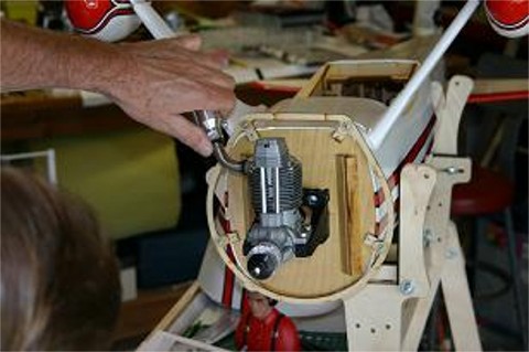

Last weekend we had a great spring day and a fellow club member show up with his Great Planes Stearman. What a beautiful airplane both on the ground and in the air. Here are a few photos I shot enjoy.

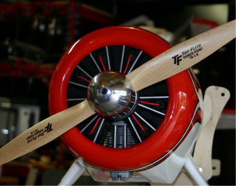

Fred, Thanks for the compliment. I had to reduce the size and compress the photos quite a bit for the site. If you want a look at a highter res here are the links
[link=http://odysseywood.us/Stearman/MG_4727-01.jpg]photo 1[/link]
[link=http://odysseywood.us/Stearman/MG_4728-01.jpg]photo 2[/link]
[link=http://odysseywood.us/Stearman/MG_4729-01.jpg]photo 3[/link]
[link=http://odysseywood.us/Stearman/MG_4737-01.jpg]photo 4[/link]
[link=http://odysseywood.us/Stearman/MG_4758-01.jpg]photo 5[/link]
[link=http://odysseywood.us/Stearman/MG_4782-01.jpg]photo 6[/link]
Sam Harbold

Great shots, Sam! Thanks.

You mean dummy engine like the PT-17 version of this plane has?
You can buy the PT-17 dummy engine as a replacement part from Tower Hobbies. You'd also need the PT-17 cowl for mounting the dummy onto, which they also have.
I think the dummy engine that comes with the PT-17 looks hideous, so I did up a Williams Bros. 7 cylinder dummy for my GP PT-17. Since I'm doing mine as an electric, it doesn't have to get hacked up to make a glow engine fit inside it.
Rick
