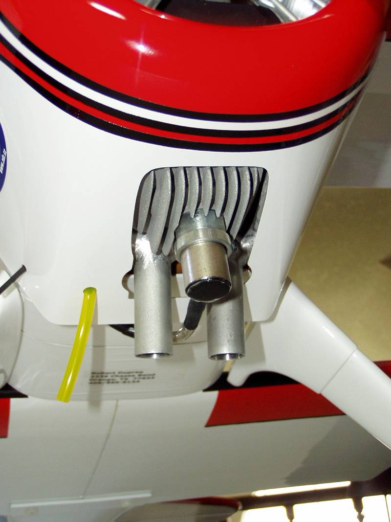

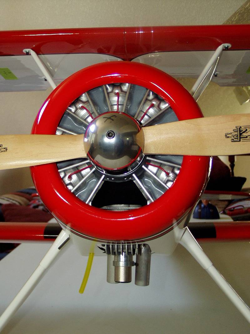

Thought you guys might like to see how I crammed my ZDZ 40 into my GP Super Stearman. Note throttle and linkage setup, custom-built pitts muffler and engine mounts, close pivot point on aileron drag links. Plane has all digital high-torque JR's. Radio setup includes dual elevator servos, differential ailerons, switchable and rotary dial flaps, idle down/throttle cut, dual rates, and exponential. I also removed original tank and installed a smaller ten-ounce tank centered over the CG. This allows at least 13 minutes of flight time on gasoline. I'll post other details later if anyone is interested.
The Duper

The duper
Please let us have more detailed pics on the zdz40 setup (especially the throttle linkage). Currently using an MVVS 26cc but have the zdz40 and have considered fitting this combo.
Has it flown? if so how does it fly?
Did the CofG work out ok?
thanks

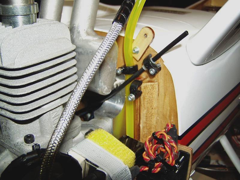

My Super Stearman made her maiden flight today. She made a graceful scale takeoff with no need to panic with the rudder. Turns required rudder coordination to get her to come around, but this might have something to do with my setup using differential ailerons. The engine was running a little burbly so I avoided any rolls or loops on the first flight. I was able to tweek the high and low needles later, and the engine idled and transitioned reliably and high speed was stable. The landing was smooth with no bounce, but I did take up all but ten feet of our six-hundred foot runway.
Attached are more pictures of the throttle and choke setup. This is a real challenge on this plane because the carb is right in the plane of the firewall! I made a box that extends aft of the firewall for the carb to keep it from belching into the fuselage. I replaced the original throttle control arm lever arm with a longer one. Because the carb is at an odd angle it is necessary to use a bellcrank and mount it so it is in the same plane as the throttle control arm. A very short control link made from two ball ends and a short piece of all-thread ties the throttle control arm to the bellcrank. I used Sullivan semi-rigid pushrod between the bellcrank and the throttle servo. I had to mount the throttle servo outboard of the servo tray.
The choke control was no easy deal either. I thought about using a choke servo, but just didn't think it was necessary. I made a longer lever arm for the choke and installed a ball end and a piece of plastic inner push rod. This push rod extends out the engine cowling immediately behind the cowl ring and is a very clean setup. I thread the fuel vent line and the choke rod through their respective holes as I install the cowl.
I access the needle valves through a hole in the ignition battery tray, but only when the cowl is off. I really didn't want to mess up the top of the cowl.
Note the use of the 1/4-turn fuel dot (Madison Components). Very clean.
