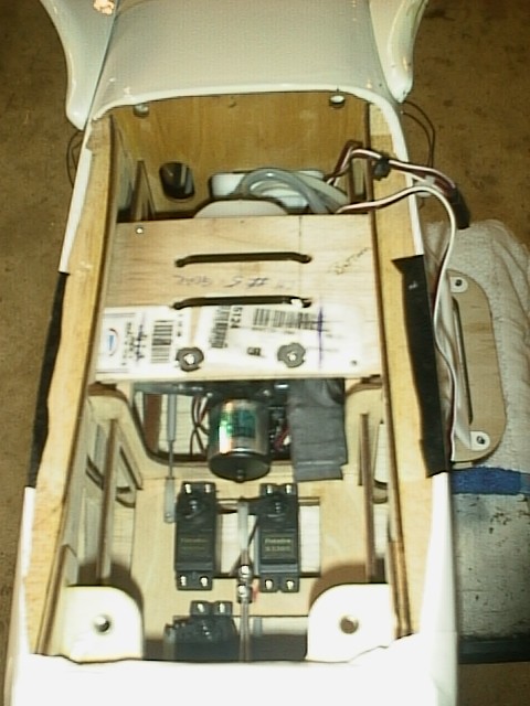

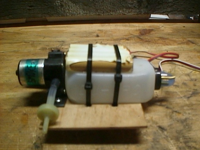

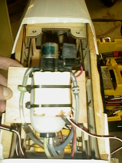

#535
Joined: Jun 2004
Posts: 103
From: Saunderstown,
RI
Here are photos of my smoke system.
Materials needed: 1 - TME Simple Smoke Unit
1 - 4 oz fuel tank
1 - 4 cell battery
1 - 6" servo extension
1 - Y harness
1 - in line fuel filter
1 - 3' length of fuel tube
1 - 4" x 5 1/4" x 1/8" ply board
2 - 1/4" x 1/4" x 4" balsa sticks
2 - 10-32 blind nuts
2 - 10 - 32 x 1/4" screws
2 - small wood screws
2 - medium size wire straps
1 - 3" x 3" foam padding
1 - exhaust nipple
Most of this I had in my building area. the Smoke pump and a gallon of smoke fuel were the only things I had to buy. That was $100.00
Here's how I did It.
Assemble all the components and place on ply board. I used tape to hold the assembly together and test fit in the fuselage. I wanted the pump as far away from the rx as possible. I also wanted the 4 oz tank to be easy to plumb and have the clunk toward the tail. Once everything fit I removed the tape, marked hole locations and drilled holes for mounting the pump and tank. I used the blind nut and screws to bolt the pump to the ply board. The wiring from the pump was attached to the Y harness. One end goes to the rx by way of the 6" servo extension, the other end is for charging the pump battery. I followed the instructions that TME provided for plumbing the system. The wire straps held the tank, battery, tube and wires together.
I glued the 1/4" x 1/4" x 4" balsa sticks in the fuselage to make mounting rails. While the glue was setting I installed the 6" servo extension in the rx in a channel that is typically used tor retractable landing gear.
Then I set the unit on the rails and assembled the plane to check the CG. This was done several times before it was correct. Once satisfied the ply board was screwed to the rails and the system was tested wings off. I set the flow rate as recommended in the instructions provided, assembled the plane and went for a test run.

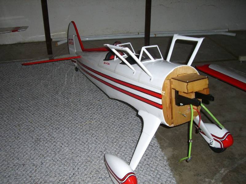

#536
Posts: 330
From: NEWPORT, RI,
Thanks for the great pics Rich!
I like the "rails" idea... as it's sort of modules and easy to remove in case you had to get down under it.
I'm probably going to go with a little bigger smoke tank, so might have a little issue getting it directly under the C.G.
I'll let you know how I make out with mine (was hoping to maiden this year... we'll see)
Here's a pic of that preheater tube I bent around the OS 1.20 header, granted, it wasn't easy (used a pc. of flex cable inside the tube, bent it around the header pipe, then painstakenly pulled/removed the flex cable from the tube while retaining coiled shape)
As you mentioned... I probably won't need this but it'll be intersting to see what it does...

#537
Joined: Jun 2004
Posts: 103
From: Saunderstown,
RI
It looks like it's going to be a wet Labor Day weekend so I"ll have time to work on my planes.
I too was thinking about a larger tank for my smoke system. If I move the rx and smoke battery's to the "lead box" in the cowl, that should open up more space in the fuselage and will put useful weight in the nose. They will have to be insulated from heat but otherwise this should work.
The battery's will be faster / easy to get to under the cowl than in the fuselage. IMHO removing the wings on this plane is a pain. I transport and store the Stearman fully assembled and ready to fly.
I like the copper preheater! I should have done this in the beginning. While the plane is apart I will install some copper tube and see if this makes a difference. I agree that this will be an interesting test.
