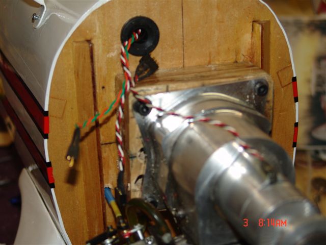

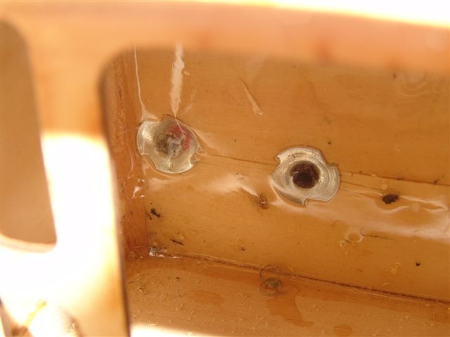

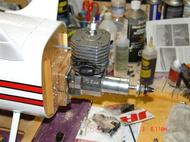

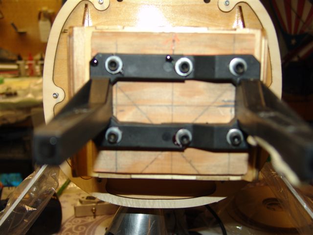

Re the wheel pants, I have blind nuts and two manchine bolts with the allen heads. re the cowl, with my first stearman that had over 1100 flights, never had a problem. after about the first 20 flights, checked everything, tightened everythings, and made sure with lock tite on all the bolts re engine to firewall and all the bolts that held the cowl. And my new one also no problme whatsoever with the cowl. can't tell you re the wheel pants as I have been flying only on skis. The pictures a couple of them are of the Brilleli engine that I am instqlling in the GP Yak 54 that belongs to my friend. This is the way I am doing it.
The other pics is of the FPE that is in my Stearman, and the last picture is of the plane taken yesterday.

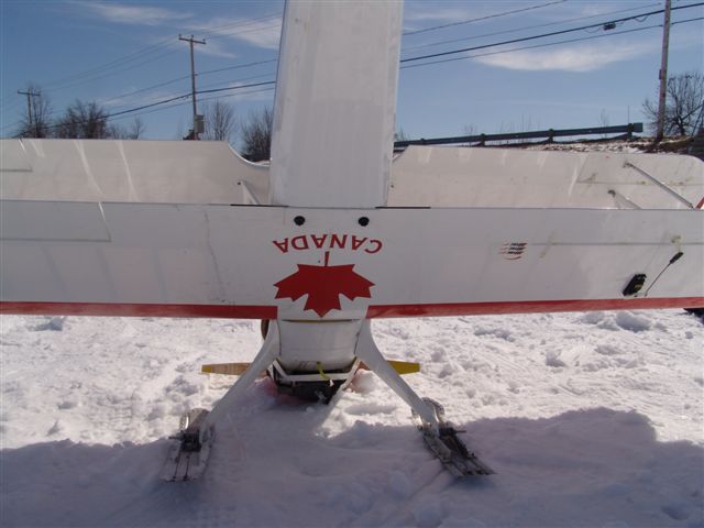

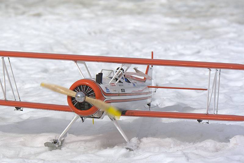

Was out today, a friend came by with his dog. Also wanted to show you my Canadian Maple Leaf on the bottom wing. Beautiful day today. Sunny and no wind. put in 5 flights.

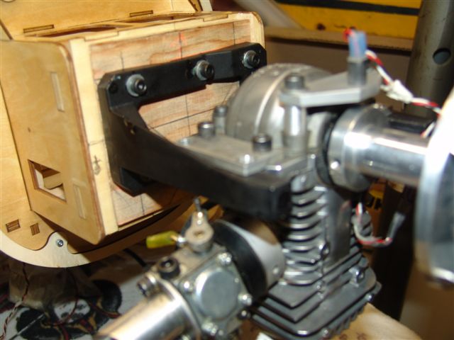

What size engine is that Brillelli?
Old 03-21-2007 | 07:48 PM
  #807
mga
Joined: Mar 2004
Posts: 223
From: kirklandquebec, CANADA
Default RE: GP Super Stearman
46cc

Thanks for your input mga. I changed the wheel pant screws to blind nuts and machine screws today. I will take your word for your experience with the cowl and leave it alone. I have had four different Brillelli engines, a 25 cc Toro conversion, two 40 cc SPE conversions and now a Brillelli 46 that will go in my Hanger 9 150 size P-47. My experience with Brillelli engines has been excellent. Scott has done an great job on all of my engines to date and his service and support are the best in the business. Mga is sure making me jealous with all his good flying days on the Ol' Super Stearman. I can't hardly wait to get mine in the air.

The Brillili belongs to my friend who I am building the plane for. I must admit, that Scott has backed up he product. At first it was a magnito and it did not really work that well. Scott said send the engine back, and he changed it to electronic ignition plus did other mods (improvements especially to the carb attacthment. Since then this engine has run flawlessly. That is why he is putting it in the Yak 54 by GP.

You may want to think twice before mounting it on a composite engine mount. I know that Scott over at Brillelli reccomends metal mounts. You may find that that mount will break before long.

The person I am doing the plane for, has flown another plane with the exact same set up and it has lasted 100 dreds of flights. I myself is concerned about it, but that is what he wants.

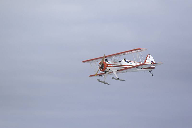

Hi guys, well, yesterday a friend of mine Greg Patterson who owns one fantastic camera, took these shots of my Super Stearman in the air, finally. So I am posting them as I feel they are great pics and the results of the decals on the Stearman look great in the air, especially the red maple leaf with Canada on the bottom wing. You can really see it. Also as you can see we had a couple of inches of water on the ice yesterday, but that does not deter us from flying. Hope you all enjoy the pics.

great pics.....what camera?
if it's a Canon 5D or 1DMKII.....he should have shot with a bit slower shutter speed so the prop doesn't look like it was stopped.
