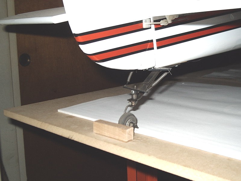

Hi,
I’m in the process of installing the rudder and tail wheel. Does anyone have any comments or suggestions concerning the tail wheel? Is anyone using a different setup?
What do you think about that goofy setup with that little triangle piece at the bottom of the rudder? Seems like it could have been done more simply and stronger. How does it hold up?

Default RE: GP Super Stearman
Dont use the stock tailwheel, get a leafspring tailwheel for it. I got one for a 15 to 18 lb plane.
Epoxy the triangle piece on, it won't come off. I cut a groove in that piece, and have the tailwheel spring holder bracket epoyied to it. It aint come off yet, and I doubt seriously that it even will. I'll post a pic in a minute, I need to take one for you.
