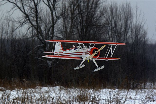

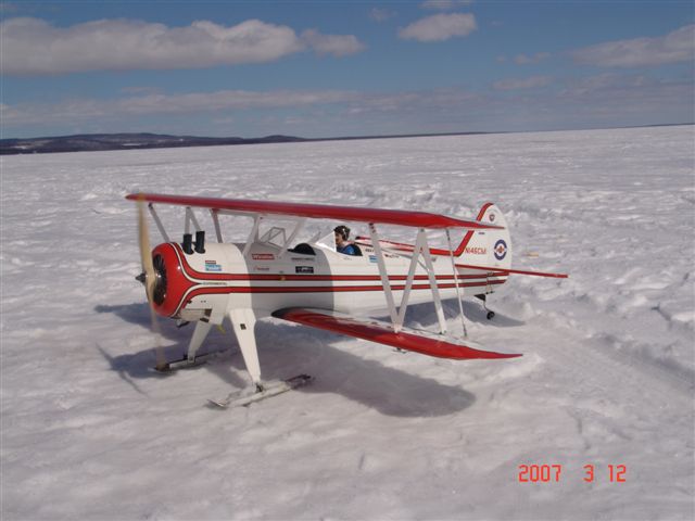

Hi guys, well, I put in the first flight yesterday all she needed was some down trim, then the freezing rain started, so that was it. Today, beautiful cold sunny day. put in 3 flights. Winds 18 miles per hour, and she flew just beautiful. I repeat that she has a FPE 40cc and weights 15 1/2 lbs, 3 pounds less than my old Stearman. I hope I can get as many flights as the old one, over 1100 flights. I again put many decals on her. I just like the look. I will try next time out for someone to take a picture with my camera of the underneath. I have a neat looking big red maple leaf, with the letters CANADA under it. It really stands out.
The landing is really like landing on feathers, very soft. nice roll rate. I have not open up the engine yet, flying her at a little above half throtle. Anyway, great plane, great kit and a great flyer. Great Planes should win an award for putting out such a great kit.
Oh, for those that wonder why I have the muffler sticking out on top, is that with the other stearman the first year, flying on ice, the pipes would sometimes hit clumps of ice, and bend. by reversing the muffler no more problems, so I did the same thing to this one. Plus it looks pretty neat and once in the air, much quieter.

What are the dimentions on the Jay Dee skis you have on your Stearman. I too like winter flying and would like to install some skis on my Super Stearman. A freind has some Jay Dee skis that I can get if they are big enough.
I am also thinking about installing floats on mine. I have a Zenoa G-26 on mine and a smoke system.
Doug. (Member of MOFFA - Mostly Old Float Flyers Association.)
Old 03-11-2007 | 10:08 PM
  #786
mga
Joined: Mar 2004
Posts: 223
From: kirklandquebec, CANADA
Default RE: GP Super Stearman
they are 12 1/2 long by 2 1/2 wide. Have never had a problem with them re any type of snow. The only problem I have had with them is the wearing out of the metal, as I fly often just on bare ice and that really wears them off. I pop riveted a brass piece on the bottom and also an L angle aluminum bar on the top so that they do not bed any more. As the ski wore they started to bend very easily.
Re the G26 on floats, I am wondering if that will be enough power, as the suction of the floats. on snow or ice that is not a problem. I have a FPE 40 cc and in deep snow I can tell you it really comes in handy, as the skis are at least an inch under, so you really need the power. If you can get a bigger ski it would even be better.

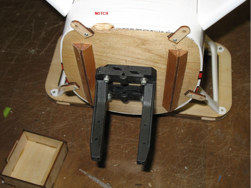

For any of you who installed a saito 150 in your stearman did you have any problems getting the stock muffler to fit.I installed my engine inverted but the muffler hits the cowl ring no matter how I try.I could make it stick straight out the side but that would look dumb.I guess saito makes a right angle adaptor but horizon wont have any for at least a month.Do any of you know if anyone else makes one?Thanks
Old 03-12-2007 | 04:36 PM
  #789
Joined: Jul 2005
Posts: 70
From: Rochester, MI
I've got the Saito 150 mounted inverted with the muffler straight down. I had to dremel a little of the firewall at the bottom to make it fit (didn't have to take a lot). If you want, I can send a picture.
Ed

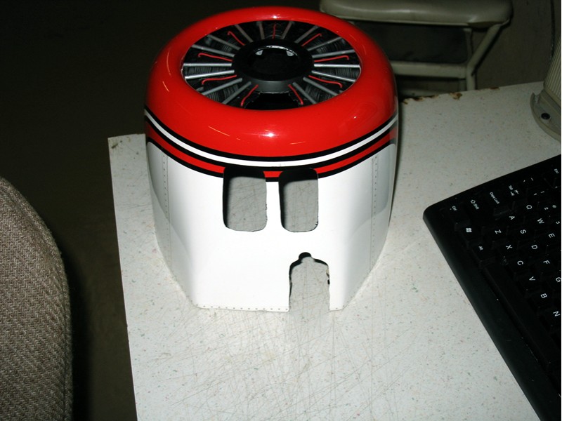

I mis spoke about the ring clearance. I had to remove a portion of the ring ... pics attached.
When the cowl is mounted it really looks good.
