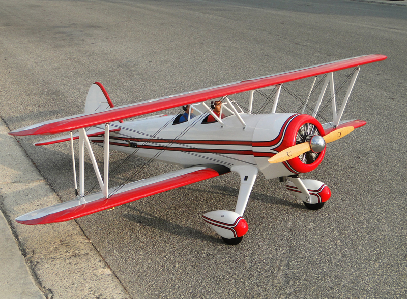

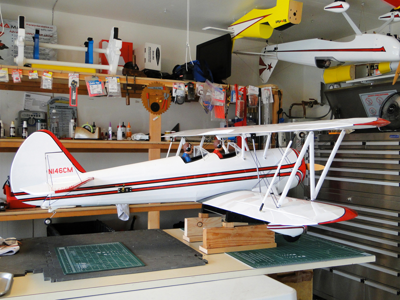

I started monitoring this thread in mid-2010, and started posting in 9-2010, when I bought my own GP Super Stearman. I've been working on it ever since, and it's now completed. I used Robart pin hinges, and found out they can be difficult to use on the GP S-Stearman wings because they have a ply plate running through the exact center of the control surfaces. Makes for great strength on an aileron or elevator, but it makes for a difficult installation of pin-hinges! It took some determination, but they went in.
The engine is a Syssa 30CC gasser. I already have a Syssa on my Giant Super Sportster, and I can tell you it's the nicest engine I've ever owned. It flies my GSS all day at half-throttle, pulls it through any aerobatics I can think of (No, I don't fly 3D). Plus, it looks like it should be in a museum, the workmanship is so nice it should be art. My reasons for using it for the Super Stearman were not as exciting as all that. The weight of the recommended engine for the Stearman, plus the recommended (19 ounces?) of lead to be placed in the nose added up to exactly what the Syssa with all its gear weighs (41 ounces?). I already had a Syssa, and knew how nice it was, and how dependable it is. It provides a dramatic increase in horsepower, provides a larger, more scale-looking prop, and it's the correct weight. Plus, YouTube shows that gassers are very popular choices for power in these Stearmans. It turned out to be a superb choice fit-wise. I'm very pleased with all aspects of the installation. The Syssa is a very "neat" engine, with a slim shape. It's very compact, and designed to fit within narrow cowls like the Giant Super Sportster, so you can imagine the room left over in the Stearman! Can't wait to see how it powers the Bipe.
I abandoned my plans to use a single servo to power both elevators, after the 2-into-1 linkage I ordered from Central Hobbies had servo linkage holes much too large for use with the linkages. Turned out the linkage was designed to be used with other stuff they like to sell. I ended up gutting the belly and tail, and removing a half-ton of extraneous stuff that I would no longer need. Yes, this DID involve cutting out the stringers and rebuilding the belly afterward. It sounds much more difficult than it actually was. It was fun to do some "old-style" building, buying some balsa stock and building the belly. It turned out not to be a big deal at all. While it was open, I added a few reinforcements to accommodate the addition of three servos back along the sides. I elected to use a couple of JR ST126MG servos for the elevator halves. They're sport servos, but very powerful, and much more than is needed for each half. The rudder is powered by a JR 3611A, which formerly was destined to power the 2-into-1 elevator linkage. I used Central Hobbies carbon fiber linkages, 3/16", and the ends were 3/16" X 4-40 thread. Carbon fiber isn't required here, but I had the makings for the linkages around, and they're nice and light, and strong.
I threw away the stock elevator and rudder control horns and went with DuBro 493 adjustable control horns, which are comprised of a single screw that goes through the surface, anchored by plastic pieces on both sides. Much stronger than the originals, and I wanted something I could trust, especially on my elevators. I mount the 493's, trace around them, remove them, and cut away the covering under them. Then I soak thin CA throughout the hole inside, allowing it to soak in and harden the entire area around the control horn. Then I install the 493 again. I finished up by using Sullivan black plastic clevises (can't remember the number) with locking clips, and so made the linkages as bullet-proof as I possibly could.
I always raise my wheel pants above where they are designed to go, because wheel pants can get knocked around pretty easily. I did whatever mods I needed to do for that. I usually use SIG wheel pant mounts, and they make the pant easy to mount and dismount later on. I also went to a larger wheel, and more than a third of the wheel protrudes from the bottom of the pant, so it shouldn't encounter any problems even on a field with some bumps.
I went ahead and built the dummy radial, and it looks awesome. The plane is ready to go to the field. I hope to post with some good results soon. I don't know if I can get anybody to shoot any video, but I'll do what I can. In the meantime, I'll look around here, I believe I have some nice photos of it, both together and part, with some close-ups of the engine application and the radial, etc. If I can find them, I'll post them.

And I'll add a few here as well.
Notice under the stringers, you can see the remote JR Rx, placed well away from the main Rx. Also, I forgot to mention that I removed the balsa block in the back and hollowed it out. There was a lot of wood there. I also used a Sullivan tail-wheel assembly, because I always do that on every plane I build. They work great.
I built the gas tank from a Fiji water bottle. The little smiley-face I painted on the bottom of the tank is there so I see it when I install the tank. If the face is smiling at me, the bottom of the tank will be the bottom when the plane is placed upright and filled with gas. Nothing worse than putting a tank in upside down and then, at the field, wondering why the fuel is running out the vent-line!
And finally, I added a red stripe on the belly, because mine has to be a little different, and it clearly differentiates the top from the bottom.
Hope you like them!

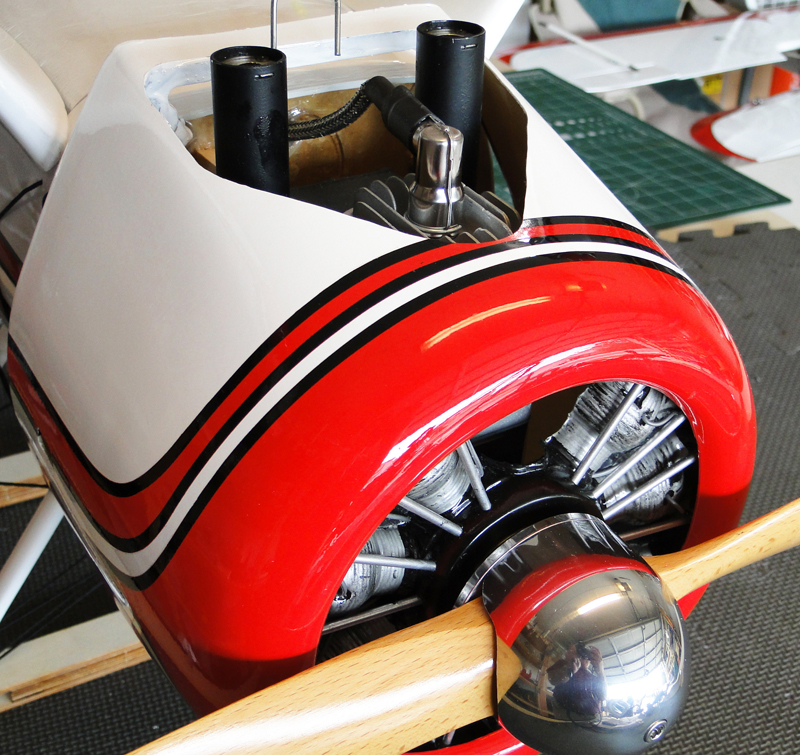

Thanks for the kind words! You guessed it on the wire; it's my choke lever. Simple and effective. I thought about a servo, but it just wasn't necessary. Once you apply the choke on a Syssa, and it pops once, you flip the choke off, and the engine starts - every time. I run the wire out through two pieces of wood, slightly offset from the wire center and each other to create tension and hold it firmly. I also made a little "bump" in the wire right on the outside of the block when it's in "choke off" mode, to secure it. Old-school linkages.
I'm a big fan of the Syssa, because it comes with so many of the extras you would end up paying for with the others, it really doesn't cost that much more. It comes stock with a pitts muffler that comes set up to add smoke. That's what you're seeing in the photos above. Plus, it's made right here in the good ol' USA, in CT, by a guy who responds to emails and does turnaround service that beats anything I've seen. And when an engine model at the factory is upgraded, you can send yours in for the upgrades, which (to date) have been FREE to me every time. I only pay for the shipping.
I've heard from the other guys that the DLE 30 is a fine engine, and runs very strong. A few problems with the aftermarket mufflers cracking and such, but I haven't heard of too many. The engines themselves seem to have minimal problems, and since the DLE and the Syssa guys are always arguing over which one has more power (the Syssa does - yuck-yuck), either way it's safe to say you'll have all the power you'll need.
I'm glad you liked the "Building with Jim" video on the Robart pin hinges. I hear he's a heck of a guy. ;^) Others have different names for him, of course. :^)
I'm using an 18 X 6 prop. Some of the guys with the DLE's run 19 X 6. To me, they sound like they're lugging a little with a 19 X 6. I tried one on mine (in my Giant Super Sportster) and it also sounded that way. For the Super Stearman, I'd recommend the 18 X 6 wood Xoar, which is what I use. Gives you a little more ground clearance. Remember, the GP Super Stearman was designed for a motor like a Saito or O.S. 1.20, which would run a 16-inch prop, max. Because of the needed nose-weight and the big cowling on the Super Stearman, we can cram these gassers in there, but it's only so far from the crankshaft to the ground!
If I take the cowl off any time soon, I'll take some "under the hood" shots for you. I'll look around and see if I took some when I finished. I might have some around here somewhere.
Before you start yours, decide what you'll want to do for controls in the back. It's easier to open the belly before you have everything built onto the fuselage. It's a fun project, and the instructions are pretty good. There are also guys who have done building reviews on theirs, and that's another source for some good ideas. Building the dummy radial is easy and fun, and it inspires you to keep going. The photos I posted should give you some tips and ideas on that. I went out and found some light gray wire for mine, smaller than what they provide, because I looked at the wires on a real radial. They're much smaller.
Well, I s'pose I should write a book or something. . .
~ Jim ~[8D]

Yes, you're right, I DID have to carve out my spinner for my Xoar prop to fit. I used my dremel tool, and it was slow going. I didn't balance it afterward, but I did try to make sure my cuts were consistent on both sides. I don't know as I've ever balanced a spinner before. Good thought. I should look into that. I've seen a video on it, on YouTube.

The Syssa was the exact weight needed for the Super Stearman's nose. No lead, not one ounce. The photo above shows it on the CG machine, nice and level.
I wasn't about to use the linkages that GP provided, or the flexy tubes they ran through. That's ARF 101, rule 1. "Don't use the linkages the Mfr supplies, unless they're Sullivan or Goldberg, or DuBro, or Central Hobbies (aftermarket quality)."
It's a fairly expensive ARF, and the Syssa is an expensive motor, so I made sure to use beefy linkages made of carbon fiber, and strong servos. I'm planning on flying it for a long time. Visuals come second to durability; within reason, of course. The stock setup used in the GP Super Stearman leaves much to be desired, and in my opinion, places the model at risk.
Full-scale planes often have linkages visible.
Beyond 25 feet, those servos are all but invisible. On a moving model, even more so. I stopped doing scale many years ago. Too much effort to create a model that weighs far too much to fly well, and there's too little return for the effort.
Those servos are accessible clear back to the control horn on the surface, so I can preflight them easily. On the ground, the linkages are under the stab. Very little shows. Look under the stab of a full-scale sometime.
