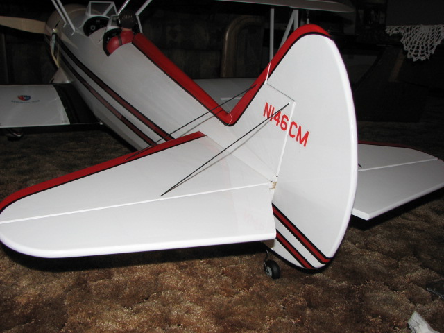

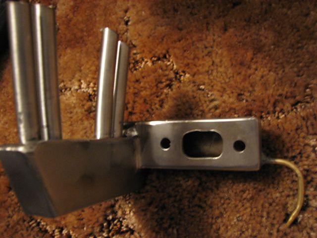

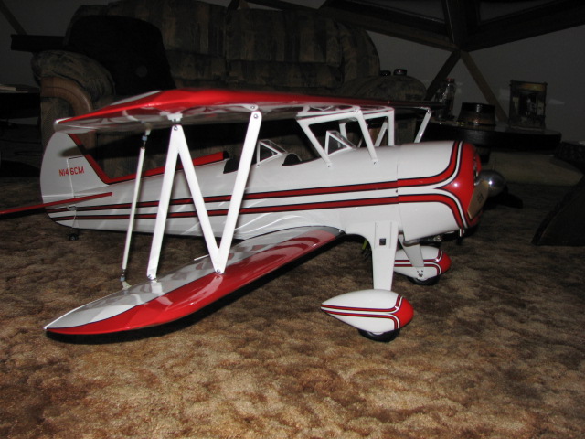

LOL moving south sounds like a good idea when it's this cold out. It's -33 C here this morning. Add a little wind and you need to dress up like a polar bear to go to work. Here are some pic's of my stearman.

Les, Did you TIG weld that muffler? You did a great job! I like the way you did the smoke oil tube going in the muffler with the small holes. You need to get a snow ski set for your plane. Then you can fly more. Would that engine run at 32 deg. below? It has been 45 deg. at night and I thought that was cold. Stay warm and good luck

Default RE: GP Super Stearman
Capt. a TIG would be the answer, but I did it with stick and 1/16 rods at 45 amps, the material is 18 guage accept for where it bolts onto the engine it is triple thick there. It was a painful experience to say the least but I am happy with the muffler. I ordered a tip drill set for cleaning torch tips holes out and it has very small drill bits that you just use by hand. That brass tube is only 1/8 so you get some idea how small those holes are.

That Aerovate 45cc looks great in your plane...I bought one from Henry 9 months ago and have been running it in a gp 27% caps.....best motor I have ever owned...Just give it a chance to get broken in.....2-3 gallons

I am happy to here these motors are good, it's my first one. It must pull the cap around pretty good. I have the cap also but I put the OS 160 in it and it's alot of fun to fly. Do you have the stearman as well? If so how does it compare to flying the Cap 232.
