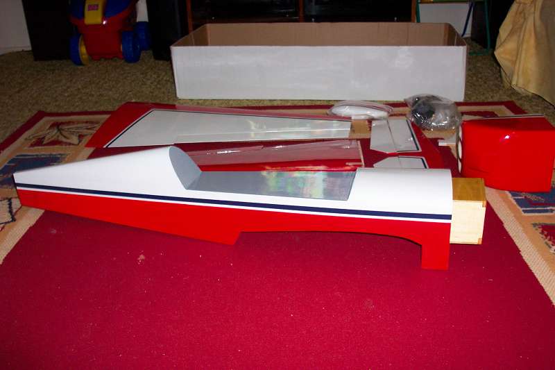

Just got my ESM extra the other day and it has to be the best plane that i have bought so far,quality of the wood is exelent, and it is very strong yet very light.The colour match for the cowl is spot on and the pin stripping is in a straight line to the fuse.Landing gear looks to be powder coated alloy,very strong yet some flex.cant wait to get my os 50 to go in it.Crosses fingers that LHS has it in stock..
currently running a black horse extra witch has had a hard life and was after something with a bit more quality to it, and so far all signs look good..
Any one have an ESM model or a 300L extra care to make any coments about the way they fly or any building problems that i might have. As the manual is pretty sad but the black horse one was no better.
Any way i'll post the build up pics as i go and as the maiden comes closer ill let you know how she flys..

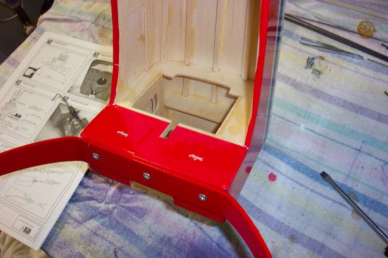

Went for a diferent way of fitting the wing belly pan..In sted of epoxying it to the wing ive made it removable by putting 2 paddle pop sticks on the front of the BP and slotted the fuse for them to fit into when the wing has been mounted.. On the wing mount ive added some triangle stock for the rear of the BP to be screwed to once it has been pushed in to the slots at the front..

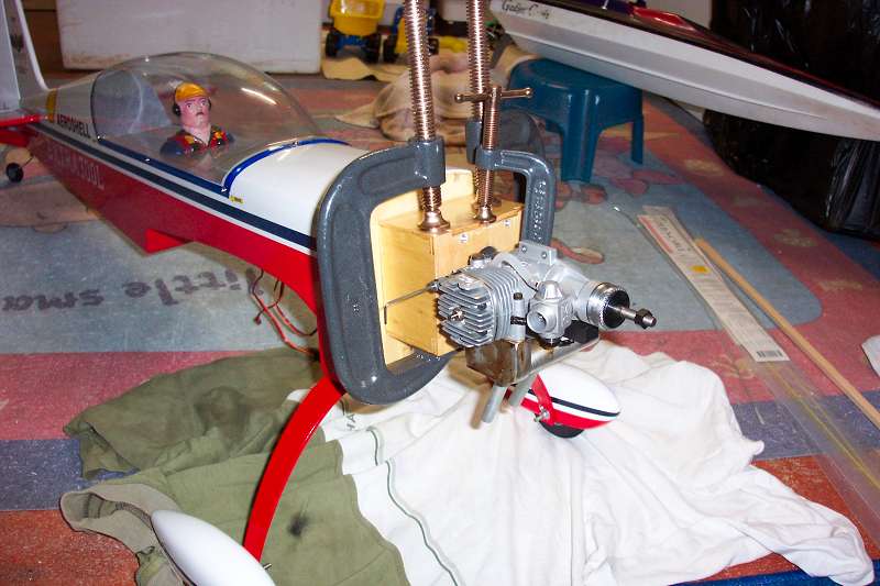

Ok some more pics. Engine is fitted up and mounted 90' insted of the 30' from vertical as stated in the manual..It was that way so a bigger std pipe would fit in the cowl or atleast down the centre..

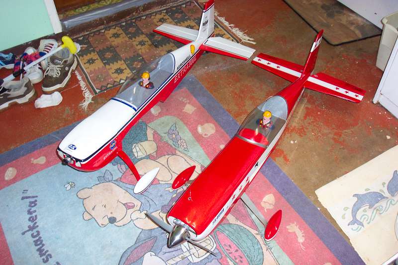

Here is the ESM extra up against a Blackhorse extra. Sizes are pretty much the same but the BH has a higher rudder, but the ESM makes up for that in area with alot more length to it.Stabs are the same size but like the rudder the elevators offer more area.

It might come back down as im having a few problems with fitting the tank,the motor mount bolts are to long and stick through the fire wall to far and i cant push the tank in the hole as it hits the bolts.I need to get some that fit flush with the back of the fire wall for the tank to fit.( and that is going to be fun)

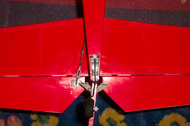

It is a pain but im getting there. cables are in and clevisis soldered on the rudder end. Just need to do the servo end and that will be them out of the way.

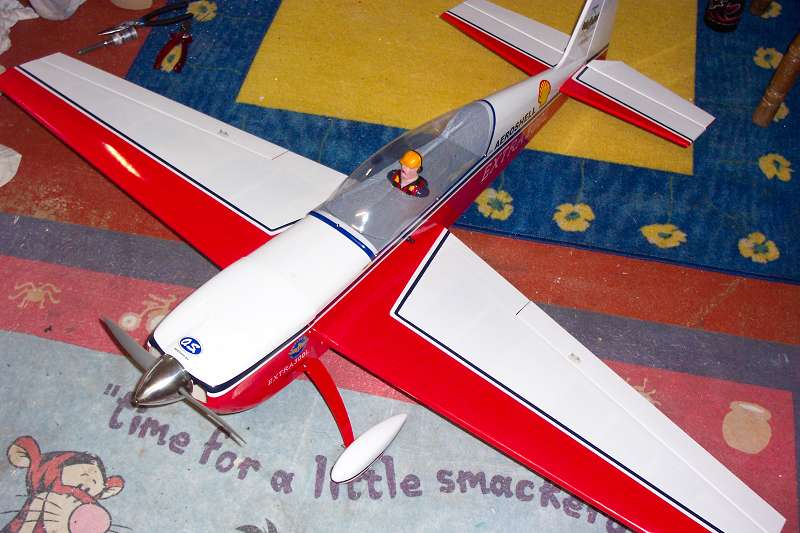

Ok she'll be ready for tomorow,or today should i say.Once the push rods were done it was a breeze to finish it off.
The receiver and bat still need to be rapted up in foam but thats a quickie.
Control throws will be done in the morning, as will the CG.This plane feels a bit lighter than the Blackhorse extra i have so it will be good to get it on the scales to find out by how much.
Glad i went with the pull-pull setup on he rudder as it is super light weight,but also works alot better than the push rod setup that the manual wants you to put in.
