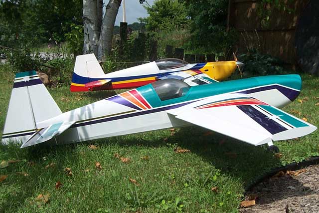

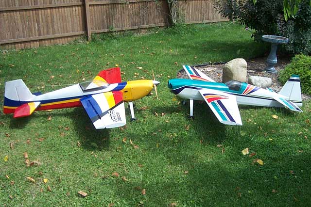

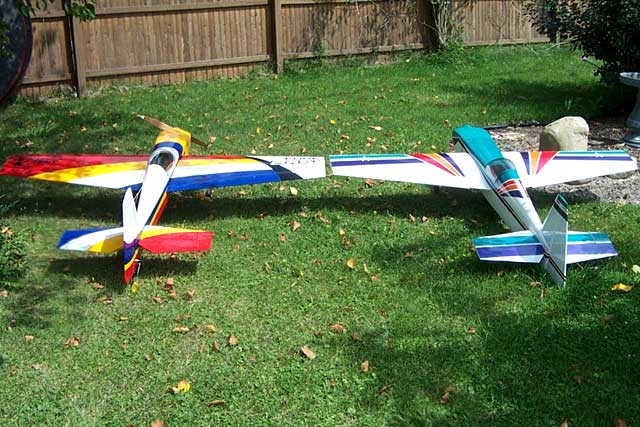

Well I got lucky... lookie, lookie!
I took some pics of it next to my buddy's WH Edge...
It is lighter for sure... good construction and excellent finish.
I weighed it "quick-assembled" with all the extras inside the fuse...
Right at 10 lbs... perhaps 1/2 ounce over...
So YEAH! We are talking 15.5 lbs or so all up is easily doable!!!! YEE HAW! I'm so excited I can't see straight.
Only problem is... I have way too many projects/jobs to get done before I can start, so I'll defer the first flight reports to someone else....
Check these pics out... Mine's the teal scheme and I like it alot...
As you can see in the pics... the WH has a little more wing area, but not too aweful much. Overall the WH seems a smidge larger.
With the wingloading the same, the real difference will be the 2 lbs less weight on a 50cc engine... that's a ton more power.
Overall very impressed. Two things I don;t like.. the tailwheel seems monsterous for this plane (will go carbon fiber anyway) and the wheel collars use set screws with slots not hex... and one was stripped already (the threads in the collar)
Other than that... top notch ARF.

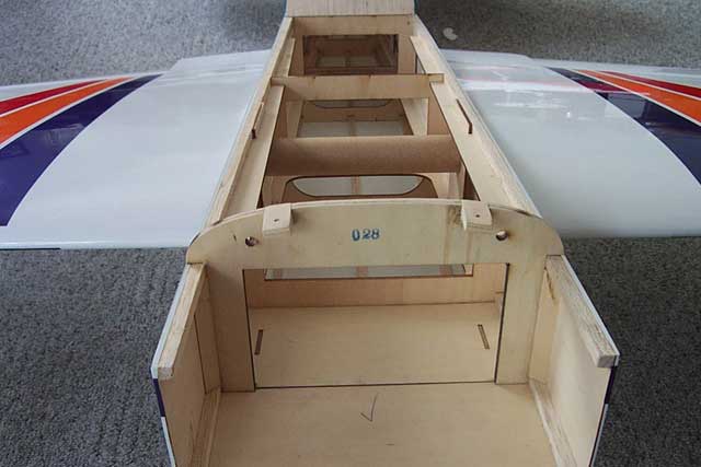

I do like the canopy of the 540T over the one-seater 540... but it's a minor personal thing.
And as Ronk reported... the correct distance from firewall to front of drive shaft plate is 6 5/16"... tho not set in stone... in other words you have leeway to move forward as this distance places the cowl with 1.5" overlap of the fuse...
If for some reason balance seems to be an issue, I'll move my engine out as much as 1" to compensate.
Looks like there is just enough room for a canister install too...

It may very well be the scheme differences too...
While it seems noticably smaller in some of the pics, in person the difference is harder to tell...
I took the following measurements as a comparison which actually show the BME Edge to be larger in most cases:
___________________________________
I measured both Edges from tip of rudder to front of cowl :
The WH Edge is approx. 73.5"
The BME is approx: 75"
The widest point on the cowl on the WH is 9" and the BME is 9.5"
The width at the front former on the WH is 8.5" and the BME is 9"
The stabs at their largest dimension:
WH is 15 1/8" wide by 11" deep
BME is 15" wide by 11.75" deep

I think the 3rd pic in my first post wingtip to wingtip shows them very close in size... and seems to look the most "real" when compared to how they look in person...

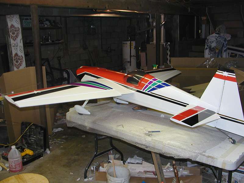

OK here's the red one! Hits- packaging, parts fit, good construction, weight is 10 Lbs with all that comes over all very nice. Misses ditto on the hardware Maudib and you can't tell from the photo but the white on the cowl is yellowed but a little auto paint will fix that.
