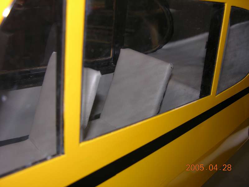

I plan to put an interior in it, I have seen an ad for an interior kit for the DPM PA-18 listed in R/C Report, (not sure if I will go that route yet). I also plan to paint my trim color per a Piper stock paint job, red on white.

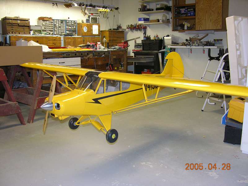

Some info on mine...I've been off the forum for awhile, just catching up. Flew the maiden flight on Sunday, flew like a champ..I mean a Cub!..One click of up elevator and it was hands off. I have a brand new OS 160 twin in it and it started right away and idles at 1100 RPM and revs up to 7300 on an 18-6 Zinger, right out of the box at the inital needle valve setting! I think the OS 160 twin is the finest engine in the hobby. I originally planned a Saito 182 twin, but those twin carb needle valves through the top of the cowl and awkward firing order turned me off.
The cub weighs 16.5 lb with no balance weight needed. It has a EDR 103 glo driver and battery under the fuel tank, and Rx and 6 volt Nimh flight battery, Hitec 645 servos on rear cockpit floor as per plan. I made some simple seats and lined the cockpit and aft compartment with vynyl material from WalMart. I mix 20% rudder with airilon, no differential. The throws were set up as per instructions, right on, maybe a little much on airilion at the high rate setting. Plenty of power, 1/2 flies it realistically. Super stable in landing approaches, flares and touches down like a feather. I am really liking this airplane..great to build a dream to fly. You wont be disappointed!!

Some Pix..
Hanging on the balance wires, cockpit detail

Sounds great Ric, what happened to the pix?

Looking good Ric! I see you closed your interior back end in similar to what I did, very nice.

The interior kit was listed in the Toledo 2005 review in R/C Report (pg 70, June 05 issue) says it fits over the servo tray. It is available from Dynamic Balsa, and includes two seats, instrument panel, both side panels, the cargo shelf behind the rear seat, floor, sticks, and rudder pedals. Price listed says it is "about $100".

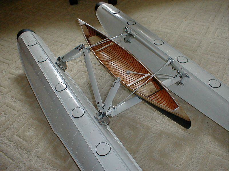

Well here's the latest thing to add. Will have to rework the cross braces to fit or mount to side of supports, undecided if I should I mount it up or inverted if I mount it here.

I vote for the Canoe to be inverted. Would not collect exhaust residue and would be more aerodynamic.
looks like your getting near the end of the rainbow.

I'm kinda leaning that way Pete. Gonna rebuild my crossbraces maybe this weekend. I'll get this thing finished eventually.

Well I have been paddling a canoe in moderate white water with wife child and friends for 30 years. I store it inverted under our deck and I carry it on top of the van inverted. Once I put the canoe on a trailer for a Hobbie Cat sail boat inverted. When a canoe fills with water its VERY heavy so any one who paddles knows to keep it inverted when not in it. Sometimes it becomes inverted while your in the canoe but we will not go there[:@]
Looks Great!!!!
