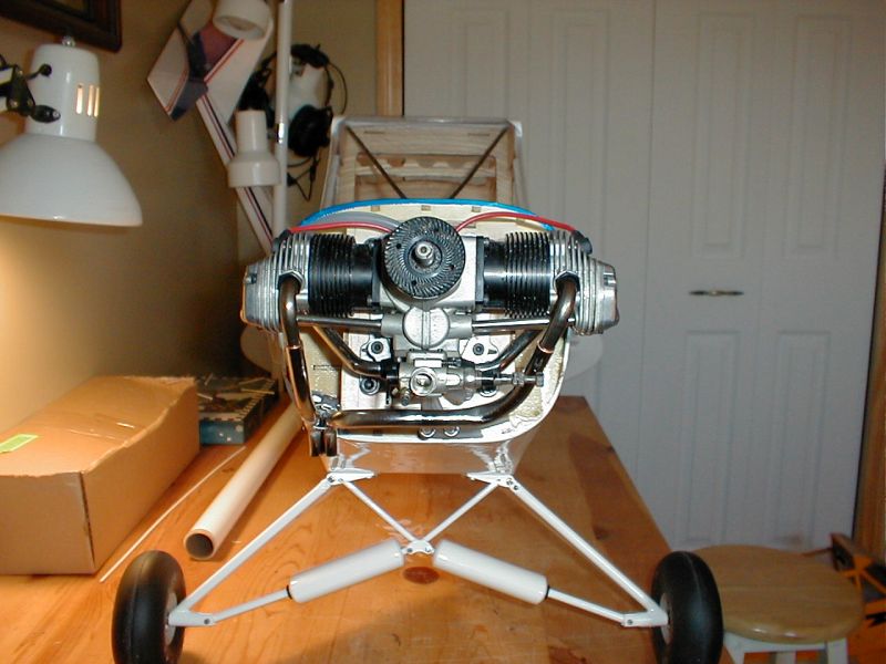

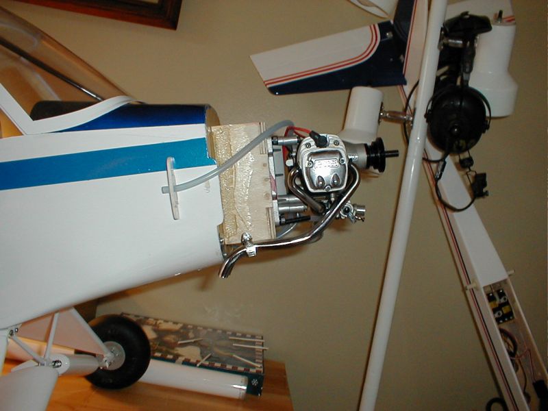

Old 04-15-2005 | 12:17 AM
  #459
Bud Faulkner's Avatar
Posts: 897
From: Mt Airy, MD
Default RE: Dave Patrick super cub
Jim,
I'm on the thread for the long haul, may be a little slow logging in from time to time due to work but i'm staying!!
Howard, if Jim doesn't mind my jumping in I have some pics of mine and Jim said this is what he did. Info on material is on post #367 and one picture. The material is bathroom plumbers pipe that hooks up to the water closet and is available at home depot. I have new front and side views now. This is of course if you're using the O.S. 160
Bud

Old 04-15-2005 | 02:03 PM
  #461
Posts: 271
From: westerville, OH
Hdkeney, buds right , thats the stuff and thats how its done, Ive used permitex sleeve retainer the green stripe to lock them on and they dont move its avaible at napa stores,

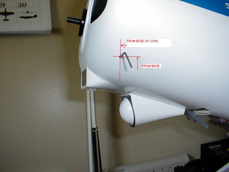

Old 04-28-2005 | 12:15 PM
  #466
Posts: 897
From: Mt Airy, MD
For those of you using the O.S. 160FT that do not want a large hole in your cowl for the needle valve (I hate holes in my cowl) here's how I did mine. Some of you may already have done this but having the cowl curve under and measuring correctly can be a bear! Put the cowl on using the cowl screws and then place a piece of tape vertically onto the fuselage at the end of the cowl.
Remove the cowl and measure from the tape to the center of your needle valve. Now place the fuselage on a hard surface...not a rug...and measure up to the center of the needle valve. Put the cowl back on again with the screws and using the first measurement you got from the tape measure out again from the edge of the cowl and mark with a pen. Now using scrap balsa or a small dowel (I used a 1/16" dowel) cut the dowel/balsa to the length you got from the hard surface and hold it up to the cowl and mark again with a pen at the top of the dowel. Double check and drill a small hole and it should be right on. Sorry i've been away from the thread lately but between work and waiting for parts to finish my cub i've been a little busy.
Bud

Old 04-29-2005 | 02:57 AM
  #467
Daniel-EL's Avatar
Joined: Mar 2005
Posts: 359
From: Maumee, OH
[&:]Thanks, Bud...think I'll do the same. I decided to go with the OS 160FT rather than my Saito 130 - I always wanted a 160 twin anyway! It's now on back order along with my DPM Super Cub - should be here in May-June time frame. I also got the EDR-103 glowlite package and the Keleo Exhaust headers (I'm not as handy as you with the pipe bending). Can't wait for these packages to arrive- this thread has gotten me revved.
BTW, what do you do if your idle needs adjusting? Did you cut a hole for that?
Old 04-29-2005 | 08:14 AM
  #468
Posts: 897
From: Mt Airy, MD
Hi Daniel,
You'll like the EDR-103, very nice unit. I didn't do any hole for the idle adjust, was bad enough having to drill a hole for the needle valve and a vent area in the bottom but then the real one had a vent opening. Never really had a problem with the idle adjust once it was set but if I need to I'll adjust with the cowl off and see what happens with some runups. Worth the wait on the cub, I ordered mine in December and got it in july. Keep us posted.
Bud

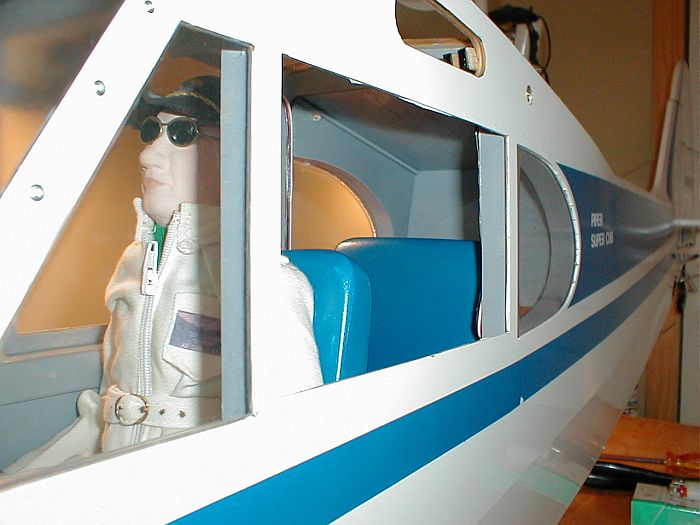

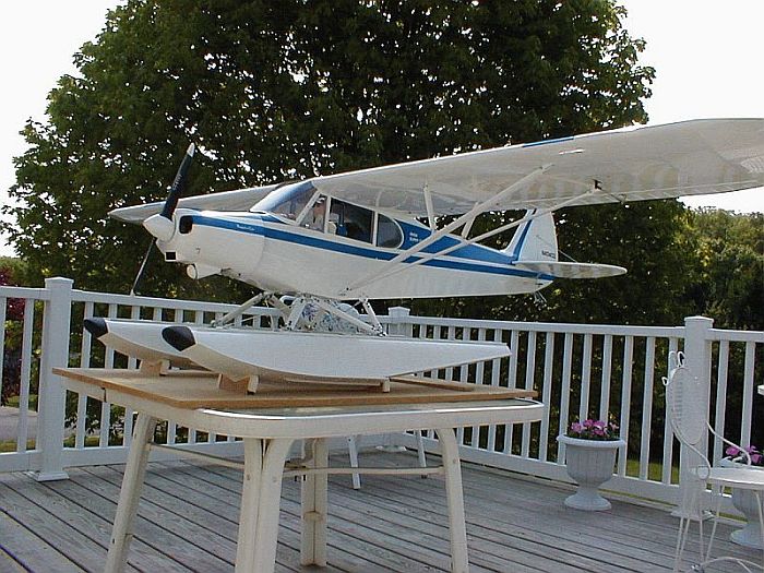

Old 05-14-2005 | 10:06 AM
  #472
Posts: 897
From: Mt Airy, MD
Well...I've made it this far. Have to add water rudders and cable yet for floats. Then it's back to wheels and check all throws again before maiden. Got my instrument panel yesterday so the interior is all done. Hope everyone is enjoying theirs and waiting to see some new reports.
Bud

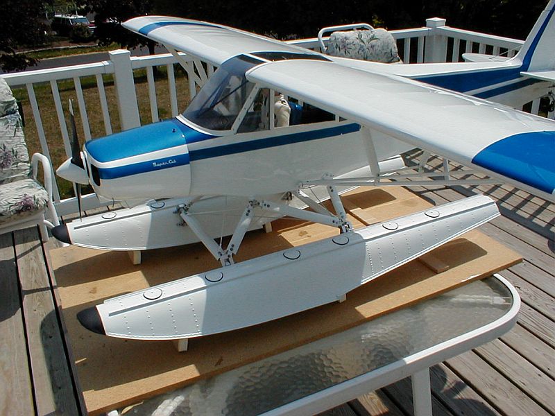

Old 05-14-2005 | 10:58 AM
  #473
Posts: 897
From: Mt Airy, MD
One more.

Old 05-14-2005 | 06:33 PM
  #475
Posts: 897
From: Mt Airy, MD
Thanks a lot Orvel, glad you're enjoying yours. Did you mix any rudder in on yours? Here's some interior shots as you requested. The servos are behind the rear seat and batt. and receiver are under the floor. So far the balance is right on. I dropped the instrument panel lower half down and mounted my onboard glow light and charging jack there. Covered it with the same thing I used for the top of the dash.....thin black rubber pad about 1/16" thick from wal mart 33 cents.
Bud
