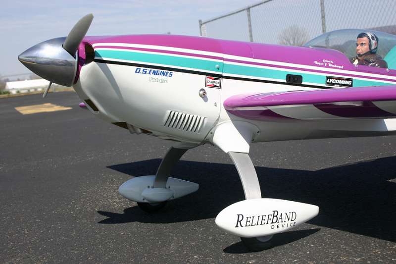

Watch assembling the wheel pants with the decorative coverings. The directions aren't very clear. I messed up the firsts set and had to reorder. Check to be sure you have the left and the right decorative coverings positioned accurately. There is a difference. I had to grind away the cowling a bit on the lower sides at the end of the cowling to clear the LG. You can see this in the Picture below.
