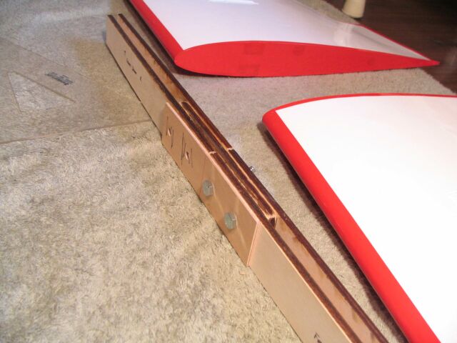

You're a bit head of me. I just finished getting the wing assembled. I did a trial fit of the engine, but still have to drill the holes in the mount.
Sanding out the channels for the wing joiners was a real b***h! And don't tell anyone, but I sanded a bit off of the joiners, too.

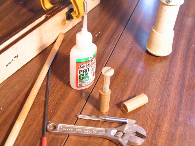

Pics below, don't really show anything, just like to post pics. One pic is the dowels for Gary's wing mod.

Looks like it's coming along nicely. It's hard to believe how many of you guys are doing the nylon bolt mod in the wing. Once you get passed the wings, the rest of it goes together like most other ARF's.
Make sure that you guys use tristock above and below the h-stab. The covering is already removed for that, I think. Also leave the tail fairing off until you balance it. That way, if you need to add weight, you can sit it right in front of the v-stab and then cover that area with the fairing.
