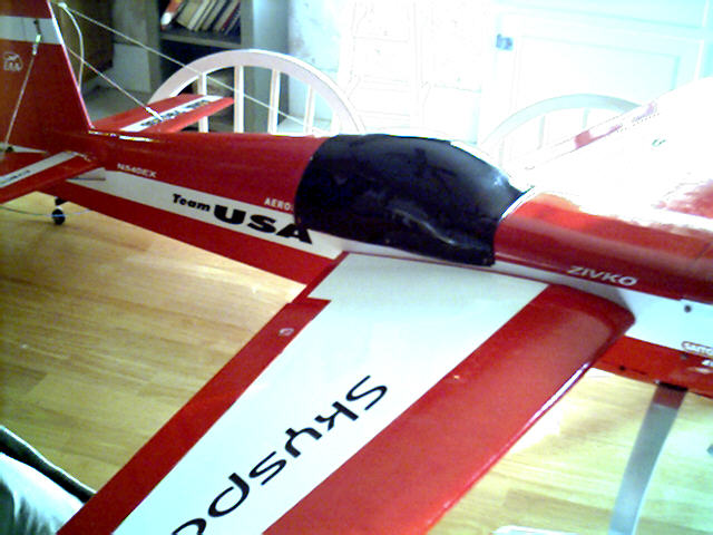

Well I just finished tinting my canopy this morning. Turned out pretty well. I put on a light coat of Black die on the inside, and then went over top of that with a light coat of LustreKote True Red. Gives the canopy a nice red tint when out in the sun. Looks rather neat in my opinion. Hard to see the red tint in the photos though, but it is there when you view the Plane in the right sunlight. I decided to tint the canopy instead of installing the pilot, because I may decide to add a couple extra ounces elsewhere like laminating the joiners with a 1/8" piece of Birch Ply just for a little added security. So it is kind of a weight trade off.

Nice looking canopy Ray. There is one more thing that I will probably do to the landing gear. I made a wire strut between the two legs to keep them from flattening out. I'm still thinking about this one, but I may use something like a fishing leader and tie the two legs together with that. I saw one of our club members do that to his profile planes to prevent the landing gear from flattening out. That is my only concern. They appear stiff enough, but like you, I would rather have a bit more security.
