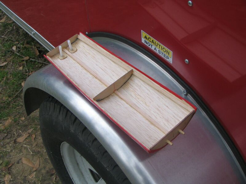

Looking at your belly pan.. Im kinda digging your mod. I can see how you mounted the rear half, what did you do to the front? Did you just epoxy some wooden dowels on the belly pan and put them through the holes in the front former? Can you post a pic of the bottom of your belly pan please so i can get exactly what you did.. I kinda think i may resort to your way of mounting the belly pan. Kinda ingenious idea.
For what you said i decided to order those wheel pants, and see if i can get those to work out. First i kinda need to fly my plane first. Nothing is working out. A big war between work and weather, and the latter is winning.

Grats on more successful flights, Jon. Your belly pan looks great. Is that the factory pan or did you make your own?

#781
Joined: Sep 2004
Posts: 657
From: Macon,
GA
Nathan,
>>Looking at your belly pan.. Im kinda digging your mod. I can see how you mounted the rear half, what did you do to the front? Did you just epoxy some wooden dowels on the belly pan and put them through the holes in the front former?<<
This is Gary's basic design and it came out ok for my first effort at scratch building anything, I'd like to try it again and see if I can get it to fit a little better - but it keeps goop out of radio compartment just fine.
Attached are pics showing the dowels and the crappy covering job I did. Note that the dowels are tapered to make insertion easier. If you make one, note that that the center former of belly pan has to clear the factory former that spans the opening when attaching the pan. Next time I'd put the belly pan former an inch or so in front of the factory former. Notches were cut in the factory former for the spars.

Jon, that belly pan looks great. For the center former, I removed it entirely and glued in a piece of 1/2" balsa square in it's place for structural rigidity. The main reason the former sticks out is to help shape the factory belly pan when it is mounted.
