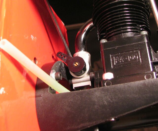

Didn't you have a Saito 100 mounted sideways on your plane? It looks like I'm going to have a problem routing the throttle linkage around the fuel tank.

Jon, I have used flexible control rods for the throttle on just about every plane I've built. I use the Sullivan Gold-n-Cable No. 508.

Luke has the Saito 120, and he had his mounted inverted. My Plane has the Saito 100, and it is mouted sideways. I had no trouble with the throttle, but I did mine differnt than alot of others. The Manual suggest that you relocate the throttle servo up near the tank and on the side. I mounted my throttle servo right inline with the Rudder and Elevator Servos. This allowed the linkage to come in at a little better angle, and then I just made two Z bends that make the linkage run over top of the wing joiner, and then back down to the servo. It was a pretty simple thing to do, and besides I just couldn't see not using that nice spot that is allready cut out for the throttle servo.

>>I have used flexible control rods for the throttle on just about every plane I've built. I use the Sullivan Gold-n-Cable No. 508.<<
I have some Gold-n-Cable No. 503. One of those things I bought but never used, guess it's time. I never could figure out what keeps it from bending in between supports, and my hands are too fat to secure in the rear part of a fuse. In this case, I can see using it because the distance from carb to servo is going to be only a few inches, but the distance from the throttle arm to the firewall is about 1/8 inch (pic). Do I just make a hole in the firewall large enough for the clevis to operate in? I don't see how its going to work without the sheath being bound to something.

Thanks, it's hard to remember who has what. Please see my pic in post# 573. Is this the way your throttle control is relative to the firewall? Looks to me like some z bends and a 90^ bend or two may be needed.
