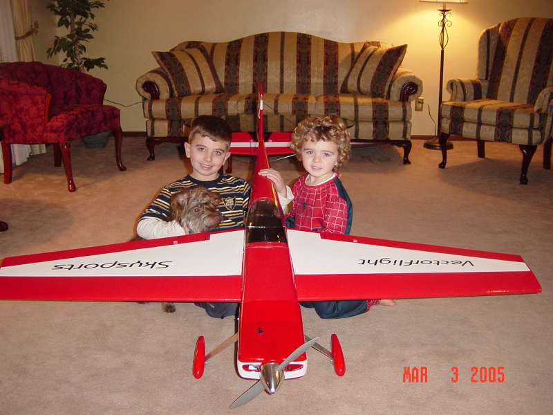

Hey guys, Almost finished with my Edge and it's looking great. I used VF's new bellypan mounting method and it seems to have worked well.
I do have a question on the Aileron control horns........Usually, I try to line up the control horn so that the holes for the clevis are over the hinge line of the control surface.....if I mount the control horns behind the wing servos, this won't work, because the aileron is on an angle. However, I could mount the horns further out on the control surface, and that way, I can mount them lined up with the front edge of the aileron. How did you guys do it?

glowplug, the angle of the control rod for the ailerons should be perpendicular to the hinge line. This will ensure equal travel in both up and down. This will also allow you to mount the control horns so that the pivot point is over the hinge line. I attached a pic of how mine looks. Any easy way to ensure that the angle is correct is to use a square and put on edge on the hinge line and the edge up to the servo arm. Then you can mark the location for the control horns. Hope this helps.

Hey Guys,
What is the optimal CG you have found for your Edges? Last night I completed and balanced mine and had to add 3 1/2 oz. of tail weight [:@] to balance just ahead of 4". Will this be a good CG point, or should I get it back to at least 4"?

Glowplug: Plane is looking good. Looks like you polished the landing gear too. I think it really makes the plane stand out. I bought an attachment to my bench grider for a polishing wheel. Though Id try it out to see if i can get the fine scratches that I could see. After using the steps of compounds.. WOW!!!! It looks like its just been chrome plated.

Thanks Nathan! Actually, I didn't polish the gear....it was pretty bright already....I think I'll do it though.
Miss America P-51....sweet [8D] A buddy of mine has the warbird scheme H9 P-51....he should be maidening it soon.

Thank you Ray! Yes, I'm pretty proud of them!
The Edge was a bit more labor intensive than some other ARF's that I have assembled, but it was never an unpleasant experience. I took my time on it and made sure everything was right. It was a very enjoyable ARF to build!
