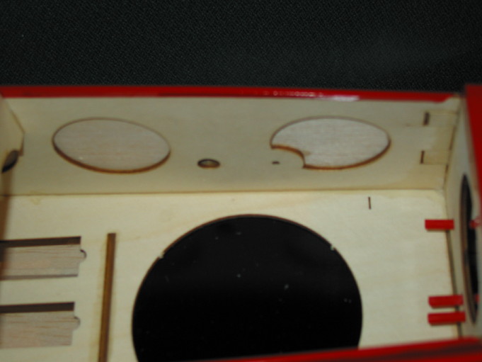

I was just looking at my fuse and noticed a couple of pre-drilled holes just behind the dowel hole...
did they already start adding a pilot hole for the nylon bolt mod or is this something else....
notice the hole behind the dowel hole.....

Mine came like that too . What I did was a bit easier than the others and seems to work fine.
I took two 1/4 nylon screws and cut the heads off . Then I tapped them into the wing so they would fit nice and snug. You may need to open the pre-drilled holes up a bit . Set the nylon screws about half way into the wing using 30 min epoxy. Before it cures make sure you dry fit the wings so the screws line up perfectly and will fit into the fuse during field assembly. I use two nylon wingnuts to hold them in place against the fuse sides.
The secret to this VF wing is to get the joiner bolts locked down tight first. Then just snug up the rear bolts enough to remove the gap. You don't need to crank them down with a socket wrench like you do the joiner.
The tapped dowel system is still probably the strongest of the two. But I have had no problems using the (nylon screws only) after 10 flights so far.

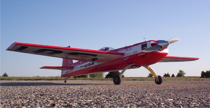

Having a great time with my Edge 540. Still no wheel pants. But I don't miss cleaning the dirt and grass outta them when I fly certain grass airfields. Saito100 is running great after I got it back from Horizon's Saito Repair.
New cam, bearings and seals.

Kurt: Your edge is looking beautiful. I think you did a great job with the cowl. Doesn't look like you put a hole on the bottom of the cowl for a heat excape. Seems like your saito runs fine.
I may contact VF for a new belly pan but, im going to see how my current belly pan works. Since, I wont be maidening my bird for a bit and lucky me being a manager at a hobby shop my edge is looking pretty hanging from the celing of the store. Ill take a picture if i remember to bring my camera to work.

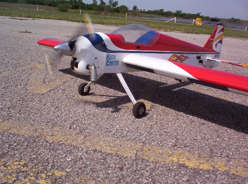

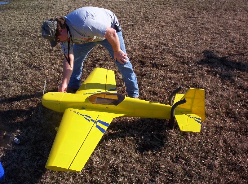

Plenty of air escapes through the underside of the cowl right in front of the gear mount.
A buddy of mine came over and did the cowl for me. He always does great work on his planes so I'm very thankful for his help.
He has shown me how to do them the right way several times but for this Edge and certain ARFs I ask him to do 'em.
Mine always have little flaws plus I'm a lunitic with a Dremal tool. LOL
TAKE SOME PHOTOS FURY !!! REMEMBER TO TAKE THAT CAMERA TOMORROW !!!
Here's a couple of my friends planes. Note the cowling placements. Nice work Billy !![8D]
