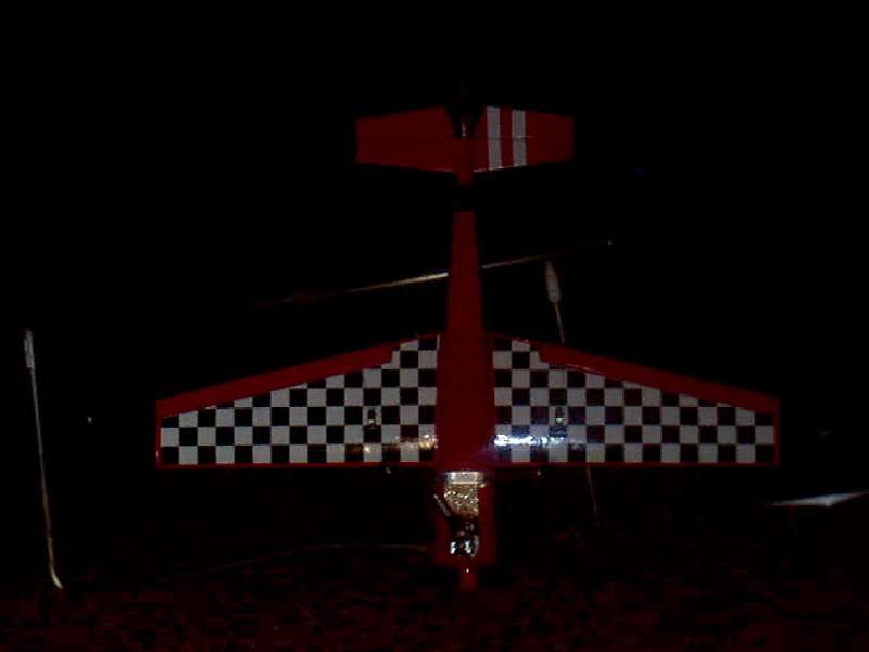

Actually I was just going to upload some pics of my edge. But thought id wait till i get the bottom of the wing done. Got some finishing touches to do. It is looking nice..
Ez2bgman: I almost did what you did to bring the TE back to the fuse side. Instead I elimated the dowel all together. I put to 1/4 x 20 threaded inserts in the holes where the dowel would be and instead used nylon wingbolts to hold it on. At the same time it pulled the gap back to the fuse.

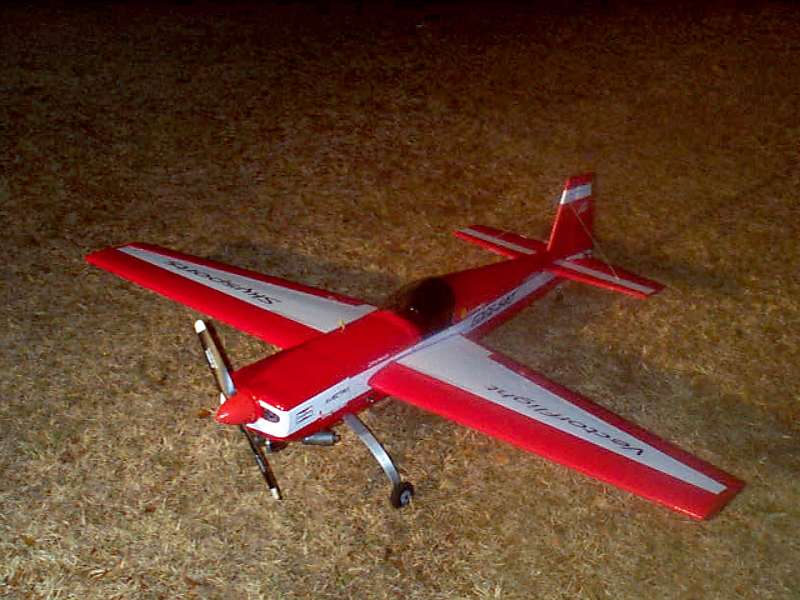

Nice checkerboard there Primodus. Where did you ever come up with such a clever idea????[sm=idea.gif] LOL
I ended up making another change to the wing/fuselage gap problem. I bought some 1/2" dowel, cut 2 inch long length, drilled it dead center, then tapped it for 1/4 x20 nylon bolts. I then marked everything and drilled the wing roots out to accept the 1/2" dowel and glued them in with wood glue. A few drops of thin CA to strengthen the threads and a fool proof method to secure each wing at the trailing edge.
I am now officially 100% flight ready. I had a few tid bits here and there to do. I installed a Great Planes rx switch. Finally installed the tail fairing. And finished installing the blind nuts for the belly pan. I am working on a different method to secure the belly pan in the near future. I put it on the normal way because I really want to fly this weekend.
Hopefully I will be able to get her out tomorrow and run the new Saito some more. If I get it outside, I will take some nice pics of the plane with some natural light.
Until next time........

Ez2bgman: As i said ill post pictures as soon i got the wing finished. The guys at D+D signs did a awsome job making the letters. Which in turn took me 2 hours in put on correctly. The plane is almost done. I need to tint the canopy, install the flying wires and install the rest of the electronics. Im waiting for my muffler from davis diesel so i can get my cowl cut out. I took the wheels off so i can put regular axles on the landing gear, which i pollished to a mirror shine.

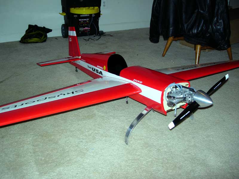

Posts: 310
From: Anytown,

Rcfury, the lettering on the wing looks awesome! As well as the polished landing gear! BTW Are you going to recover the firewall or use something else to fuelproof? [8D]

rcfury,
Great looking plane. Couple of questions.
You mounted your Saito sideways, where Gary mounted his inverted. Is yours also a 120? Will your cowl fit over the Saito without cut-outs?

Thank you for all the kind remarks...
Well the stripping of the covering on the firewall was a mistake. i got a little xacto knife crazy and cut the covering.. I did thin out epoxy and fuel proofed it further.
I have the saito 100 in my plane. Another guy at our club had the 66" extra and used the saito 100 and it preformed amazing. So i stuck with the 1.00. I mounted it sideways because i didn't want to redrill holes in the firewall. Feeling kinda lazy. And since the saito 100 is a smaller engine than the motor i didn't have to hack up the cowl all that much. The valve covers only stick out the side of the cowl maybe less than a .25 inch.
Jon: Put on a pair of messed up hole in the knees jeans with one of your stretched out shirt and follow me, its a messy job. Go to your local homedepot and pick up some wet or dry sandpaper, grits 250 all the way up to 1000 (if you can find it, 600 will do). Start wetsanding the landing gear starting with 250. You want to get rid of the grain in the aluminum. keep on going to a finer grit sandpaper going the opposite direction as the previous. Make sure you keep the sandpaper wet or the aluminum will start to load up. by the time you get to the 600 grit it will start to look almost a satin color, and you will begin to see a little shine. When you done sanding get some mothers aluminum polish and start buffing. keep on polishing until no more black residue appears. the more time you take sanding the better it will look. Once you add the polish, scratches will be magnified looking kinda ugly. It took me nearly 2-3 hours doing the landing gear.. Then you want to spray it with some clearcoat or some car wax works pretty good to keep it from oxidizing.
