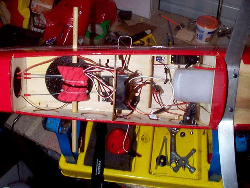

The blue tubing is fuel tubing for the pick-up line on my fuel tank. I haven't installed the fuel tank yet and have the excess tubing laying there for the fuel tank. Once I install the tank, I will be cutting it down to size (of course).
Until the next update....

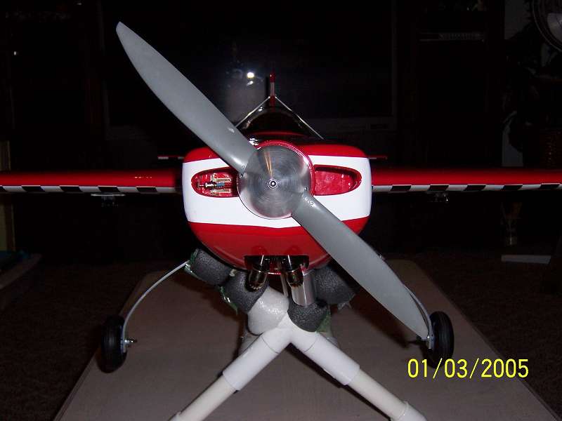

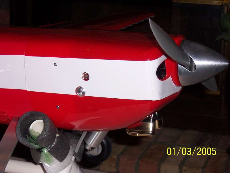

Here's the update and pics as I promised...
She is all done with the exception of final balancing with the rx/batt. and rechecking all the throws.
I cut and installed the cowl and canopy and installed the belly pan. I am waiting to install the tail fairing until after I balance her. That way if I have to add weight I can add it to the tail area under the fairing.
The cowl was kinda fun to do (NOT !!). The Saito is so large that it took about two hours to do the cowl. I had to keep refitting it and then trimming, etc., etc. As you can see, I have two fairly large holes on the plane's right side of the cowl. The upper hole is a for a recessed remote glow driver. The lower hole is for the Slimline remote fuel filler. I really like the Slimline unit. It has no valves to go bad, just 3 o-rings that need replacing if any problems develop. Very simple and robust. As I stated in an earlier post, the remote glow unit is actually designed for helicopters. In the original configuration that I had it, the remote glow would have been sticking out the cowl. I desoldered the leads and flipped the mounting bracket so that it would mount flush. Now it is a much cleaner install.
The canopy was a bit of a pain to do as well. After several trail fits and trimmings, I finally got it where I wanted it. I started at first to mount it with the screws, but I wanted a cleaner appearance. So I used some canopy glue and some of the excess red and white to trim the canopy. The end result appears that the canopy is just sitting on the plane. Very clean.
I have 8 more pics, so here are the first four.
Thanks again for everyone's help and follow up on this thread as I will be doing an indepth flight report.

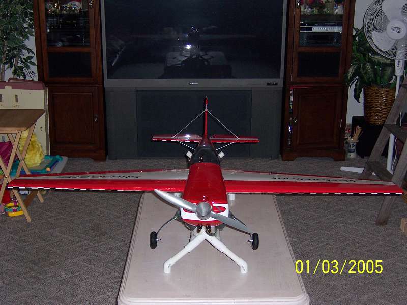

Here are the last four pics.
You can see how well the checkboard came out. It took considerable time to do it, but the end results are truly amazing. I wouldn't hesitate to do it again if I had to do it over. It adds tremendously to the overall visibility as well.
I changed the method in which I started the checkerboarding too. At first, I actually painstakingly cut all the red covering off the bottom of the right aileron and then recovered it with the checkerboard. After a couple of e-mails to VF, Chuck informed me that I could apply the iron-on covering directly over the existing vinyl covering, as long as the iron wasn't too hot and didn't contact the vinyl covering alone. This worked very well over the rest of the surfaces that I did. I kept the heat to a medium/medium-high setting and did not keep the iron in any one place for too long. Be very careful when doing the wing. Too much heat could distort the foam underneath. I know from first hand experience. Luckily I caught it quickly and was able to smooth the area out.
If there are any questions or specific pics of the Edge that anyone would like to see, please drop me a PM or post here on this thread. I will try to help in any way that I can.
Until next time, good luck and happy flying.

Gary, those checkers look hot and should be a great orientation cue! If I ever go with my surpass 1.20 its going to be inverted. Cant believe there's a 1.20 Saito GK well concealed in there and the cowl sides are clean! Its gonna be a blast to fly!!! Thanks for a super review. Good idea to leave the wheel pants off for now till the landings are perfected.

Thanks for the compliments on the plane. It took me 6 days from start to finish. I put considerable more time than the 10-20 hours for your average ARF. I always end up customizing my ARF's in some fashion. I guess it is a sort of signature to distinguish my plane from the others
Our field is a very bumpy grass field and loves to eat wheel pants for breakfast and lunch. I went through 2 sets of wheel pants on my H9 Aresti 40 in only 3 weeks. Now I just leave them off. I need to make a set of wheel pants out of Kevlar. Since Kevlar can withstand bullet strikes, maybe it can take some landings on a rough grass field [sm=idea.gif].
If you decide to usae your 120 Surpass inverted, take the extra time to ensure a perfectly level mount. I read several threads here on RCU where different modelers mounted their engine inverted, but only had to redrill 2 new holes in the firewall. I took the extra time to align the mount level with the fuselage and ended up having to redrill 3 holes, but I think the extra effort paid off in the end. Here is the method I used: I used 2 levels, one laying across the fuselage where the belly pan mounts and the other rubber banded onto the mount itself. Once I ensured the fuselage was level, I screwed in the mount and aligned it with the level. Then I marked the new holes. Popped out the the blind nuts, redrilled and reinstalled the blind nuts. I also filled in the old holes.
Good luck with your Surpass 120 and happy flying.

Balancing tip: With a Saito 120 on the nose, a hatch should be cut to allow placing the battery as far back in the tail as possible. I use a 5cell 6.0V battery and get a perfect balance with no additional wieght. A 4cell 4.8V in the same place makes it hair nose heavy. The RX can safely be attached to the trailing edge wing dowel. See pic below. I have since made it a little neater, but the basic placement is the same. Note the battery lead going into the fuse toward the tail.

I made a hatch in the rear of the fuselage too. I am using a 4 cell 4.8v 1000 mah batt. pack. It was still a tad nose heavy and I added a few ounces to the tail group, just in front of the v-stab, under the tail fairing. Now it balances right at the recommended 4 inches from the leading edge. I also made the mount for the batt. so that I can shift the batt. a little fore or aft to change the CG as needed.
I mounted the rx in the area intended for the throttle servo. Since I mounted the throttle servo up front near the firewall, the stock throttle mount was the perfect area to mount the rx.
All I have to do now is get an rx switch and mount it and she will be 100% flight ready.
