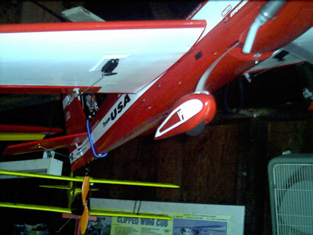

suitcase,
The control horns have to be perpindicular to the aileron, not the servo. It doesn't matter what type of horn you are using.
If you look at the control wires on the servos they don't travel down the sides of the servos, but at an angle. I think you're going to have to redo your control horns.
I don't have a close up shot of the bottom of my wings, but if you look at this pic closely you'll see the wires are angles off the servo.

You've probably re-hinged it by now. But .......another pic or two. First pic is mine when I was first building it and the one hanging belongs to ckangaroo70 I believe.
Have had few problems with mine so far except the wings are getting quite loose from normal flying and have to be shimmed during assembly everytime. And I tried to fly it the other day during high wind conditions (18 to 20mph) and it would duck and dart around because of wind sheer. It will handle 10 to 15mph winds and that's about as windy as I care to fly in anyway.
Need a new cowling. Mine has melted in areas from the Saito-100's heat. I have cut larger holes and directed the exhaust out the side now. Before I had it neatly tucked inside the cowl using an extention out the bottom.

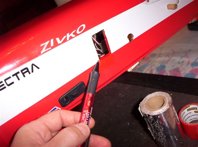

I came up with an easy and quick fix for any joiner slop in the fuse . I used two small squares of metallic tape on the bottom of the joiner slots in the fuse. Then I took some red vinyl tape and covered it. Was just a tad bit harder to insert the wings the first time,,but the gap was gone. I usually never noticed the slop till after the first flight. I always check it before each flight along with the other usual items we all look over before takeoff. This seems to fix the wear problem and is cheap and clean. No epoxy. No CA. Painless.
I also included a pic of my bruised wingtip. I have written VF asking if there is a way to repair it. Doesn't seem to impair flight. Thought maybe one of you might have an easy fix for getting a wrinkle out.

I received this from VF and it worked quite well. I used an old tee shirt and a sock on my iron.
"However there is a very good fix for the dents and they can be fixed almost to perfection! The way to do it is as follows.
Place a soft cotton cloth over the dented area and apply a hot iron gently right over the dent, giving it localized heat. Start with a low temperature and proceed to increase temperature slowly. At some point when enough heat is transferred into the dented foam, the foam will expand and push the dent out. Stop heating immediately when this happens and rub smooth with a soft cloth. Do not touch the hot iron directly to the red covering as it may melt or get deformed, this is why some tempering of the heat is required by placing a soft cotton cloth between the iron and the wing. Once the dents pop out, leave the wing in the hot sun for 3-4 hours, to help dry the glue which might still be damp inside the wing skin. These airplanes are being shipped immediately and often the aliphatic glue used to glue the wing skin to the foam core is not cured for some time. It does not affect the overall strength, but basically renders the skin soft and susceptible to local dents. Once all the moisture inside the wing is gone, it will be lighter and have a harder skin."
