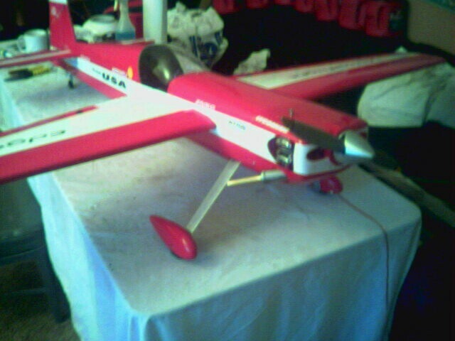

Going to fly mine tomorrow at last. Been quite a spell since I did the major overhaul . I'm hoping the new hi-torque servos and mass weight reduction cures the small problems I had before. All hinge gaps are now sealed as well.
For those that didn't read back a ways and see where I posted about a diet plan for the VF Edge I'll briefly hit on a few things I did.
Starting at the DuBro nylon gear,,, I carefully shaved and narrowed the heavy landing gear in areas that wouldn't be effected by stress. The gear is the best for soaking up hot landings but heavy. I reduced the weight by 4-1/2 oz.
Next I removed the pilot, fuel tank shelf, throttle servo tray and the heavy rubber tires. I replaced the tank shelf I had made with light foam that keeps it in place just as good at half the weight or less. Built a lighter servo tray for the throttle. Removed the rudder servo and the heavy fuse length rod and installed it in the tail section. I also sanded everything I could but would still be strong like before. Total weight reduced RTF....one pound 6 ounces. Which puts the total weight at 7 pounds even, dry.
All this will most likely make landings and everything else much easier and allow the engine to work at a lower rpm to achieve the same results. I predict the stall speed will decrease by 5 mph.
