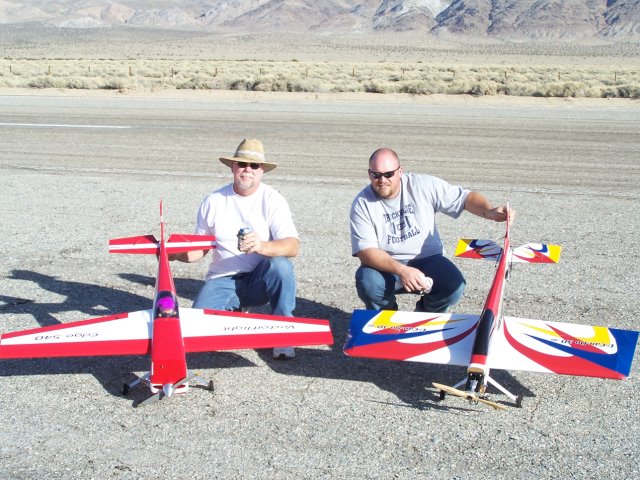

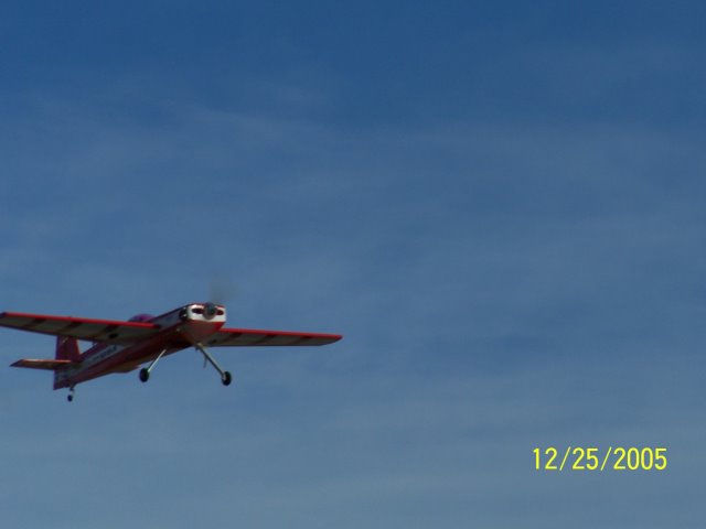

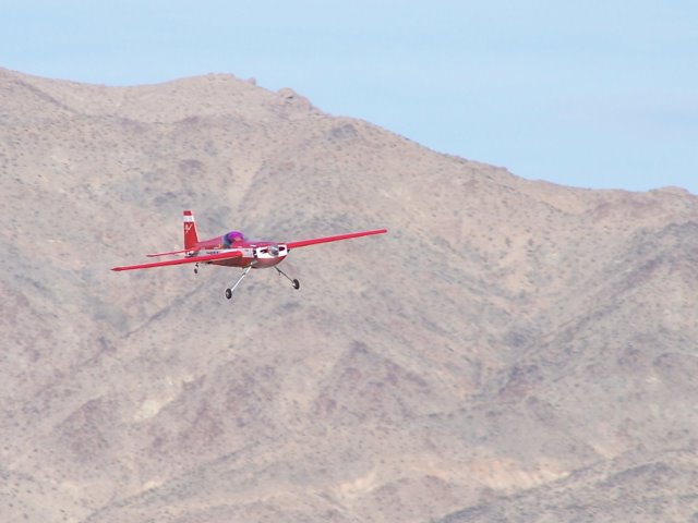

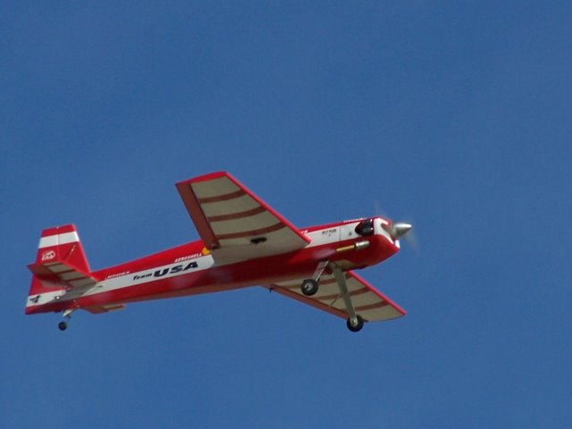

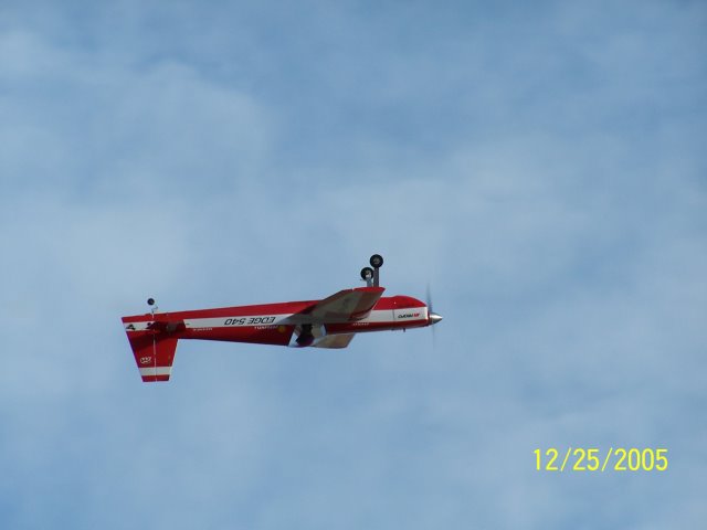

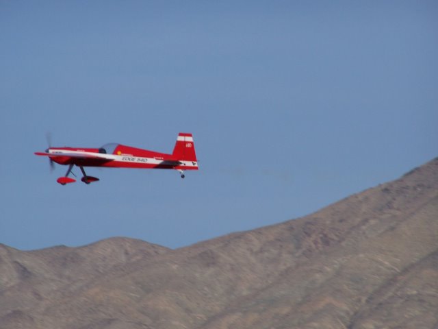

hey guys, everything is great with my edge, just sealed the surfaces and man did that make a BIG difference!!
here are some christmas day pics with my son[8D]

Very excellent flying shots. My compliments to your photographer. I had really not considered doing the horizontal stripes on the wing bottoms since to top of the Edge wing is so distinctive to me in the air from the bottom. But on seeing yours in the air, not I may have to.
thanks,
bob branch
Harsens Island, Michigan
ps. where's your winter coat? You need thermal wear, down coat, wool hat, and mittens with ends that flop open to expose the ends of you fingers to fly in the winter, even on days when there is no snow.
